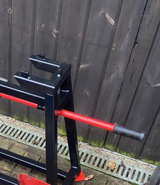

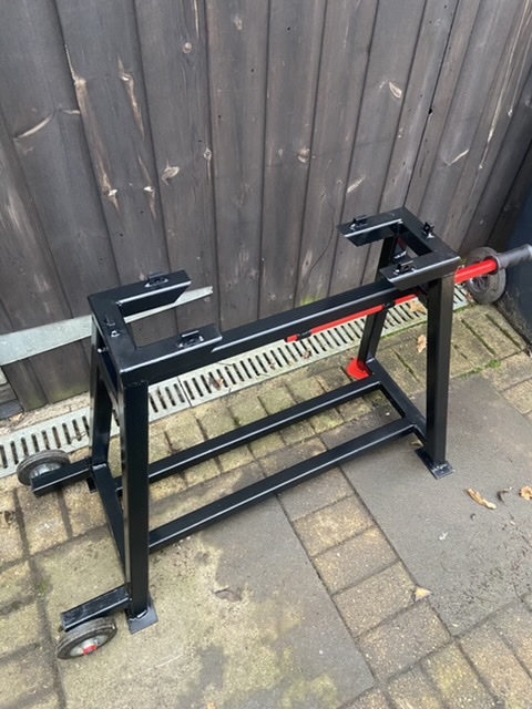

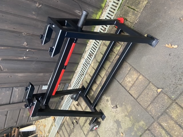

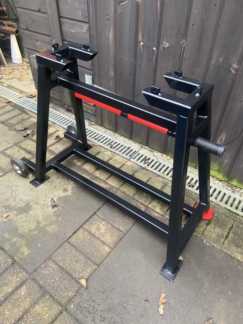

    Been awhile since I last posted so hope to start posting some of the projects I have been working on that I hope will be of interest.
    After 35 years of owning this saw from new it is getting a long needed overhaul.
    First job is to replace the flimsy sheet metal base and wheel assembly. I can’t take credit for the design. The design was found on YouTube by Budget Phil link to his excellent video
    l have changed a few items to suit my needs. I have changed the angle on the legs and made it slightly higher. The lower rails have been set to accept a coolant tank I have. The wheel diameter is also smaller as I had these laying around in the shop.
    I plan on improving the loose and fixed jaw, add coolant system, drip/swarf tray, hydraulic feed system and rewire. As I complete these I will post on HMT

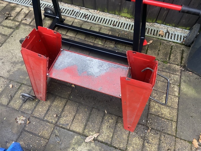

    New base for 4x6 bandsaw-7b1bc23a-f4cf-4763-acce-a3439f2ccb2e.jpegPhoto of standard flimsy sheet metal base
    New base for 4x6 bandsaw-d968b507-b17d-420b-abc4-f1b2ef31e97a.jpeg New base for 4x6 bandsaw-794ad3cd-a62c-4b67-aeda-f83e6aa89267.jpeg New stand made from 40mm x 3mm box section (had this left over from another project)
    New base for 4x6 bandsaw-d8766bf8-dda1-4734-bf54-0c85d7f5c3d4.jpeg Handle slides out to aid moving the saw around the shop

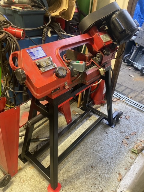

    New base for 4x6 bandsaw-4089a066-54a2-49c3-b9c7-ad17c8898563.jpegSaw in place waiting to be permanently bolted to new stand.
