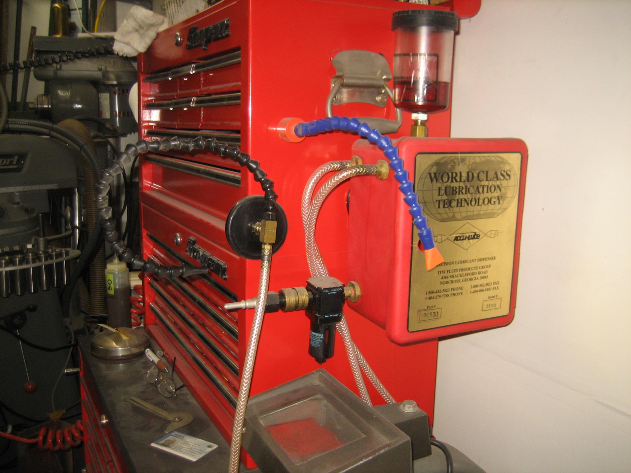

    Metalmuncher, here's what I use when I need a cutting oil flow on either the mill or a lathe. This unit has magnets on the back of the control box so it will stick anywhere. I usually just leave it stuck on the side of this tool chest which sits between my 10EE and the mill. There are 2 nozzle ends on long hoses which also have big magnets that will stick close to the cutter. It uses low air pressure and small ball valves to provide a controllable positive flow where needed. You just keep the reservoir on top filled with cutting oil. I don't use it often as it makes a mess, especially if doing a long job. Bill

    Thanks for all the interesting suggestions!
    What I am aiming for here is a lazy way to replace the coolant application on my mill and lathe that has served me will since the turn of this century.........dripping it on with a small nozzle bottle, a little at a time, repeatedly, as needed. That way I don't have a pool to deal with, no need for compressed air or a pump, and no need for any kind of coolant recovery system. Most of the coolant/cutting oil ends up on the chips, which, once I am sure they are cool, get vacuumed away with my shop vac.
    What this device I assembled does for me is allow me to have the drops of oil I would be stopping and applying manually to be automatically applied, at any rate I choose. This sight drip oiler has a wide range of adjustment, from very slow (several seconds per drop) through nearly a steady stream, and is very consistant at any setting, even after it loads the tube I am using with oil. However, that tube is not very position-able, as it was designed for an oil can. I've learned the type of jointed tube I mentioned initially (and visible in Nightshift's posted photo above) is sold under the product name Loc-Line, and Amazon carries it in several ways. I have ordered a "kit" of it with fittings, as well as a pliers tool for assembling/disassembling the custom lengths desired, and intend to use that instead of the current oil can tube I have in place.
