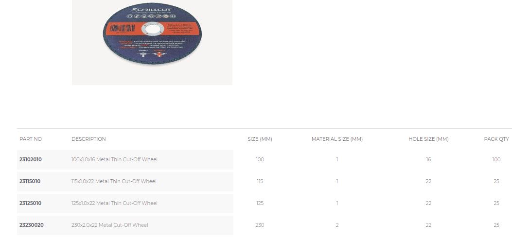

    Thanks Bill,
    My bad! I have obviously forgotten how to get my head around imperial measurements. What I was referring to as 4.5" I was thinking of 4". The small dinky ones I've used have mostly been 4" but I've mentally lumped 4.5" into the same category as 4" in that they're not worth my time.
    My grinder is actually a 5" jobbie, but it also takes 4.5' discs if I'm desperate. That said 5" consumables are pretty common here, but I tend to do my shopping at industrial supply places, not the big box stores.
