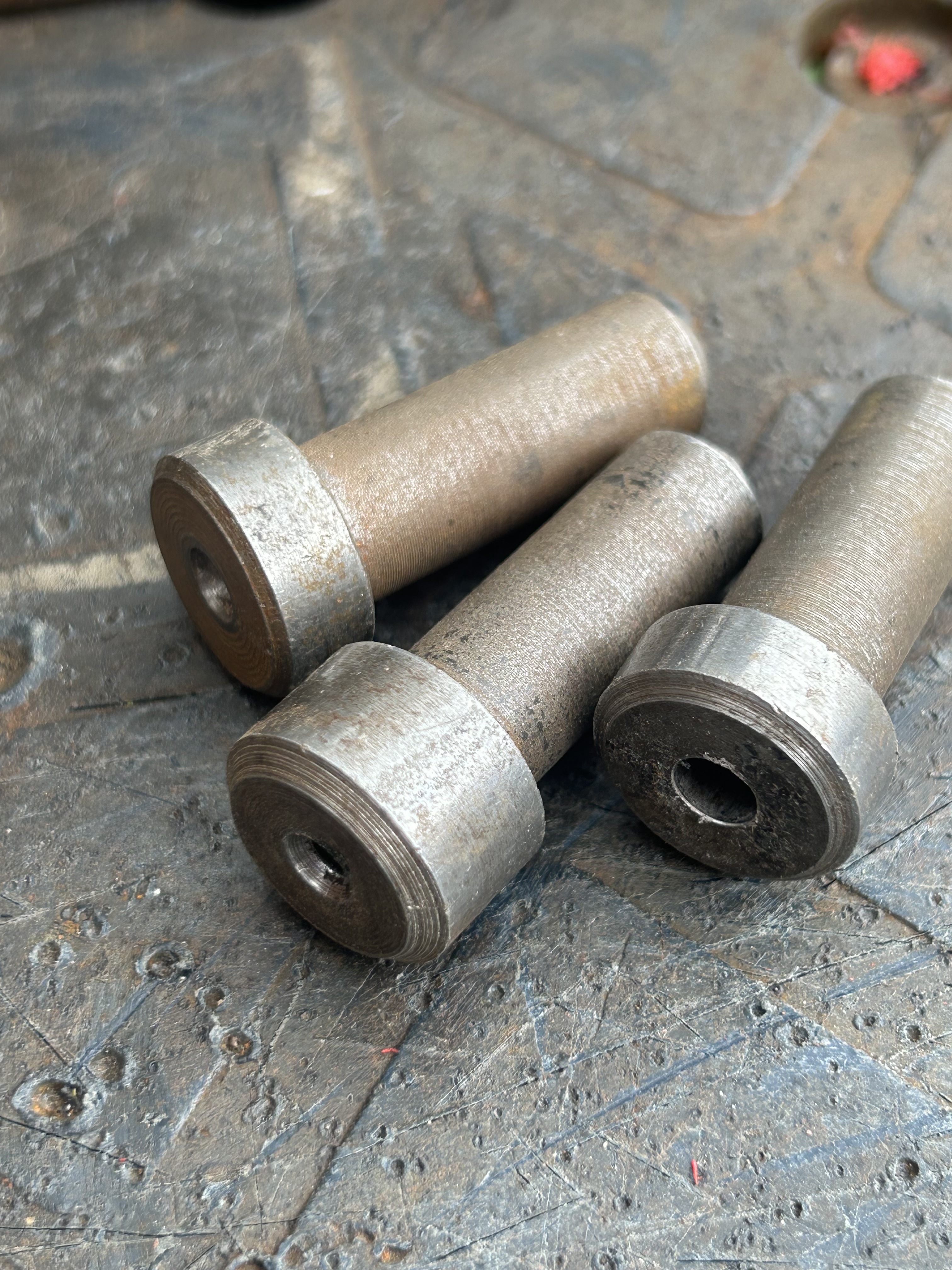

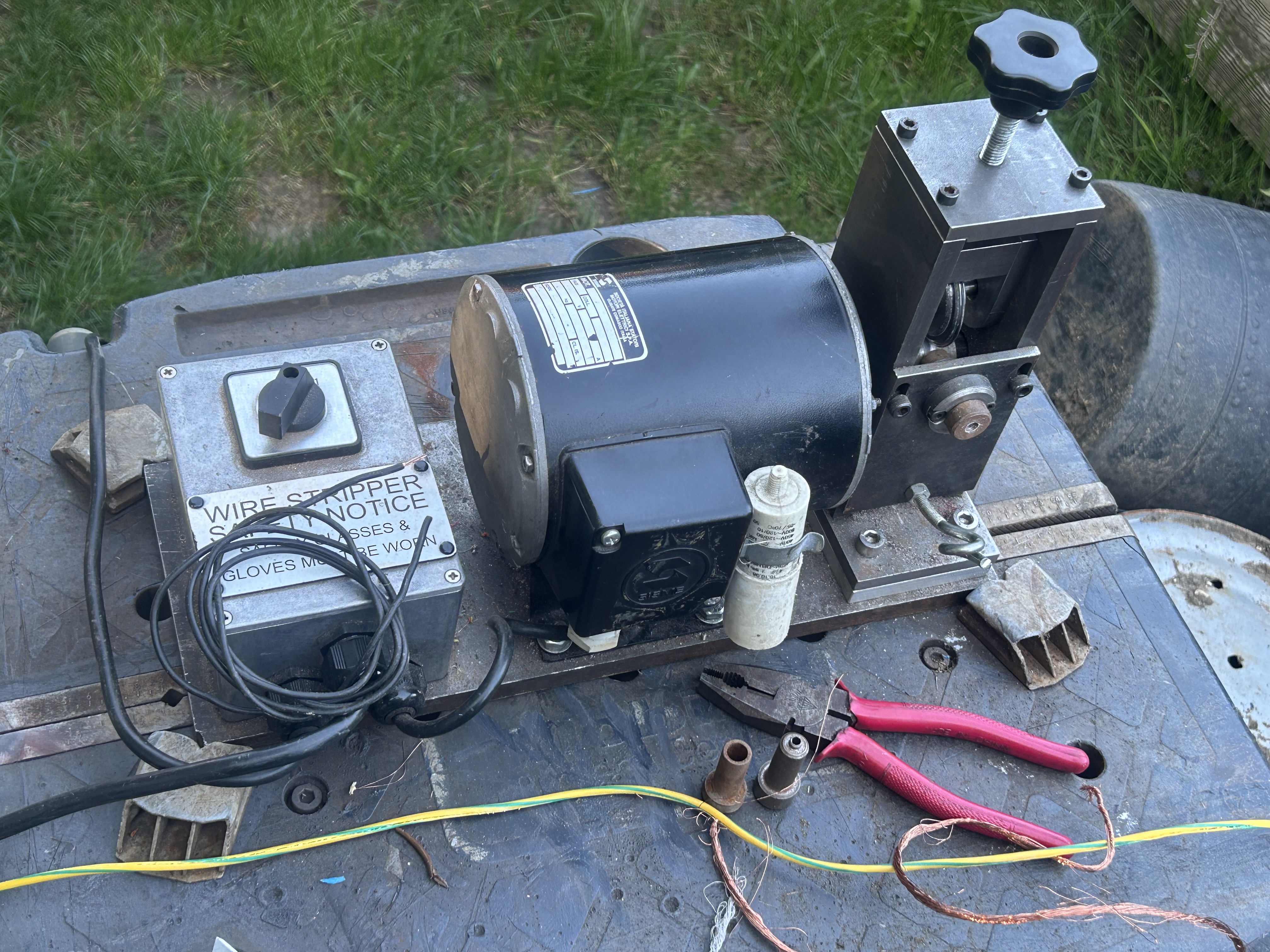

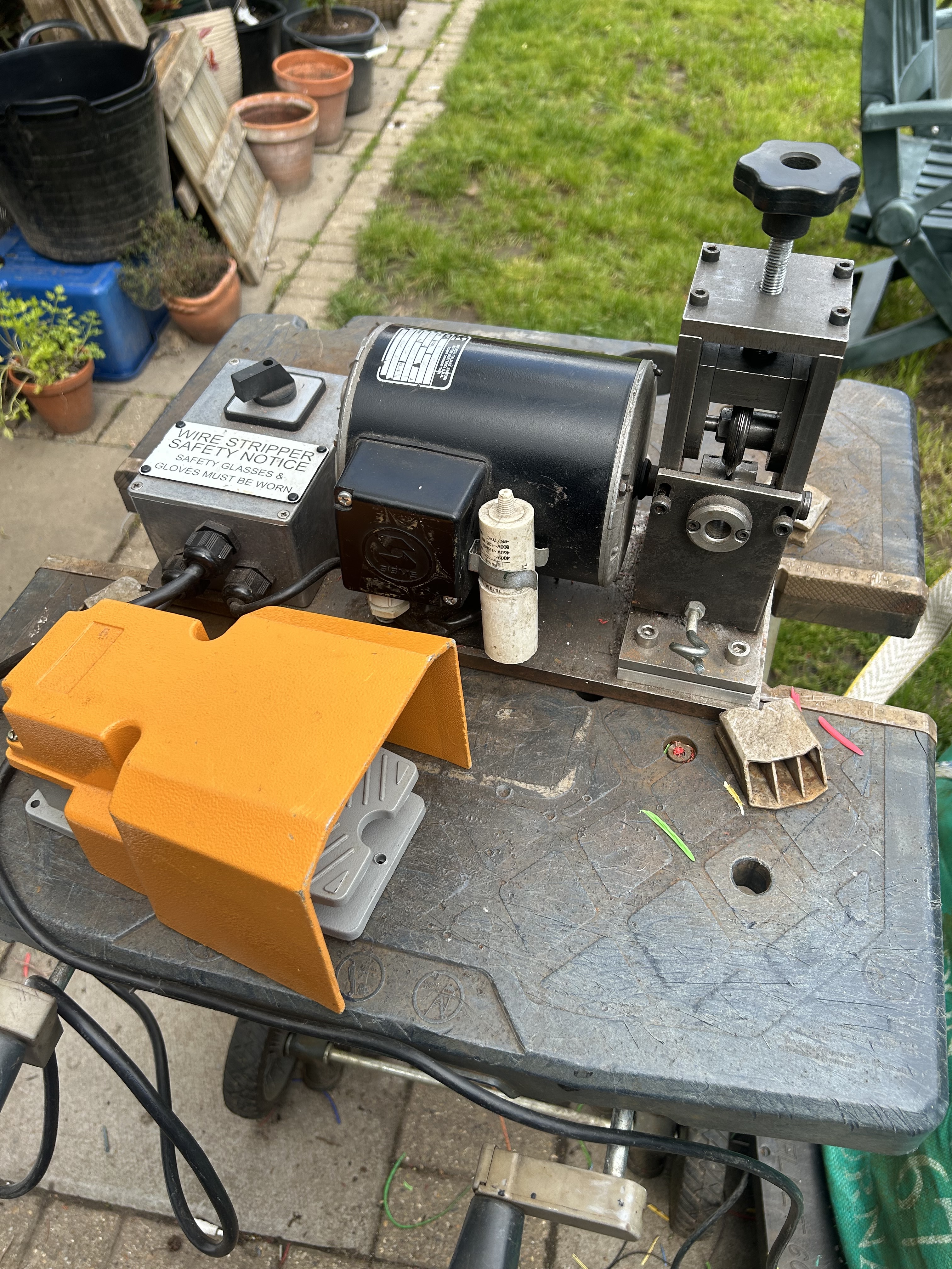

    Have a lot of cable so decided to make a cable stripper machine to maximise the current copper scrap value.

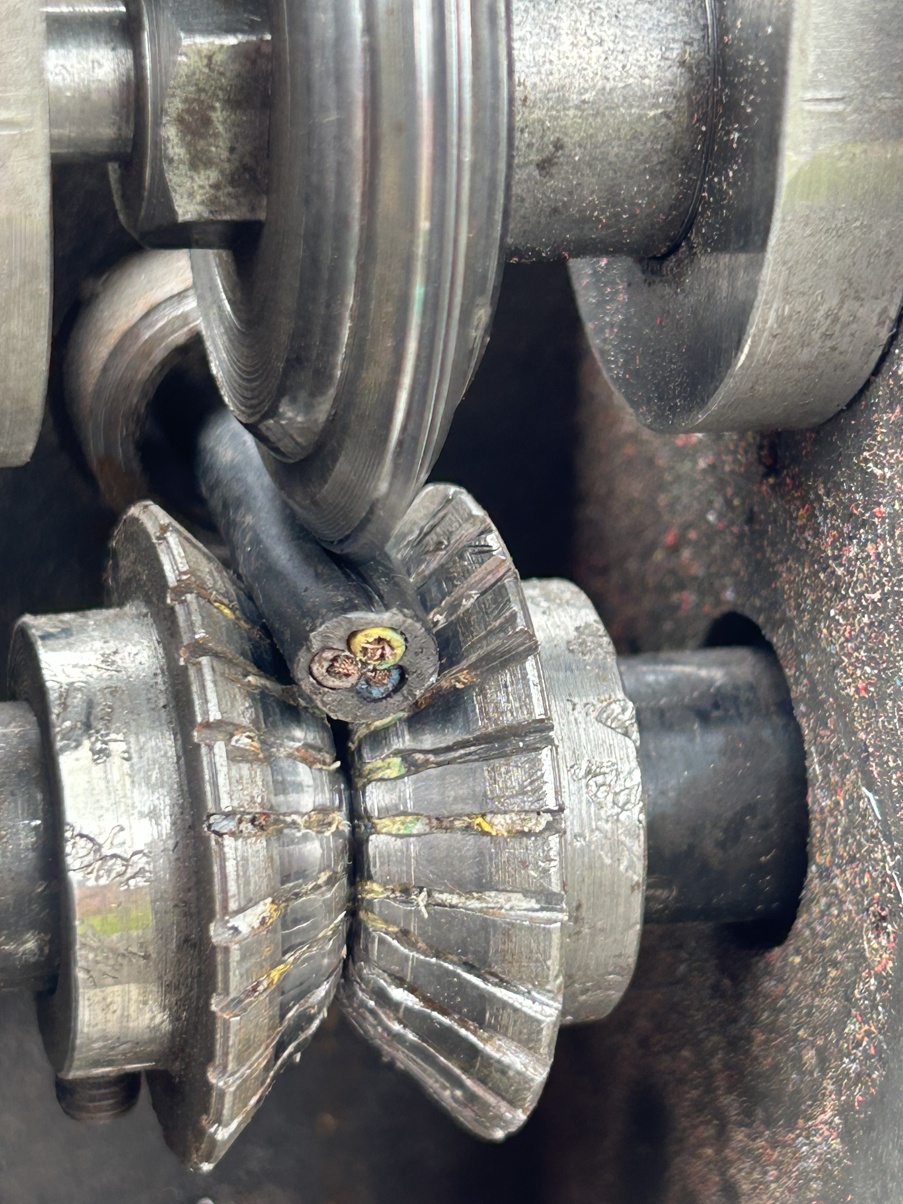

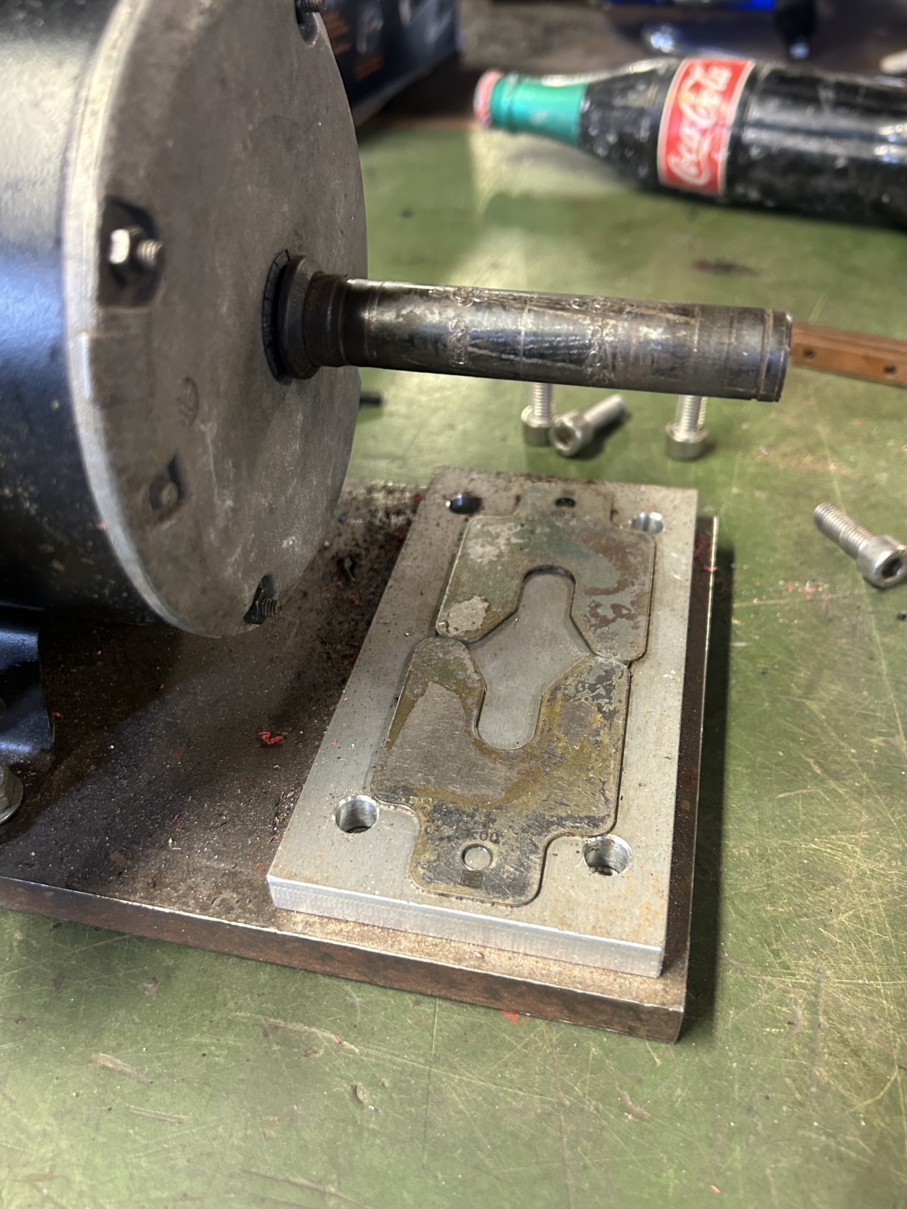

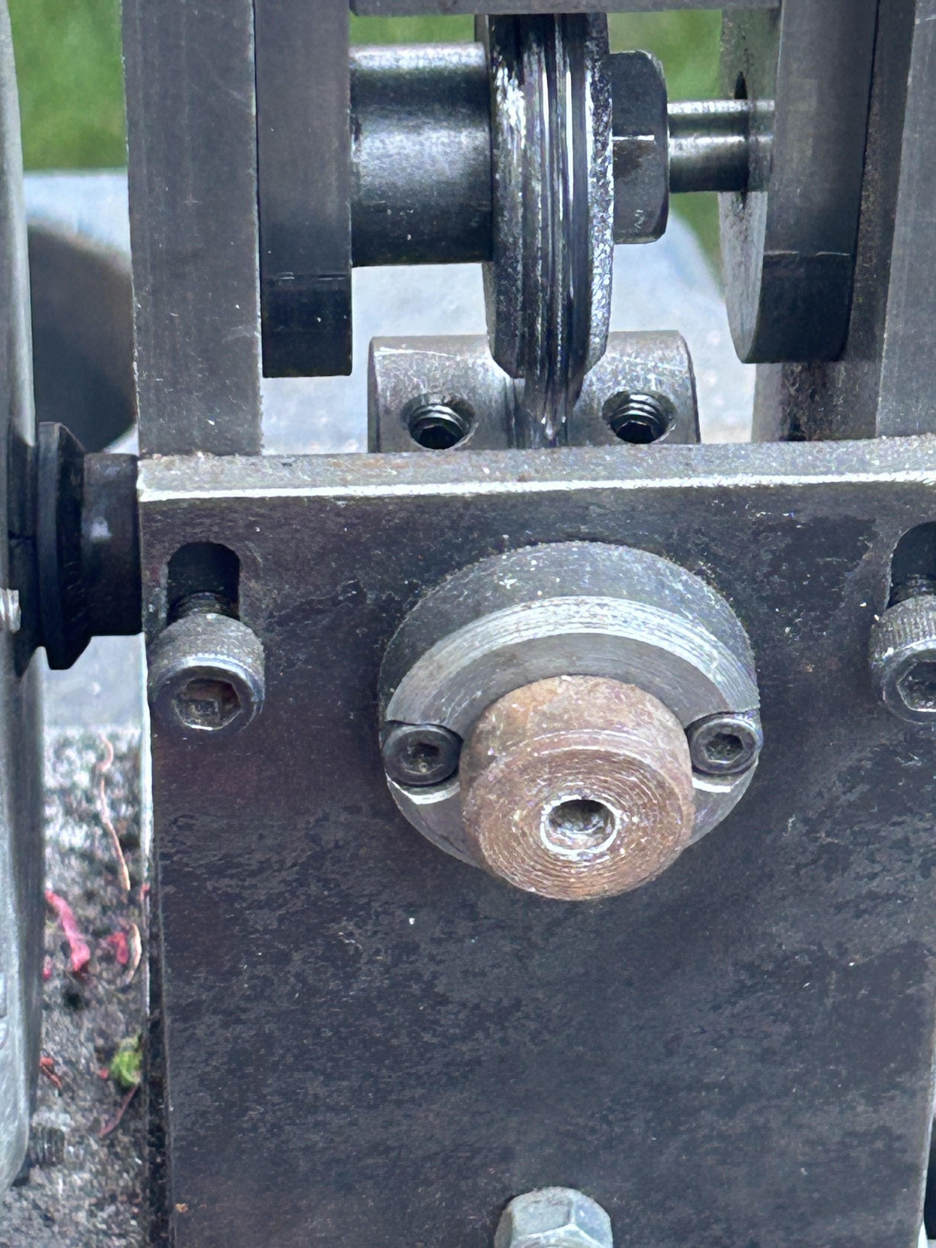

    The machine was designed around the motor I had lying around, as the output shaft was a decent length to support on two bearings and fix a vee groove driver. The body of the machine was cobbled together and the cutting blade made from gauge plate and hardened and tempered.

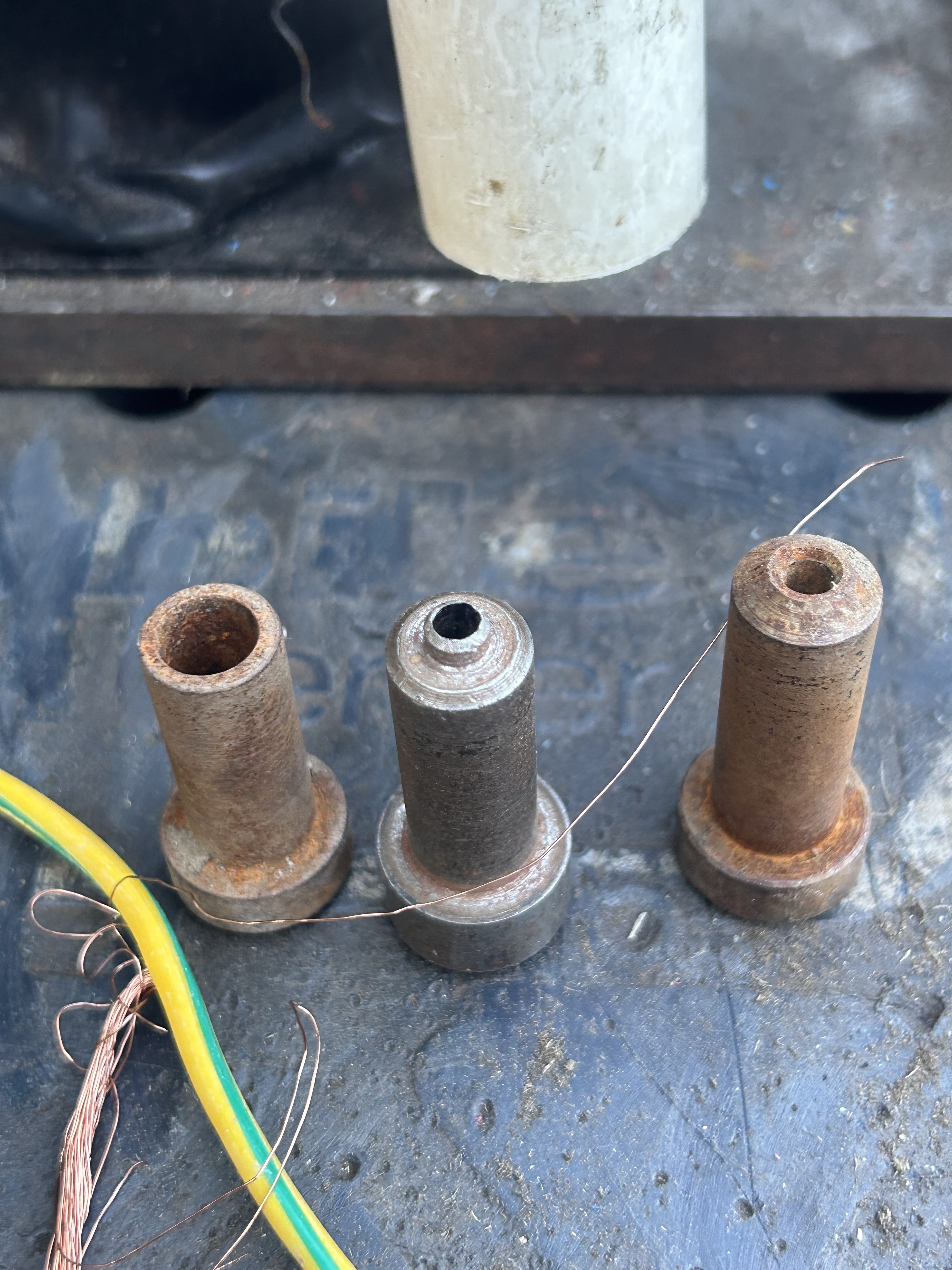

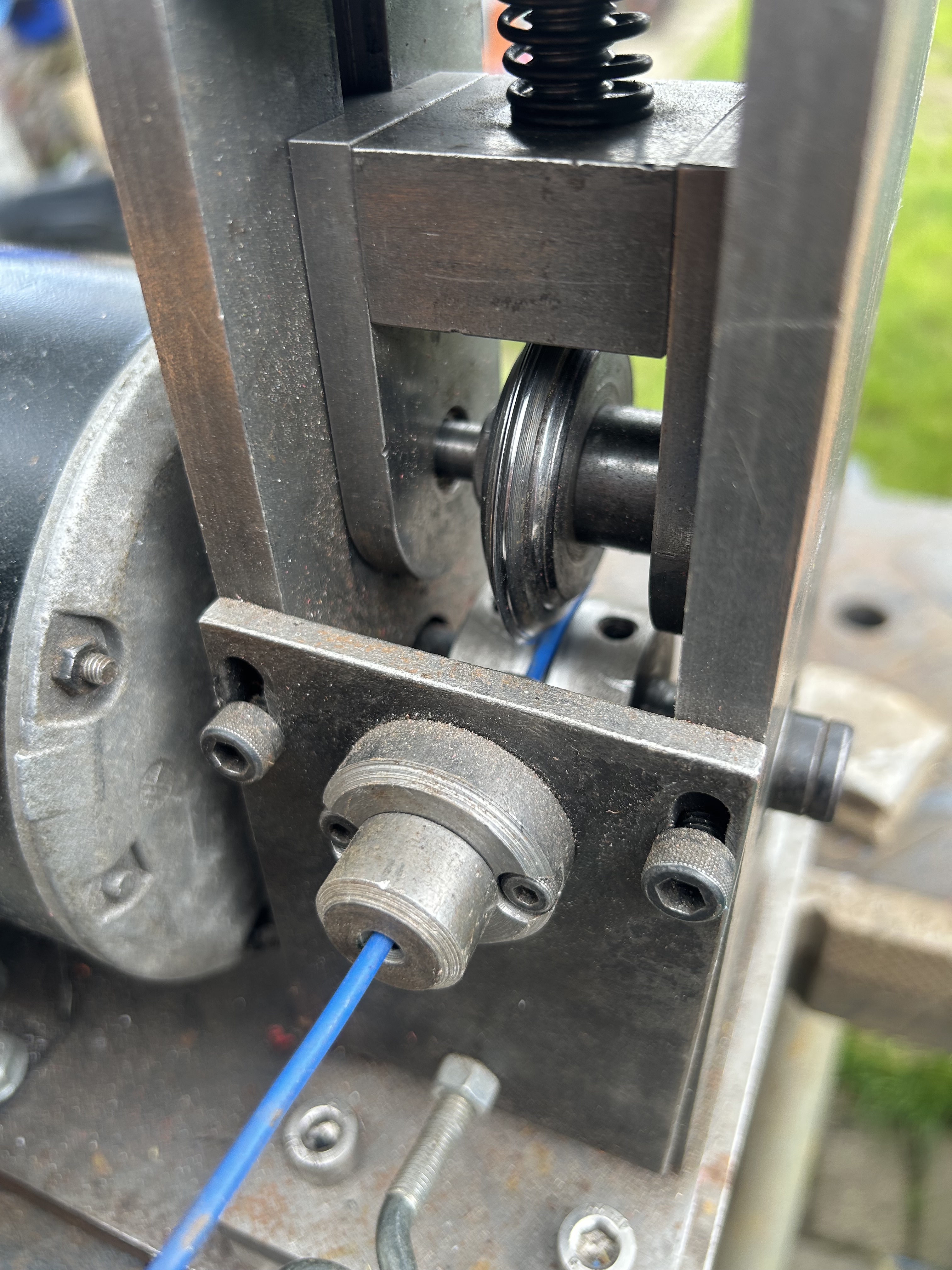

    To enable smaller gauge wire to be stripped a few collets were made to align the wire as close to the cutter and central to the drive vee so it couldn’t wonder away
    To cut large cable the vee drive can be swapped out for a larger vee drive.

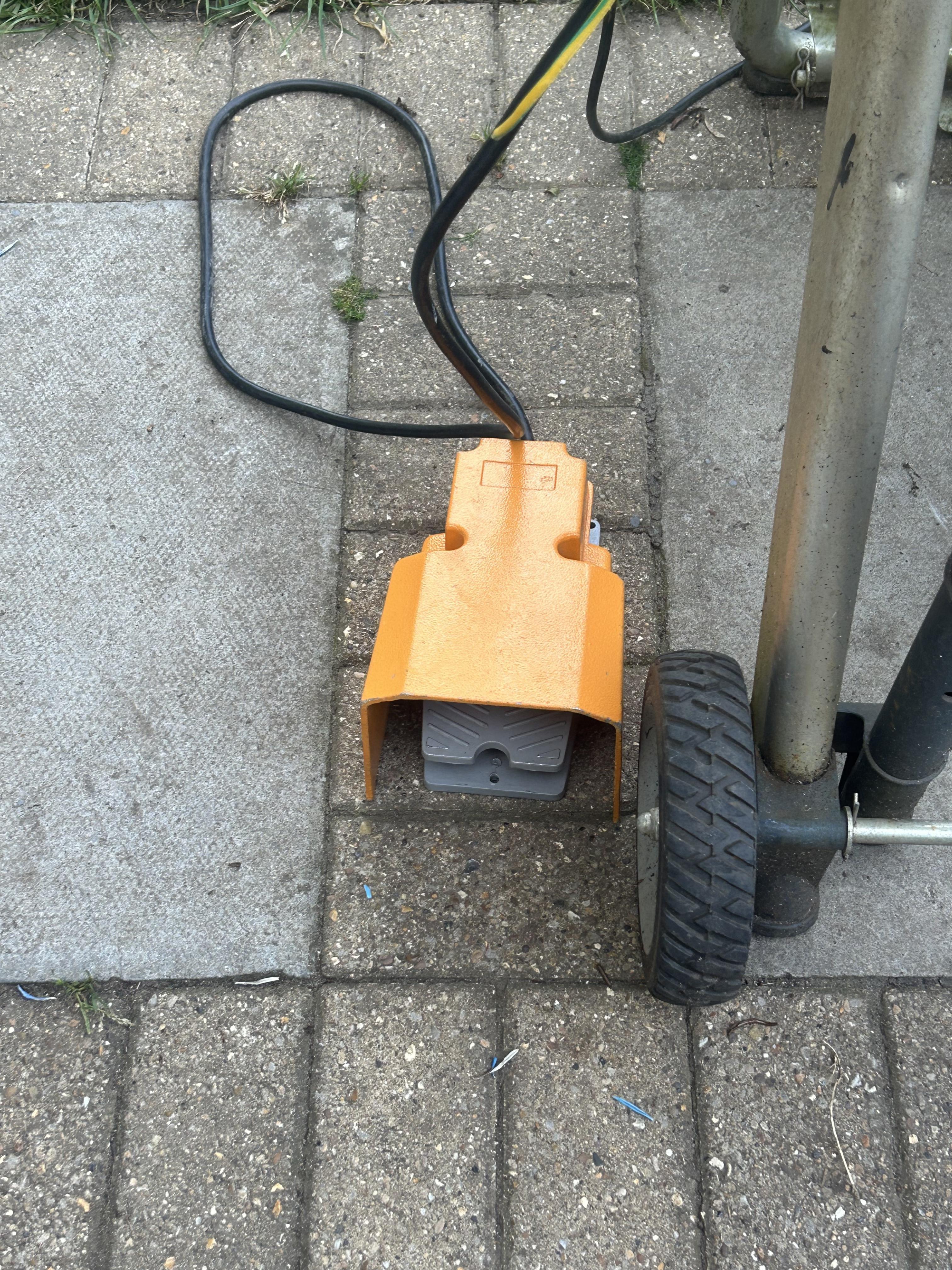

    The machine is operated via a foot pedal so the machine is not constantly running.

    Need some money so became a stripper!-img_8242.jpegMotor on base plate and shims to get the cutting assembly to the correct height.
    Need some money so became a stripper!-img_8549.jpeg Need some money so became a stripper!-img_8548.jpg Need some money so became a stripper!-img_8236.jpeg Complete machine.
    Need some money so became a stripper!-img_8550.jpeg Need some money so became a stripper!-img_8237.jpegCollets for different diameter cables.

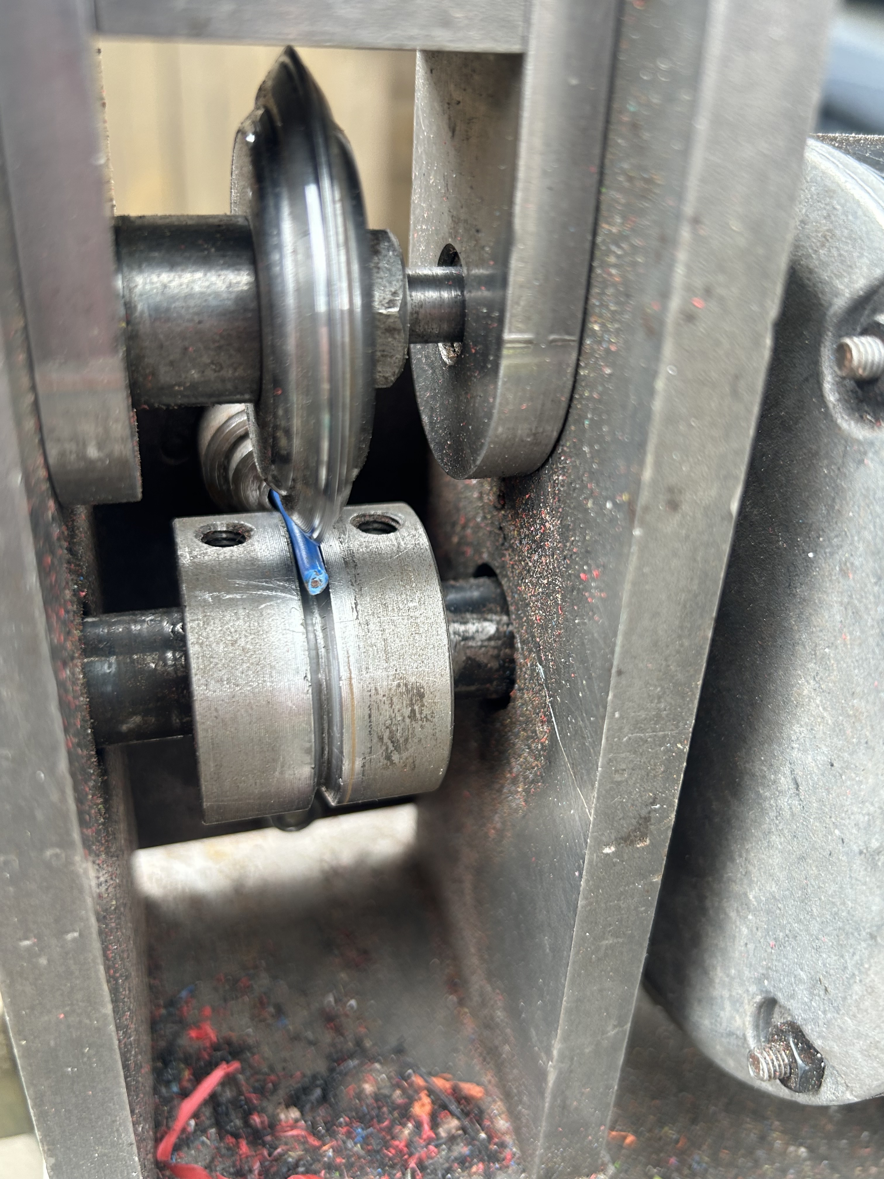

    Need some money so became a stripper!-img_8546.jpegCollet in place to feed cable into the cutter and lower drive wheel attached to motor output shaft.

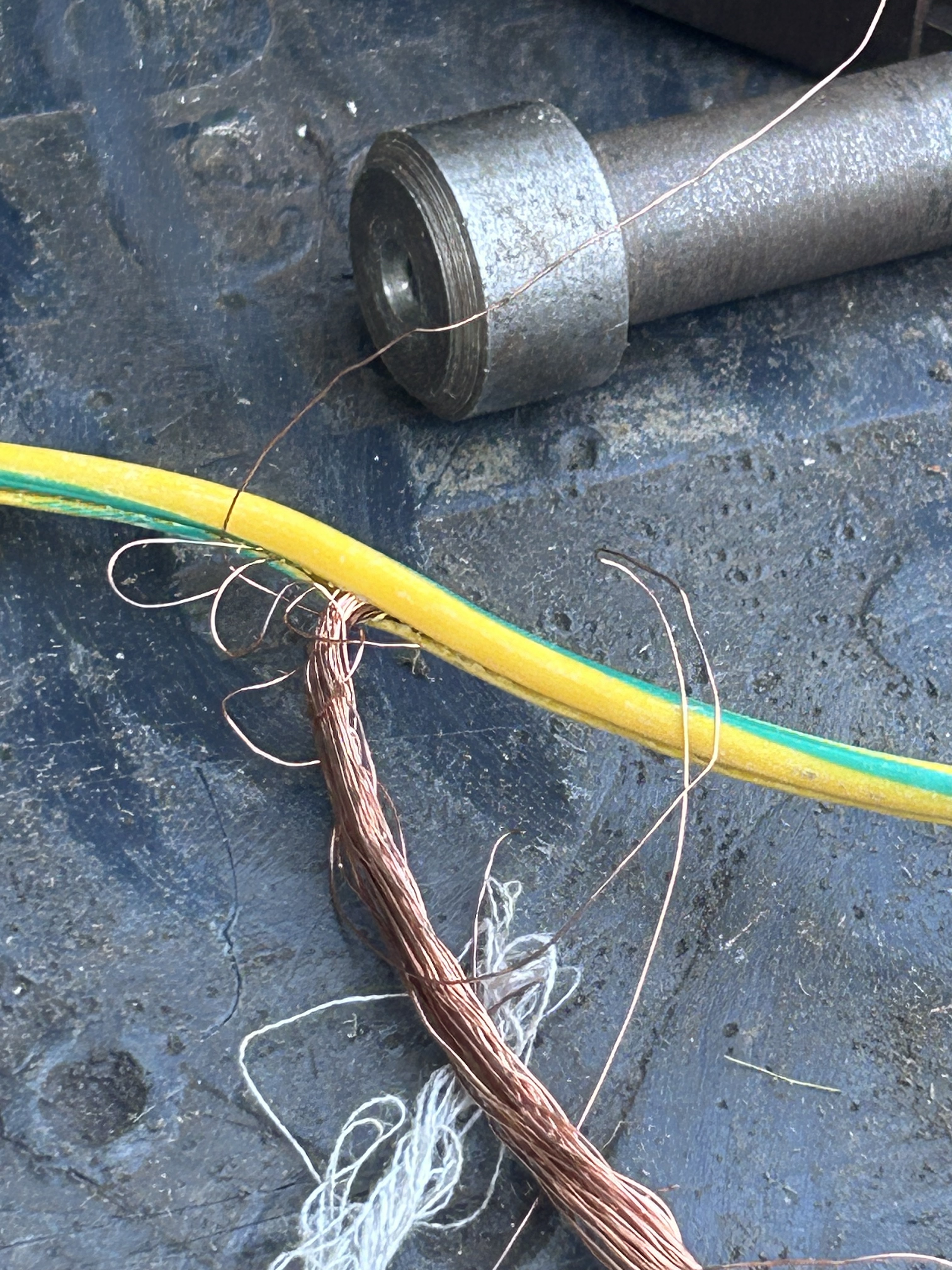

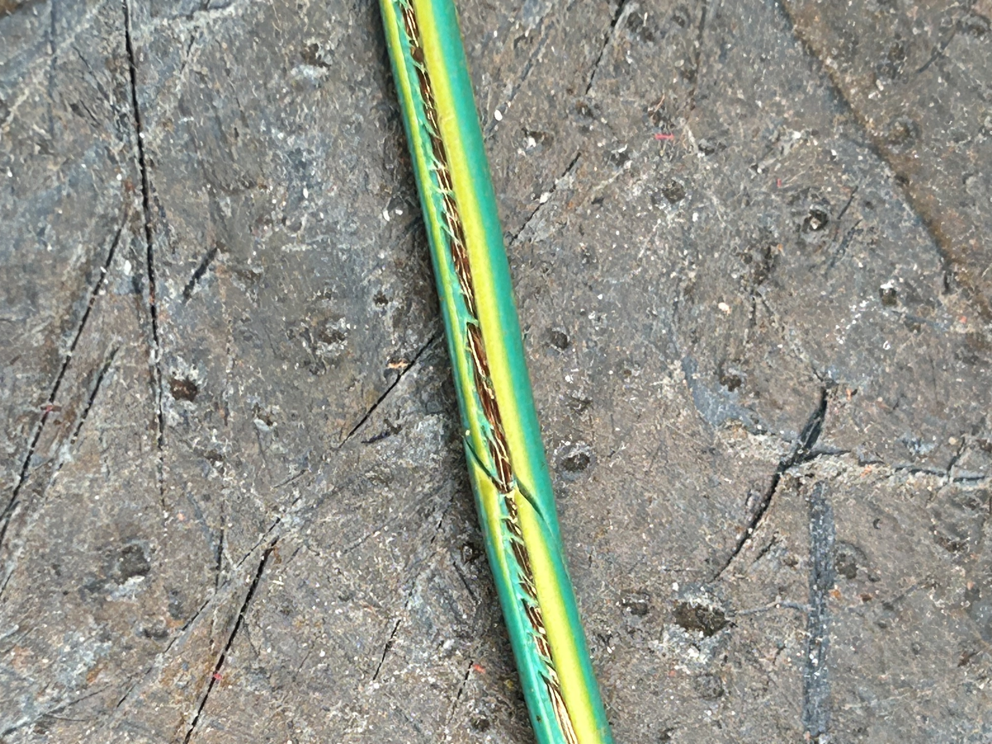

    Need some money so became a stripper!-img_8238.jpeg Need some money so became a stripper!-img_8240.jpegThe cable flies through the machine and the copper is easily removed.

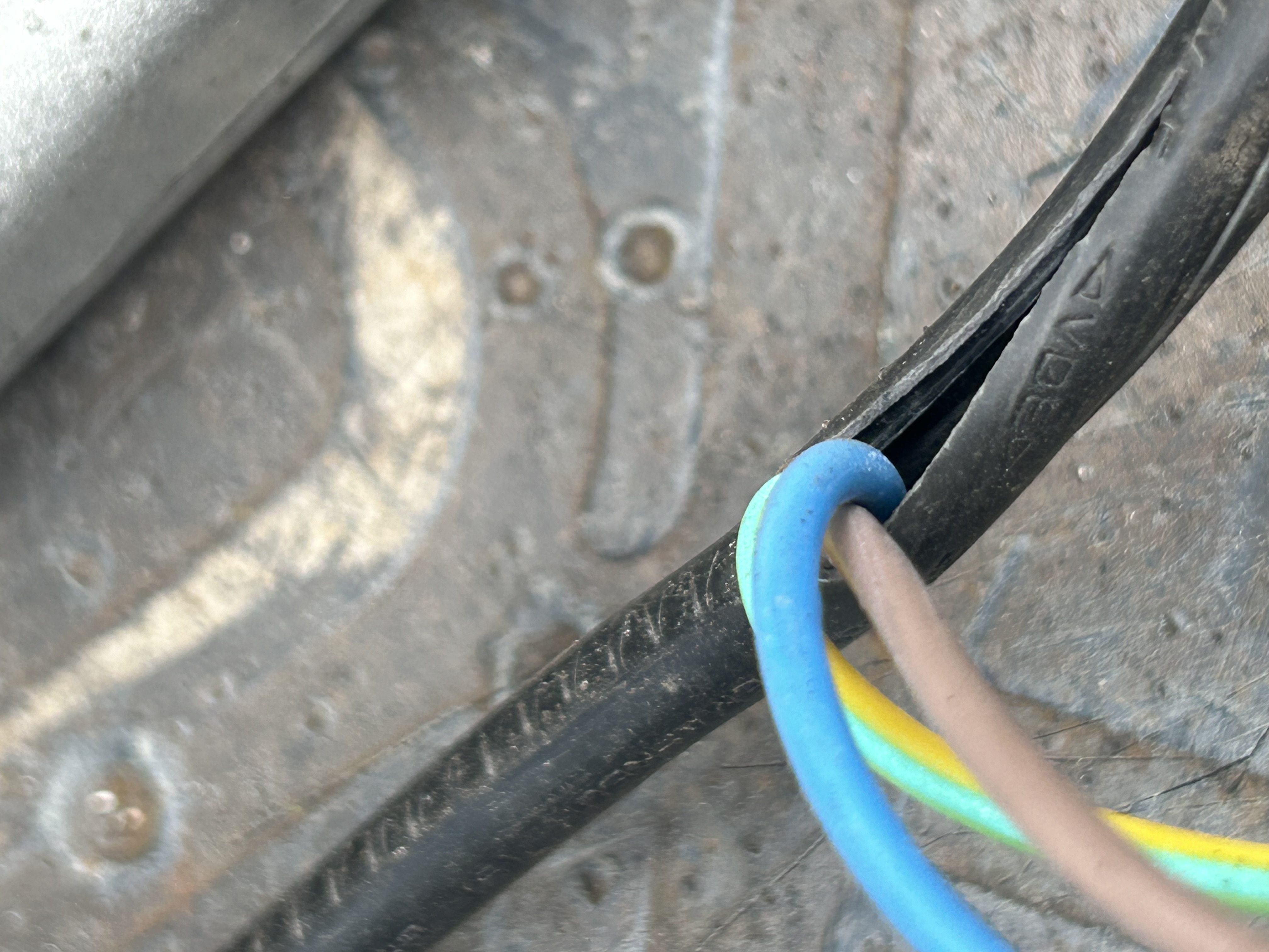

    Need some money so became a stripper!-img_8545.jpeg Need some money so became a stripper!-img_8230.jpegPVC insulation scored to allow copper to be removed.

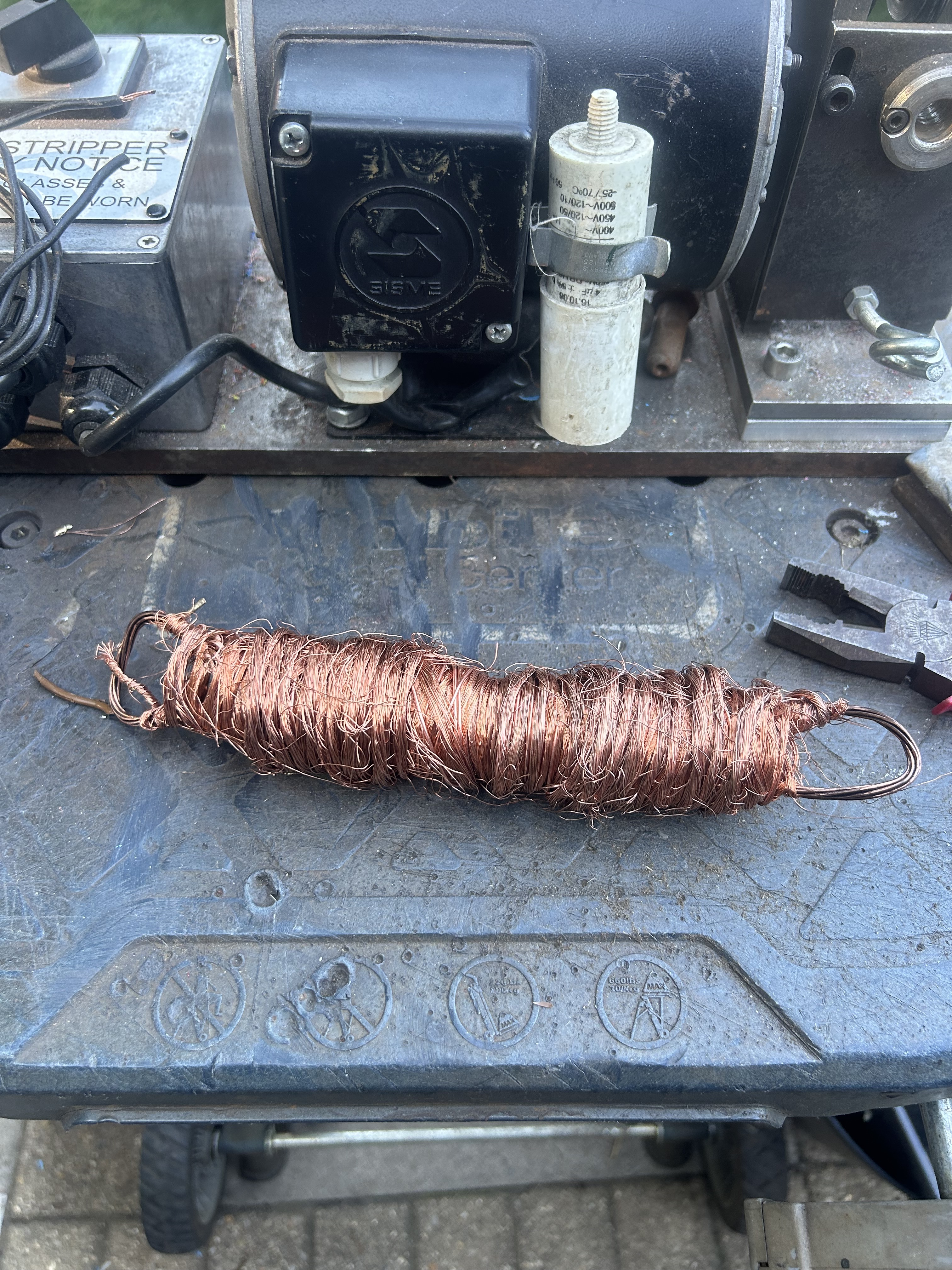

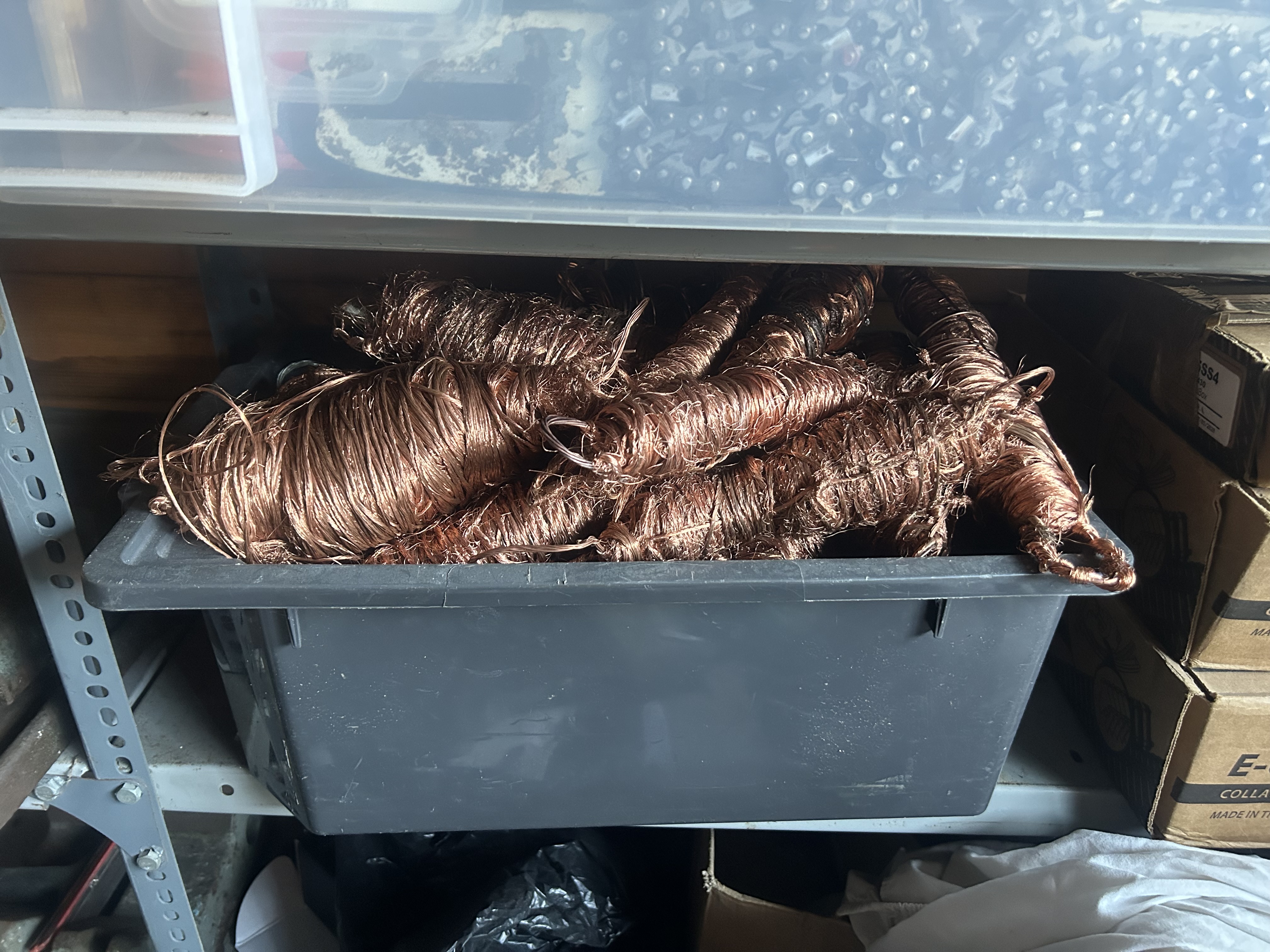

    Now for the money shots! Just wait for the price to be right and then weigh it in.
    Need some money so became a stripper!-img_8551.jpeg Need some money so became a stripper!-img_8552.jpeg
    There is a lot of talk is it worth stripping cable? time and effort vs return. My answer is this was a fun project to build and it works. Haven’t worked out my hourly rate, but the extra cash will help towards bits and pieces for the house refurbishment. So for myself a lot of effort but great to see the copper pile up.

    I like your build. Stripping wire by hand or even with a hand cranked stripper can be a royal pain.
    I noticed you went direct drive on the motor shaft though. I can't make out the RPM but you stated the wire flies through the cutter Having a foot switch is a really good safety measure, adding a VFD or SCR to allow you to vary the speed would add another safety measure. But maybe you don't need it/
