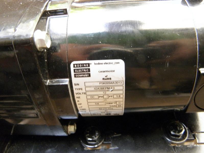

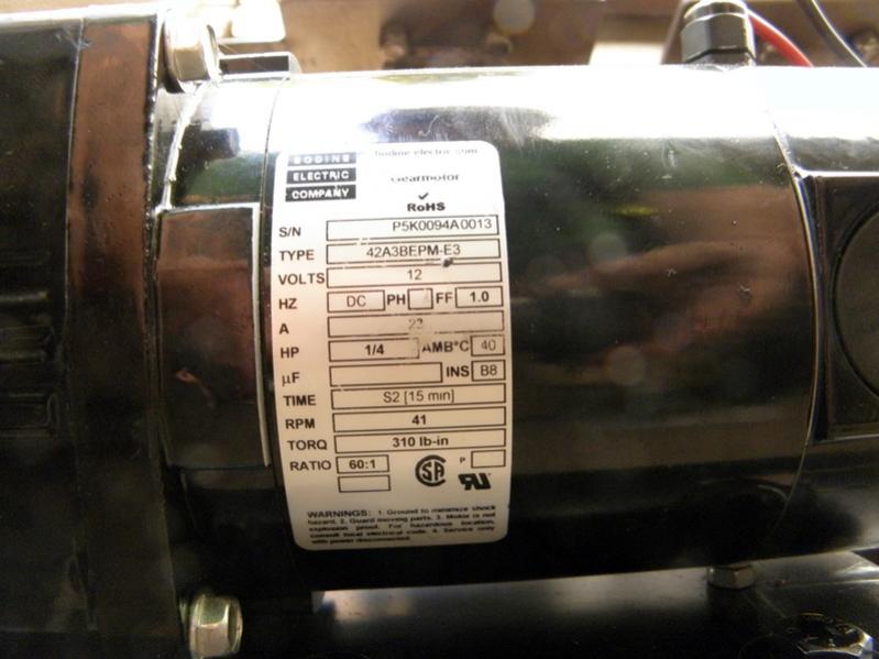

    The size of the motor is 1/4 hp and is as big as a car starter you can see one on my bead roller here.
    the easiest solution is to use a larger gear on the motor side. but I don't know if that would do the trick. vurently there is a 60 tooth sprocket on the shaft and a 11 tooth sprocket on the motor.
    this gearing is 5.5 rpms.
    Next best one is to put a reducer gear box on the shaft to reduce the ratio further.
    this motor is 41 rpms I need 1 or 2 rpms. The shaft I'm turning is balanced and does not require much torque.
