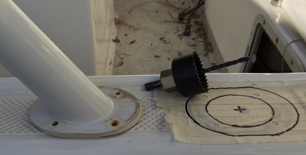

    Need to fit some rod holders to the boat today.
    fortunately for todays hole...45mm I have a 43mm hole saw. I am sure once it is done it will be closer to 45 than 43.
    2 problems..1 there is a 12mm hole in the centre where I need a 4.8mm hole. Solution use yesterdays method and create a new hole with a small piece of Ali.
    Problem #2.....the rod holder must be at 55 Deg meaning I have to drill the pilot hole through my Ali at 55 Deg, What is the "agreed" method of drilling a hole at 55 or any angle for that matter through a piece of steel? Fot this project it would not matter if the hole is a mm or so off as the drill is pressed to the side.

    Presumably you intend to do this with a handheld drill motor or something similar?
    I would first prepare a 55deg angle guide block that could be clamped in place to guide the drill.
    The biggest problem is getting the drill started. Once it's immersed in the material it can drill as usual but standard drills are not suited to starting hole at such an angle. A machinist would first use a (flat-ended) milling cutter to make an angled flat in the material so the (angled) drill could begin drilling on a surface perpendicular to its point.
    If you don't have a milling cutter, perhaps you can grind a surplus drill such that it's a flat-ended cutter. This is done all the time to create flat-bottoms in holes drilled with conventional drills.

    It seems as though you are planning on drilling though the gunnel of the boat. If so these are usually quite thick so you could start the pilot hole vertical until the point has started to drill then lean your drill to the angle you want. Once the pilot is through drilling with the hole saw will require going very slow at first contact. Hole saws can grab and gouge quite unexpectedly and will continue to do so until they make full circular contact Using a hardened drill rod as th epilot guide instead of a drill bit helps some but care must still be taken

    I used a 6 mm endmill to create the flat as suggestedand then drilled the 4.8mm for theholesaw center drill. This gave me the perfect start for the 55 deg hole. Then the problem with the "waste center bit" was encountered. thanks for that advice. Ended up cutting the hole then at 90Deg to get rid of the waste. then the "guide" constructed to guide the drilling machine helped to clear the last little bit of waste on the other side bottom.
