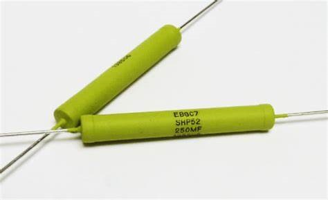

    Those look like 10KV resisters. 5ppm power resisters to me.
    But the video looks to be deceivingly shot out of sequence, The part where the flame is heating while the pincer spins the wire while a nichrome wire is wound around creating the red hot blob would be the first part the second stage is where you see the yellow sleeve on the wire with the blob being dropped down then the blob is pulled into the sleeve the first of the video should be the last of it
    Or at least that is the way I am looking at it I'm open of other theories

    It could also be some sort of other sealed component (reed switch, indicator, high temperature sensor) - I don't know, can't really tell. There is a lead on both ends...

    The torches are heating up glass tubes...

    Quote Originally Posted by IntheGroove View Post
    That is why I thought of reed switches...
    But some other parts come up:
    NTC Thermistors
    Fuses (found fuses that were just glass tubes sealed
    Capacitors (was surprised to learn about hermetically sealed tantalum capacitors in a glass tube)
    Diodes (the good ol' 1N914 is a classic glass packaged diode from the early days)
    High voltage resistors (Frank S mentioned this one)

    I'm pretty sure those are short LED filaments being prepped to go into a specialty lamp of some sort. I have a bunch of them in various sizes in my parts bins, and they are good for lots of projects.

    Quote Originally Posted by schuylergrace View Post

    Winner! I have seen those as well...
