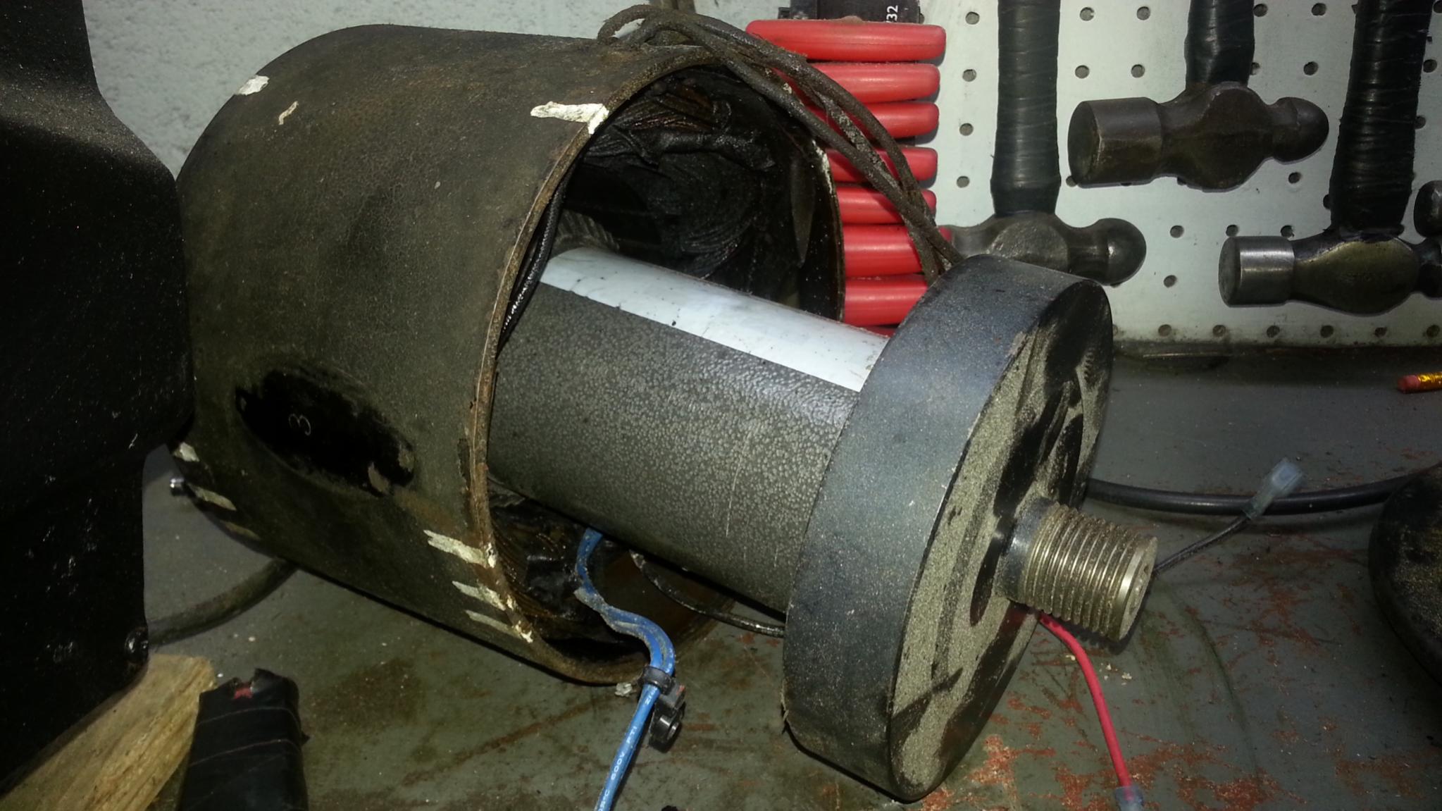

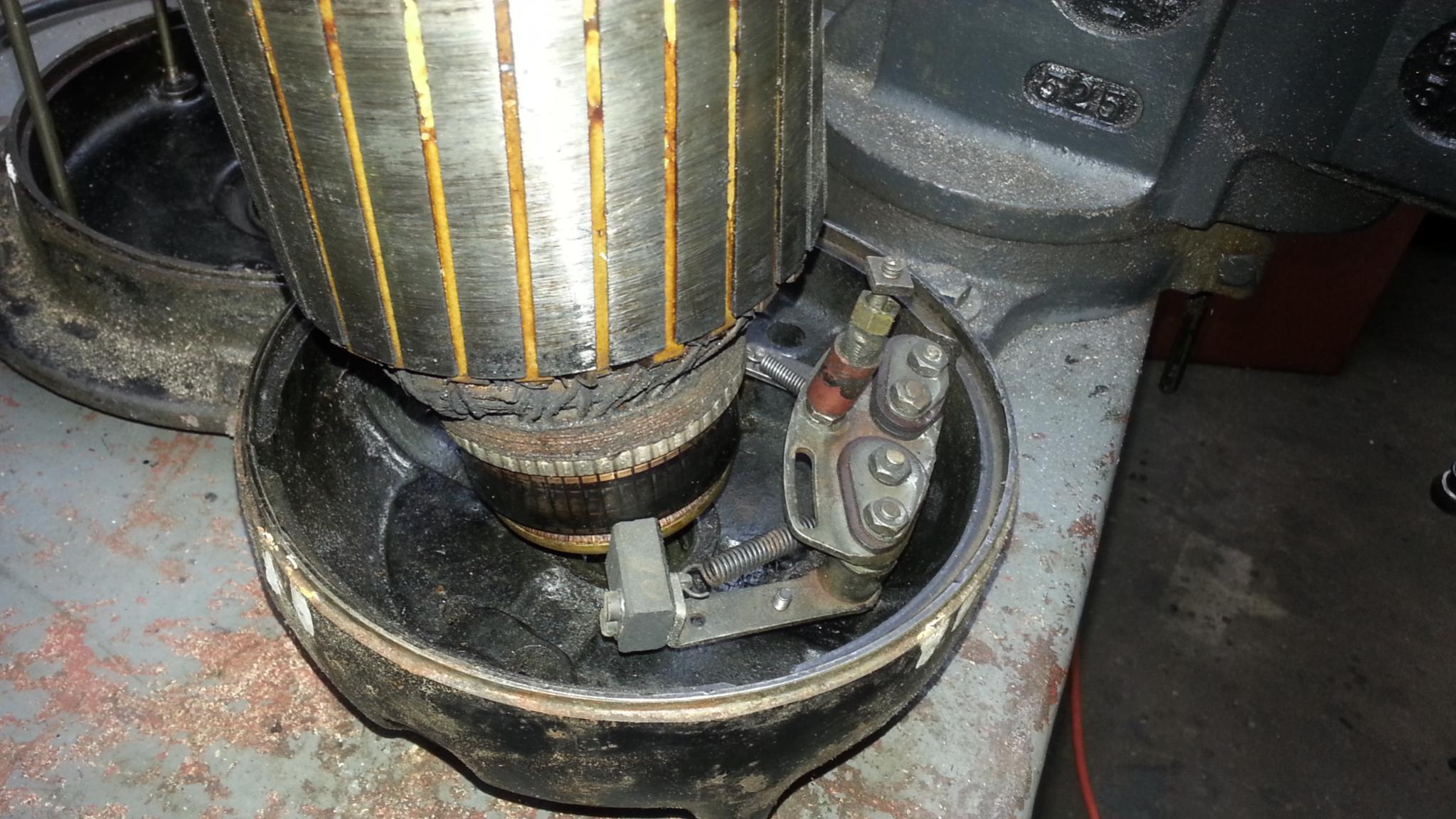

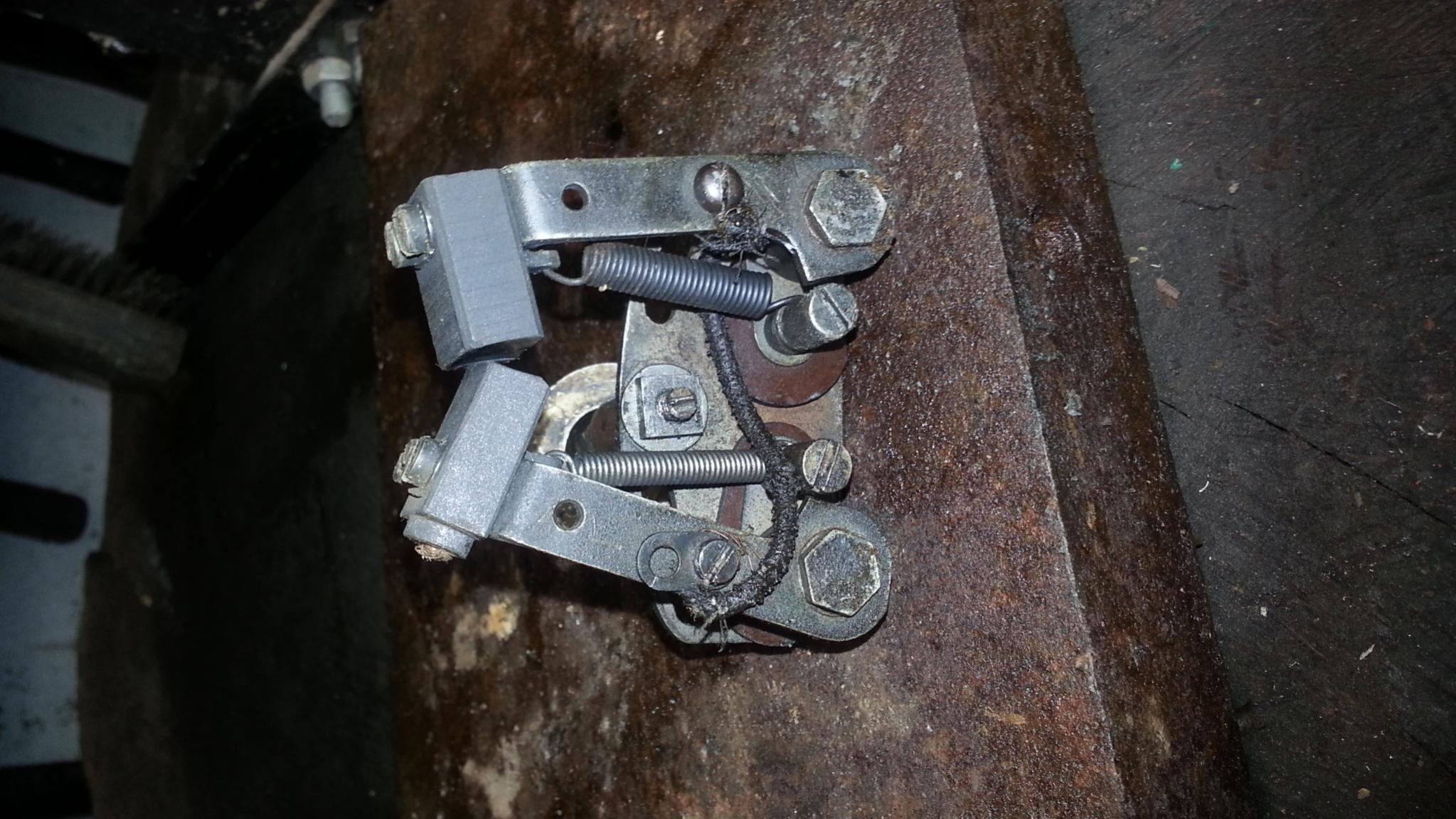

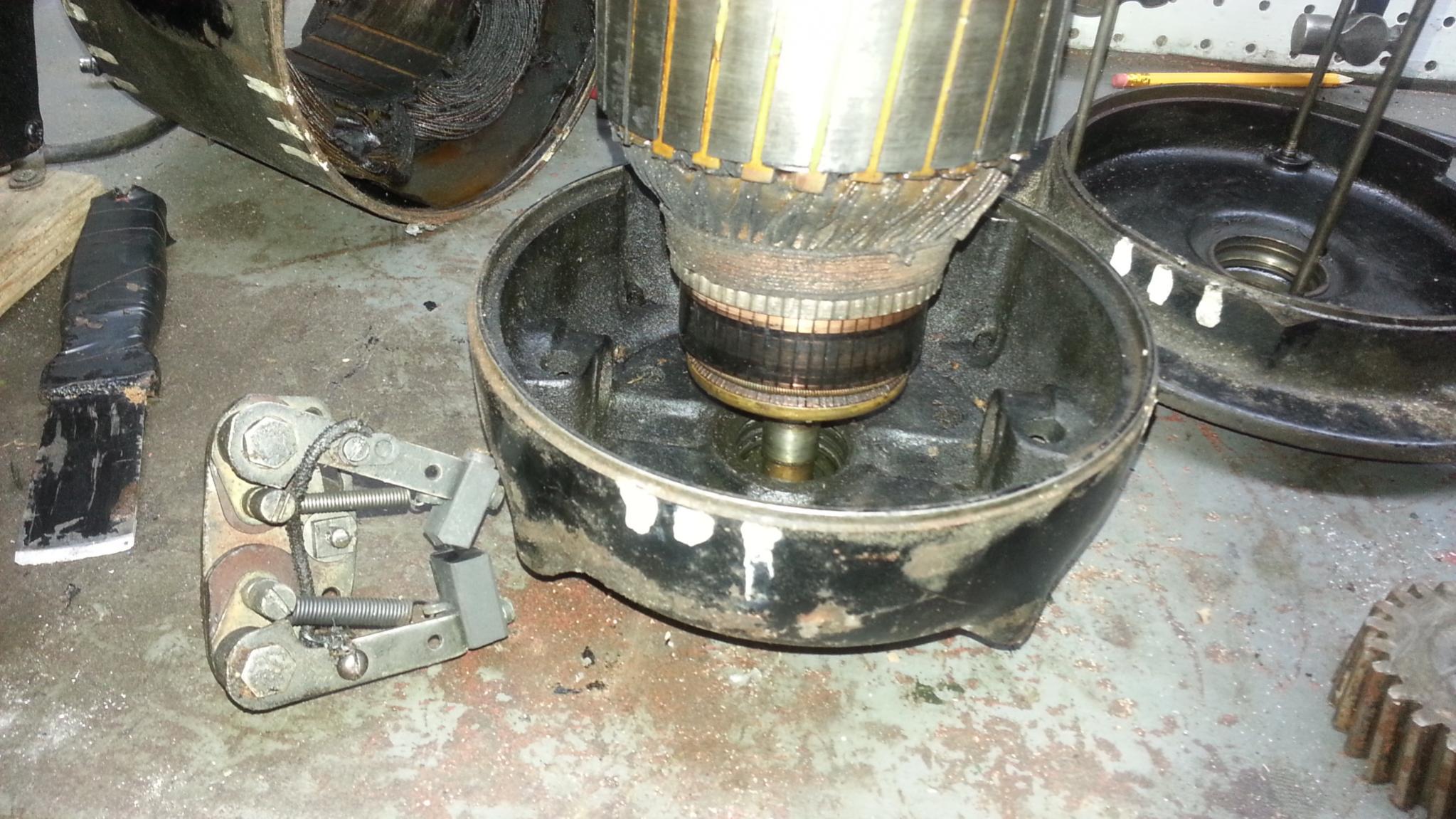

    I really enjoyed the shop videos you made, I could watch videos like them for hours! thanks for sharing the link, I will be on the look out for the others too. oh and neat bikes too! (You have the same problems with moisture as I do. I was taught to wipe Johnson s floor wax on bare steel surfaces to keep rust away. you might try it, the hardware stores sell it for $5 a can or so. the stuff is just a large can of clear shoe polish)
    The photo of the saw you posted looks very similar to mine. That one might be a newer version, it has a cast table (mine has a piece of thin plate steel for a table). I wonder if those pulleys might have been a factory option later on, pretty interesting. on mine there is a pat pending cast in the blade guides so its supposed to be an early one.
    I haven't been able to find any photos or diagrams of how the brush set up should be. when I bought the saw it had a single small bent screw holding the mismatched brushes to the contact surface. my understanding is the motor was being run as a repulsion only motor with out switching to induction as it originally did. someone in the saws past did some short cuts in the repair process. the saw did turn on with some authority but squealed like there was a bad bearing. so now I am trying to solve the mystery of how the motor should be.
    Jerrdan john if you ever need to change a brush or a bearing in one of your repulsion induction motors I would love to see how the parts are set up. Or any other advice would be great as well.
    here are some quick photos of everything ( sorry for the calamity in the background, too many projects at once)

    been considering using a treadmill motor inside the old motor with some spacers, but it feels wrong.

    Working on it for you, Just in case you don't have the tag, here is what you have.
    Made in Chicago USA
    J.D. Wallace & Co.
    1/2 HP
    110/220 Volts
    AC
    60hz
    1800 RPM
    Type RSA
    No. 516811
    General Electric Motors
    I am not finished so give me just a little time. Jonathan

    Jere, after a lot of research and even posting a couple adds for a Type RSA motor, I think your best bet is to adapt another motor to it. I would not feel back, I would actually feel good that the machine is being saved and not scrapped. I assume the treadmill motor is variable speed and that would be great. If you want to keep it vintage the one in the photo would work also. It's my understanding that the one in the photo is a few years newer then yours and the update was done in the 30's. Whatever you decide, I will help all I can either way. Jonathan
