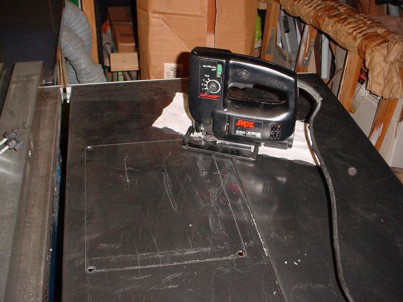

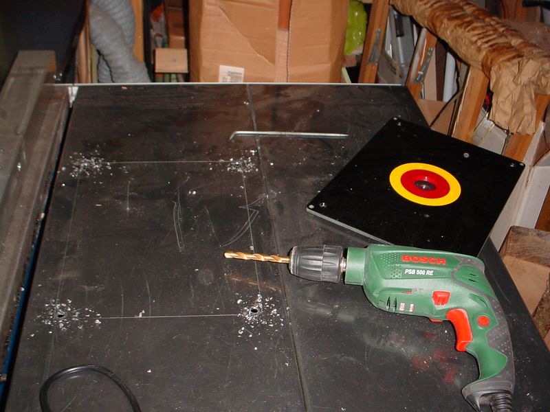

    So, first I purchased this rectangular resin sole adaptation and I traced the contour on the side extension table, which is made out of thick metal sheet. I first drilled the 4 corner holes.
    Then I used the jig saw with a metal blade to cut the metal sheet, but it is quite hard and thick steel and the blade teeth got worn very rapidly. I had to recut several times the blade with a dremel cutting disk, in order to get fresh teeth on the cutting range.

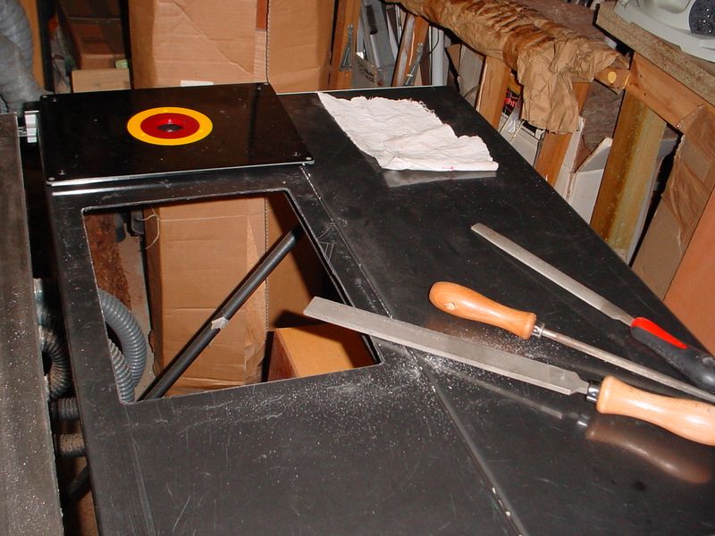

    After a hard time cutting this metal sheet with the jig saw, I adjusted the contour with several files.

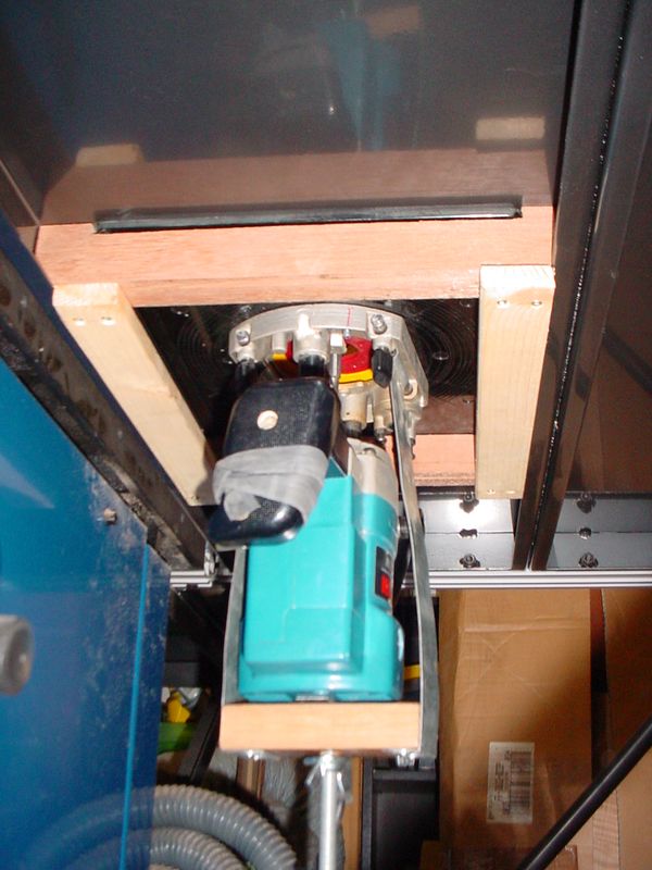

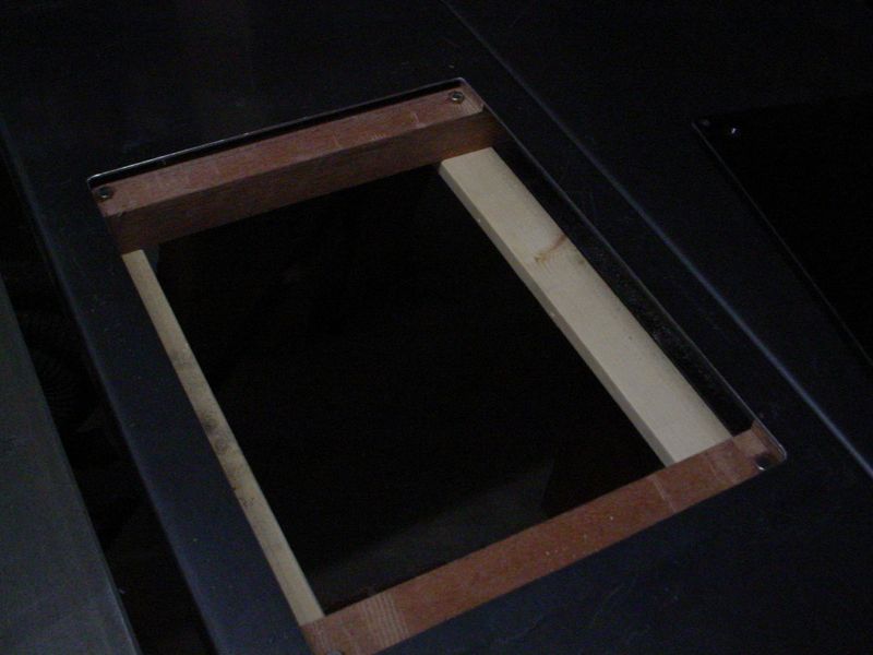

    Then I had to find a way to fix the resin sole flush to the table. For that I made a wooden frame inserted in the U shape made at the edges of the metal sheet in order to stiffen it.
    The frame is slotted so that the resin sole comes just flush to the table top.
    To get a neat adjustment, the four corners have 4 neodyme magnets inlaid in the wood of the frame, and the sole has four metal set screws that stick to the magnets.
    The frame, from the under side. You see how it is locked in the U shape at the edge of the table.
    And here is the top side, just flush.

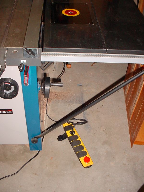

    The router lift system as showed in the previous post.
    and here you see how I control the engine with the foot.
