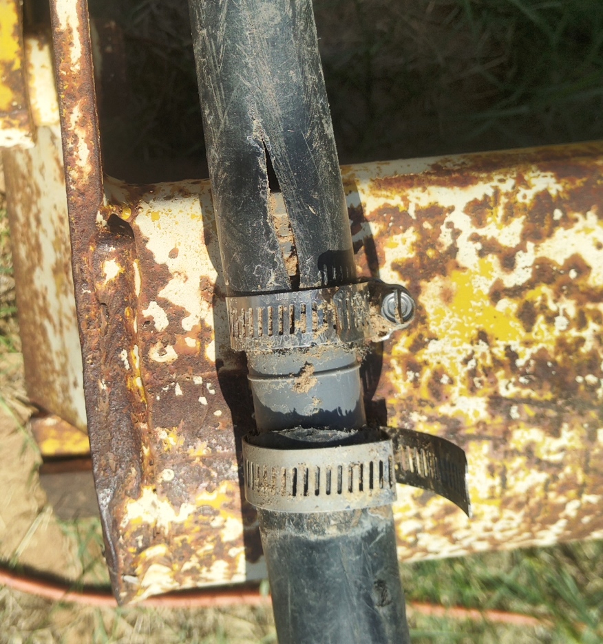

    The 1" poly pipe is preexisting to our living here and there are a few connections in the length I don't know if they had to buy the pipe in 100-to-150-foot coils or if it has broken from time to time. I suspect maybe gophers or the former. Anyway, this summer the pipe developed a leak and I lost 1000s of gallons of water. before the evidence of the leak was known.
    I dug up the pipe to find a section that had 3 splices, in 2 feet this is what 1 of the splices looked like and the source of the leak.
    the pipe had split this indicated to me that the splice inside was installed when the pipe was cold weakening it and it may have been fine and apparently was for many years but when I pressed the well back into service this summer my delivery pressure caused the pipe to split.

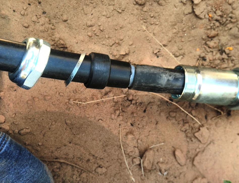

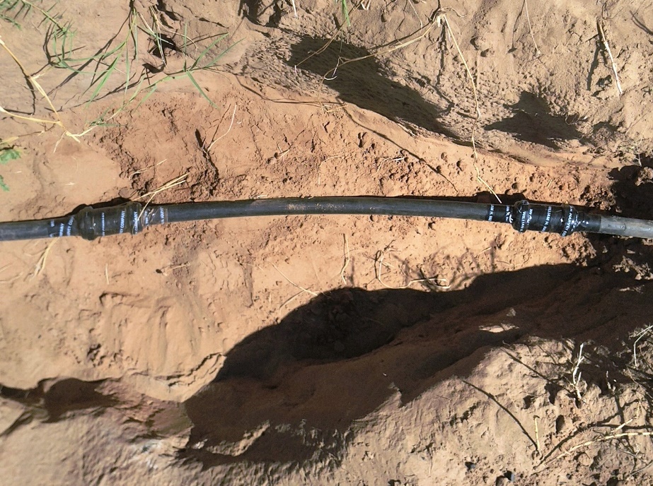

    To repair the leak, I cut out the section with the splices and made 2 new splices Like this

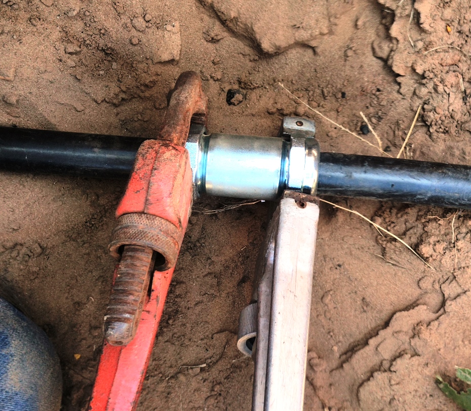

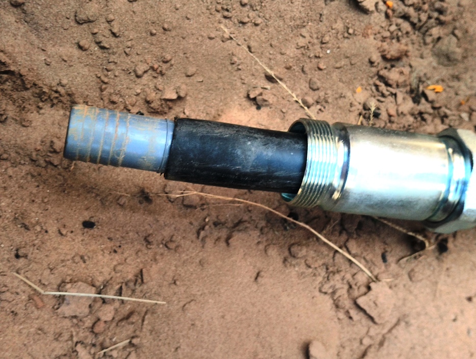

    I used a heat gun to slightly soften the pipe inserted the splice and instead of using a hose clamp I captured the splice with a compression splice fitting normally used on steel pipe.

    Properly tightened the compression fitting does a much better job of securing the splice than a hose clamp

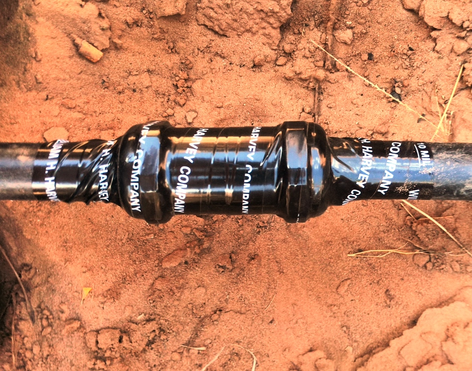

    I then wrapped the splice connection in waterproof 10 mil 2" wide vinyl pipe wrap tape to protect the steel fitting from moisture in the dirt

    Completed repair waiting for the next break to show up. Hopefully many years from now
