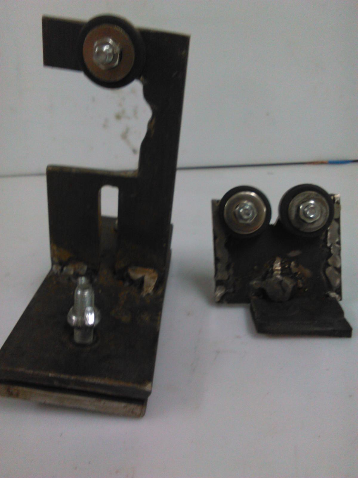

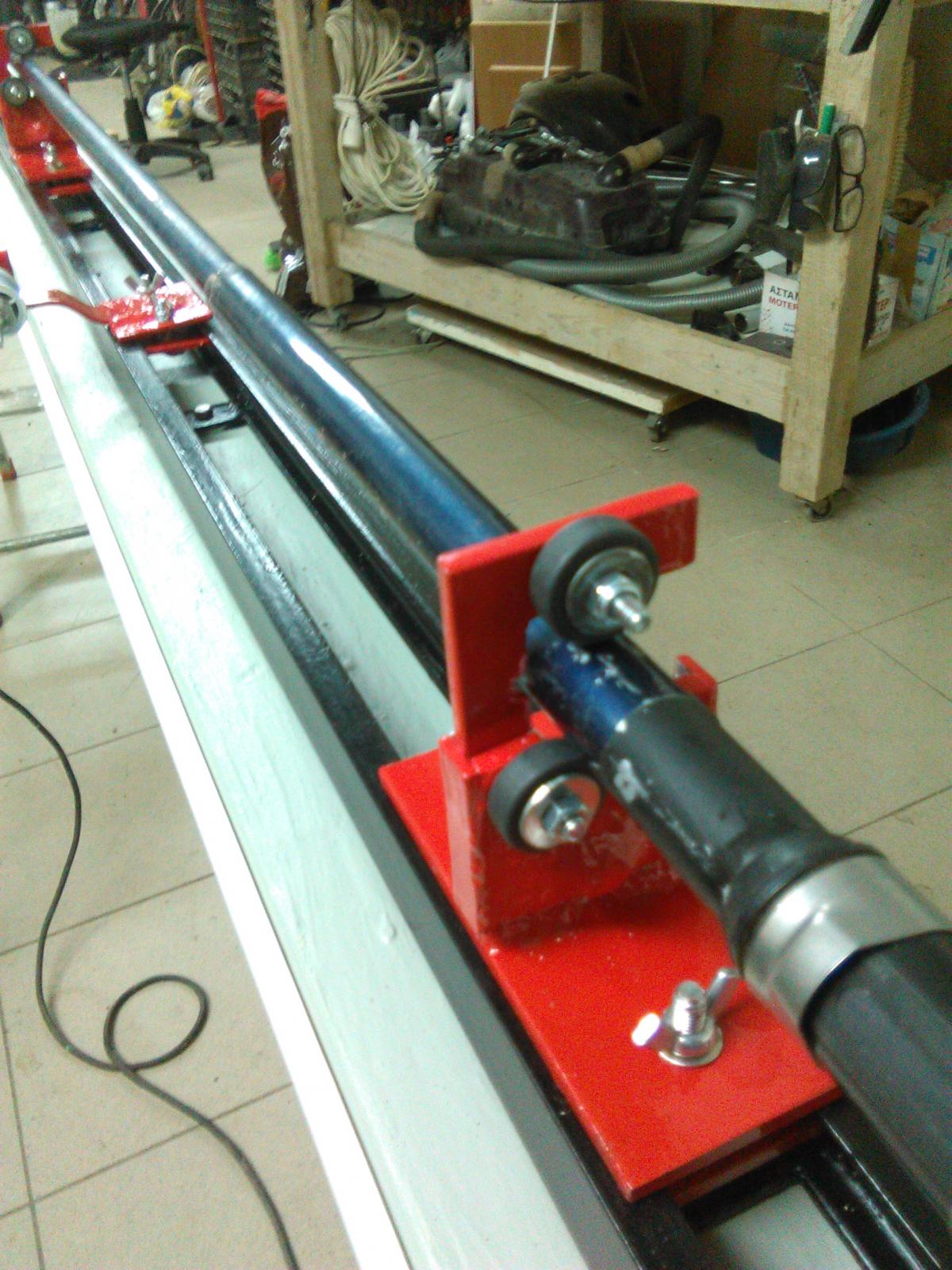

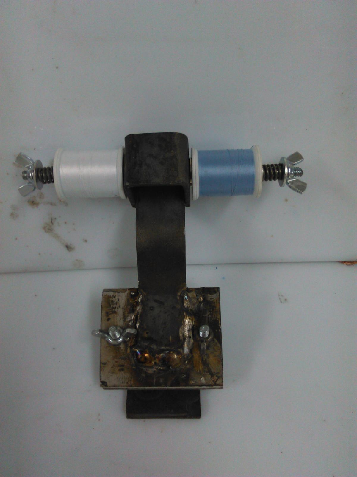

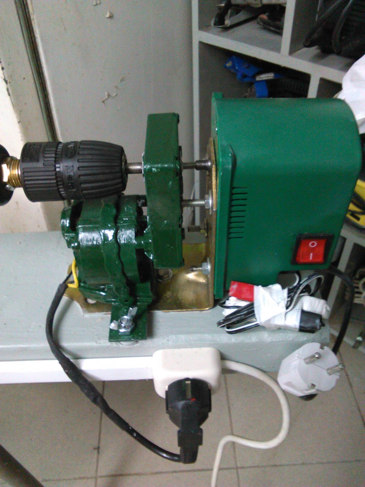

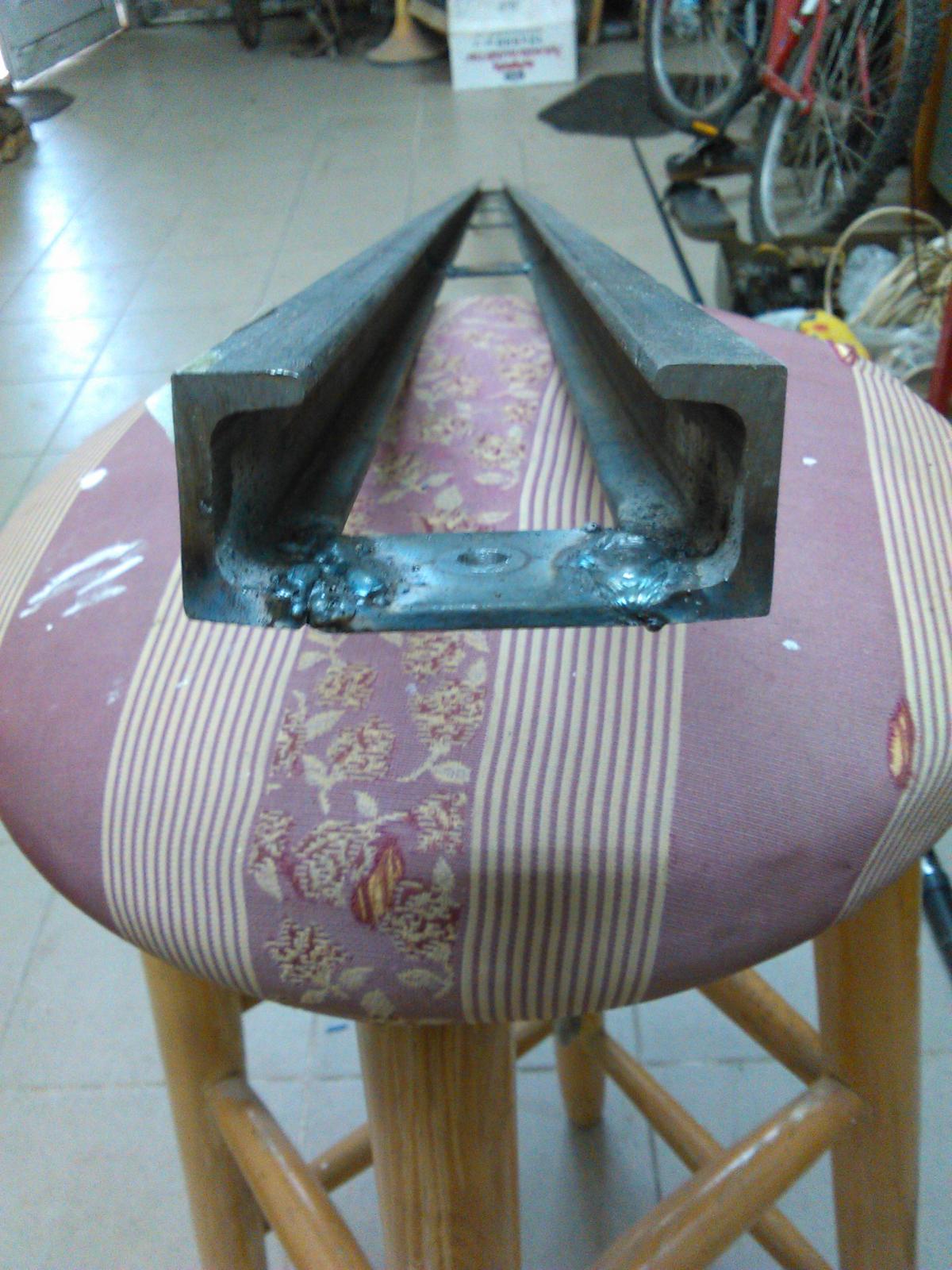

    MY HOMEMADE ROD BUILDING MACHINE
    MY HOMEMADE ROD BUIDING MACHINE
    The first motor works faster than the second.The second is also for drying the glue and also works reverse if we make a mistake. The foot switch helps to have our hands free. I use a chuck from a drill to tight the axis of every motor.I have used bearings with a ring inside to have smaller hole covered with heat-shrinking material to be soft .
    Attached Thumbnails Attached Thumbnails MY    HOMEMADE    ROD BUILDING  MACHINE-img_20171028_131703.jpg   MY    HOMEMADE    ROD BUILDING  MACHINE-img_20171028_131917.jpg   MY    HOMEMADE    ROD BUILDING  MACHINE-img_20171028_132145.jpg   MY    HOMEMADE    ROD BUILDING  MACHINE-img_20171029_212722.jpg   MY    HOMEMADE    ROD BUILDING  MACHINE-img_20171029_212704.jpg
