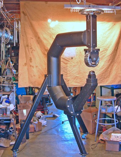

    At the beginning are a few photos/description of a pair of wheeling machines a friend and I made decades ago. After that is a lot of description and photos of my "I don't ever want to feel like I need to build another one after this so I need to do everything I can think of and try to do it right" machine from about 10 years ago.
    The machine is just under 7 feet tall and the chassis is made from 8" Schedule 40 pipe. I purchased a nice set of Hoosier Pattern anvils because I don't have a CNC lathe for doing accurate radii on large pieces, and that was money well spent. What wasn't so well spent was the time making the quill spring loaded. There is a lot of discussion on metalshaping forums on how stiff a wheeling machine should be and while I had some thoughts of my own I figured that I should make it so I could try it in either sprung or rigid mode, and also have some control over the spring rate too. At the end of the page is a summary of some testing I did on the two modes and my conclusions.
    The completed machine:

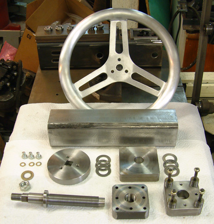

    quill components:

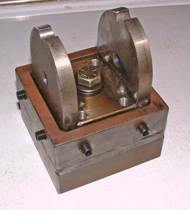

    adjustable lower anvil holder:

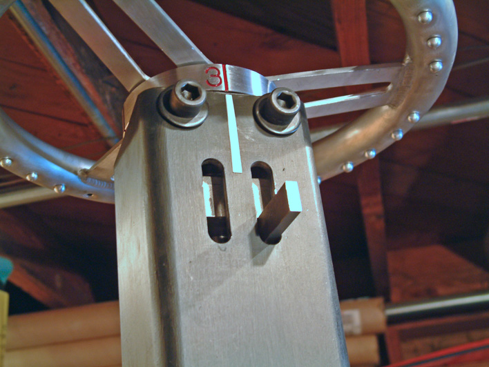

    The quill adjuster and dial, with each of the 4 increments being .01" movement on the quill. I can easily interpolate to .001". That is a spring lock-out bar protruding from the front of the machine:

    Thats an awesome English wheel, that thing should never wear out, good work

    I remember when English Wheels caught on again, everybody and their uncle wanted one.
    Early 90's, guys seeing 'Indian Larry' of Brooklyn NY cable show, put them back on the map via tanks and fenders. Doubt a 1/3rd found use by the wannabes.
    Now, M. Moore's wheel is the real deal. No question, sturdiest home built I've seen, in a big way deserves the high quality wheel tooling. Display of project work says it'll be used.
