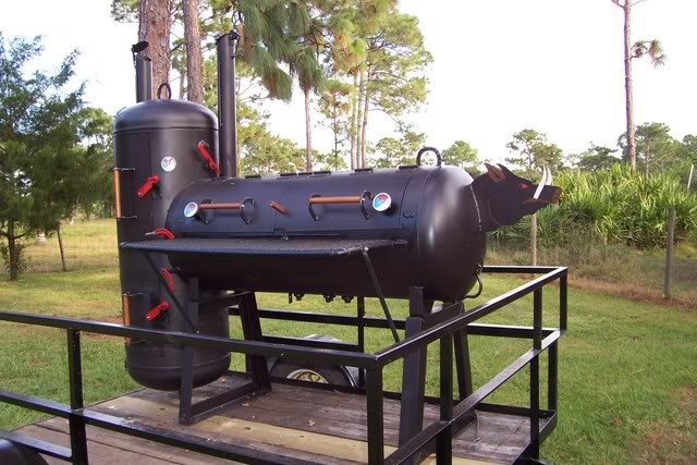

    I hope this might be considered a tool. It is a tool I use to cook with. I bought a couple old propane tanks and made this. Two cooking areas. One is the horizontal tank and one is in the vertical tank. The firebox is in the bottom of the vertical tank. I love cooking on this when I get the time and food turns out sooooo good.

    Nice smoker.....what size tanks did you use and were they new or used? I'm looking to build something similar,just picked up a small 5x8 trailer recently and looking for design ideas!
    THANKS!

    So sorry for the delay in getting back to you. I had open heart surgery and am just now getting back into the swing of things again.
    The tanks are what I call 120 gallon tanks. I picked them up at two different places on Craigslist. Both had some gas. I would recommend having a pro open them up for you although I did it myself. These things can be really dangerous to put a torch or any spark near them with even residual gas in them.

    No worries,your health is much more important! Thanks for the info,I did locate one tank on CL but it was way to big (300 gal I think) so I am still looking.
    I do have a friend who has been welding fo 45 years and has opened these tanks up iin the past I have already talked to him about making the inital cuts (Momma didn't raise no dummy...........lol)
    Thanks for the info,stay well,heal quickly and keep the faith....................
