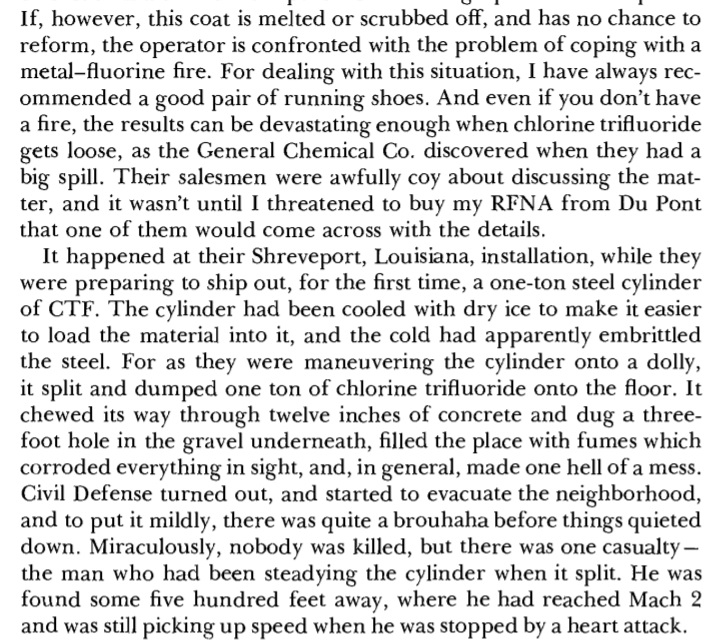

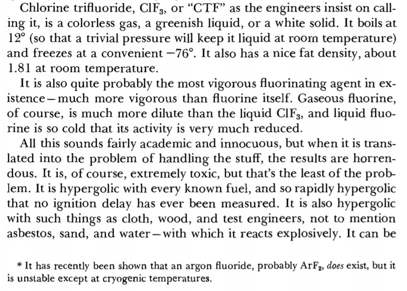

    -Isn't just chemistry sooo exciting?
    Some recommended reading is John D Clark's "Ignition!", actually with a preface of Isaac Asimov (sic!)
    Subtitle: "An Informal History of Liquid Rocket Propellants":
    https://library.sciencemadness.org/l...s/ignition.pdf
    Clips from p 89f (of 233) of this "unputdownable" biography, from the "days at the office" of pioneering US rocket scientists.
    Muriatic Acid - sealed, in a bag, in a steel drawer - looks like rust under the bag!?-ctf.jpg Muriatic Acid - sealed, in a bag, in a steel drawer - looks like rust under the bag!?-ctf2.jpg
    French Lab precautionary film: -What the stuff does to your PPE: clean, wet or dirty:
