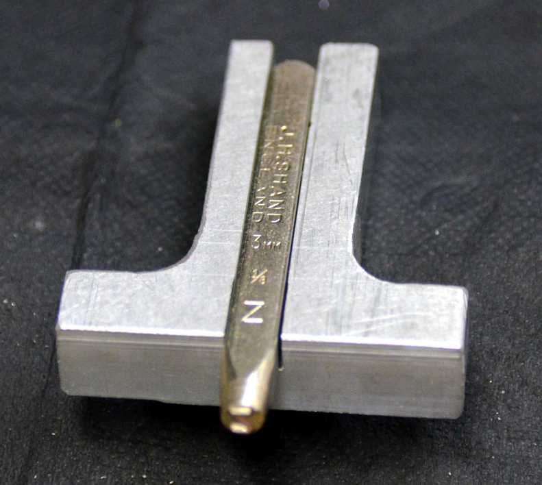

    A couple of weeks back jjr2001 posted a great simple idea for a holder for number and letter punches. http://www.homemadetools.net/forum/h...622#post104816
    The next morning I pulled a small piece out of the aluminium scrap box and made a close copy.
    Multiple hand stamp helping hand.-holder-00.jpg Multiple hand stamp helping hand.-holder-01.jpg Click on the thumbnails for full size pictures.

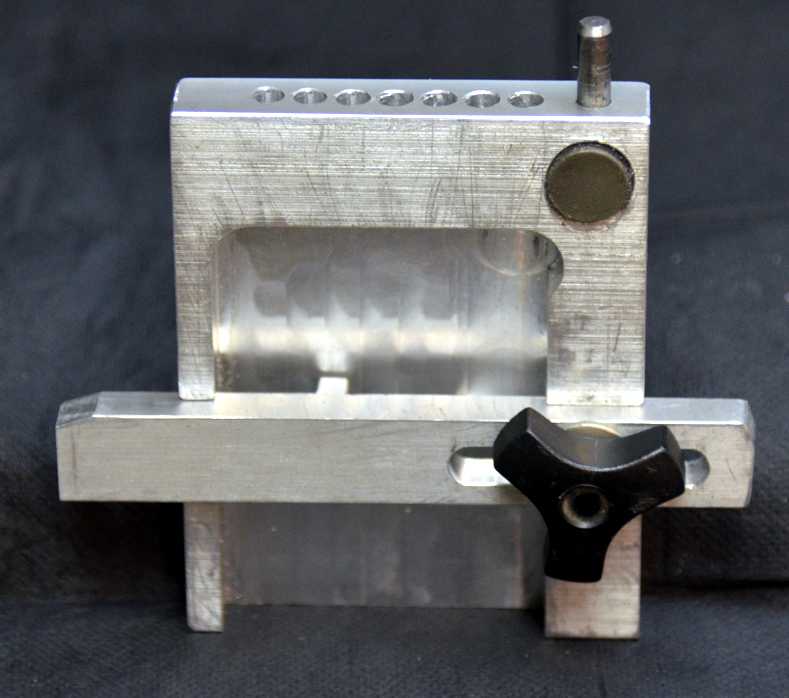

    Here is my version, I saw no reason to make it any different to jjr2001's.

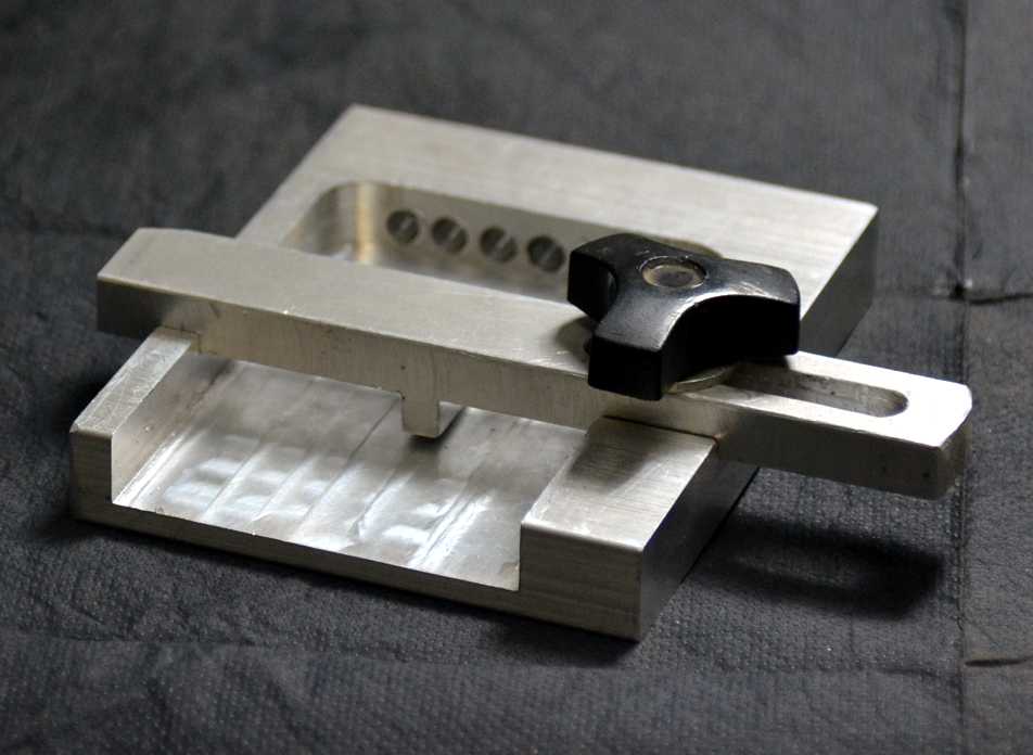

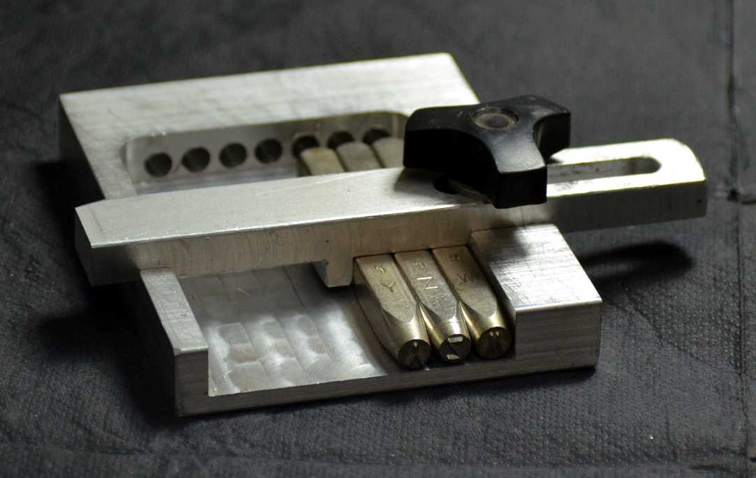

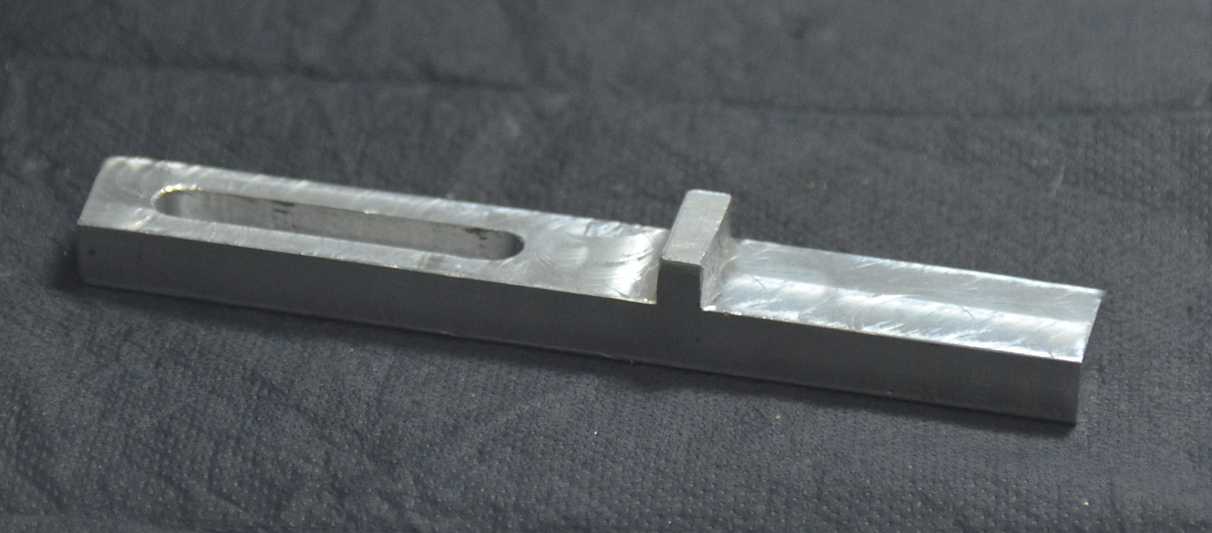

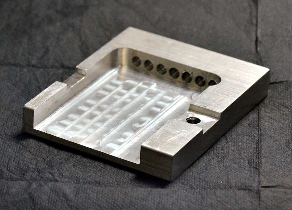

    As expected that turned out to be a great help to keep the punches square to a flat work surface. However I often need to punch several numbers in a line and with even spacing. More often than not the row of numbers will be quite wobbly. I needed a tool to help and I started thinking about it after making the copy of jjr2001's. I don't like to spend too much time making tools because my main interest is using tools, so I wanted a simple idea and it came to me when trying to get to sleep last night. It is very simple and took very little time to make. It basically consists of two pieces of aluminium, the scrap box yielded those without needing their external dimensions being changed. A little milling and drilling was all it took.
    Multiple hand stamp helping hand.-holder-02.jpg Multiple hand stamp helping hand.-holder-03.jpg
    Here are the two main pieces, the minimum amount of machining is evident.

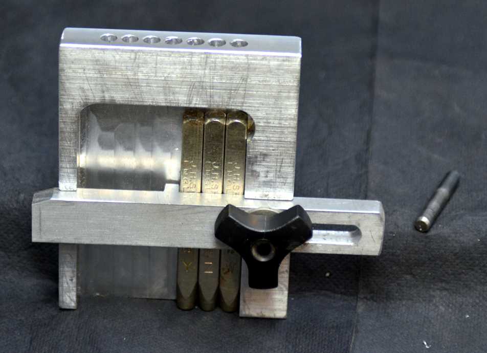

    Multiple hand stamp helping hand.-holder-04.jpg Multiple hand stamp helping hand.-holder-05.jpg

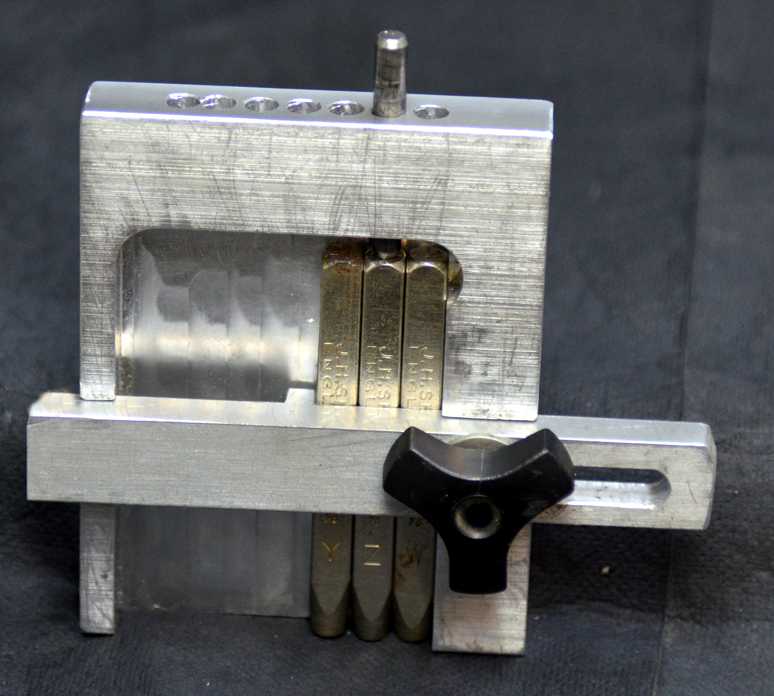

    The assembled tool complete, empty and loaded with 3 punches. It can take up to 7 punches.
    The clamping bar is moved to the right so that the protruding piece holds the punches up against one another. The wing nut clamps the bar.
    Multiple hand stamp helping hand.-holder-06.jpg Multiple hand stamp helping hand.-holder-07.jpg
    Ready to use, note the 5 mm round rod (made from a broken drill bit) which is used to allow one punch at a time to be hit.
    This holder was made for 1/4" punches but it is only a question of scaling to accommodate any size. It would be next to impossible to be able to hit multiple punches with equal force without building a much more complex tool. That is the reason for the upper circular guide holes and a secondary round punch. The secondary punch can be moved from one letter/number punch to another as each indentation is made.
    One disadvantage of stacking the punches side by side is that the centre distance between the characters is the same as the width of the punches, 1/4" in my case. That might be too wide in some cases. There are various ways around this which I'll leave to the ingenuity of any readers who make their own.

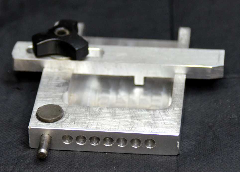

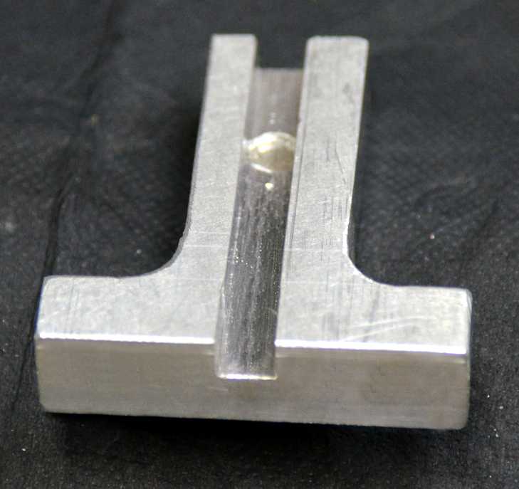

    I just made a small addition to the punch holder. It was obvious that I would keep losing the secondary punch. So I drilled an additional hole for it and inset a small magnet. Now the punch is kept with the tool and won't get lost.
    Multiple hand stamp helping hand.-holder-08.jpg Multiple hand stamp helping hand.-holder-09.jpg Click on thumbnails for full size.

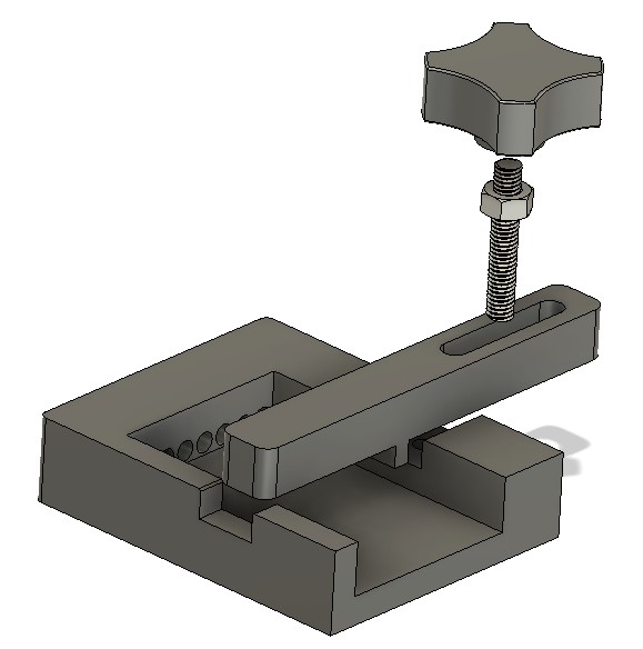

    Hi Andy
    I came across this post and liked the concept. I have drawn your idea up in Fusion 360 and 3D printed it and it works fine. The Fusion file uses Parameters so you can rescale to any size of punch and any number of punches. See my blog link below which has a link to the Fusion file.
    https://www.altrish.co.uk/2021/06/15...60-parameters/
    Woody
