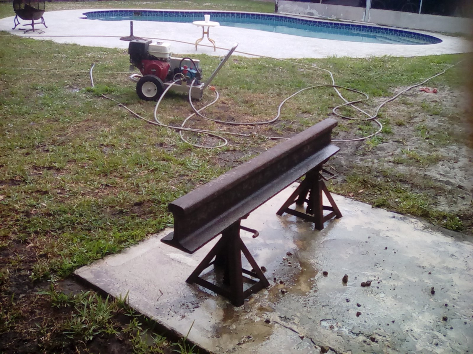

    Found this at the end of my street,thought I'd make a screwdriver or something. I'll get back when complete.

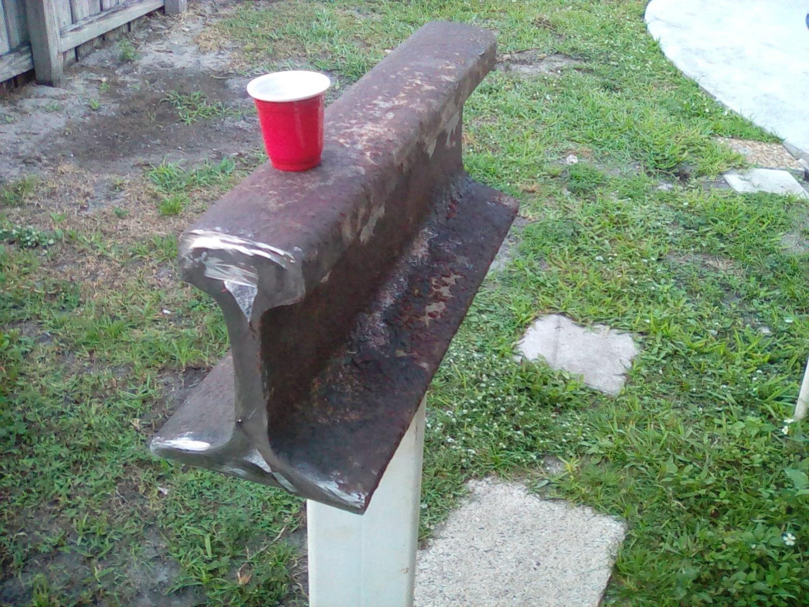

    10-4 That. Lopped off eighteen inches with a 4.5 inch cutoff. Pretty hard stuff.

    Anvil + cupholder

    "Found this at the end of my street,thought I'd make a screwdriver or something".
    It followed me home. Can I keep him?
    Less than severe test as cup holder.
    How about King Size Monopoly player token.
    Pennsylvania SHORT Line.

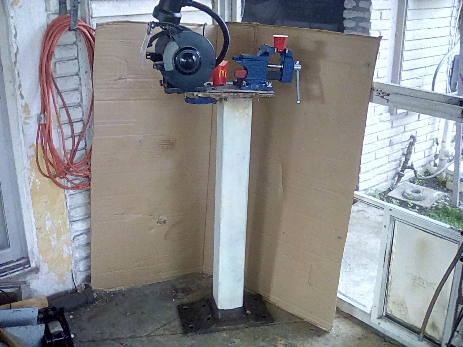

    Made this grinder stand from 2 tie plates,a piece of 4x4x.25 tube and my trusty H.F.wire welder. At 60 lbs it's surprisingly stable. Bolted all to a piece of thin sheet then bolted that thru the existing spike holes. No drilling into those plates.

    Nice Job, I have something similar with a 2-1/2 " Steel pipe stuck in a discarded 50's British Wire wheel with a plate on top with a spare Grinder / Buffer. But you gave me the Idea to add a Vice to It. Thanlks
