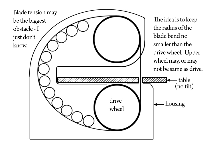

    I'll post a quick sketch of the bandsaw idea. It's actually not a three-wheeler. I saw the concept in another machine many years ago, so I'm thinking it will translate into the bandsaw. It has two main large wheels, and a bunch of small wheels in a deep arc to the back, giving it a very deep throat, but small vertical cutting height. It will be for thin material only. It is a design challenge. I keep hoping/thinking I'll run into a drawing of the idea, or someone who has already done it, since there are so many of us tinkerers in the world.

    Sketch of concept
    The only other issue I see is keeping smaller wheels cool, so I'll probably reduce the speed as much as possible and still keep a good FPM rate. Maybe someone will instantly know of such a design which I can copy. I'm pretty adept at fabricating, been doing metal and wood fab for over four decades (says Mr. Long-in-the-tooth). BTW, this is, as I assume most people view it, a labor of love. I could probably get a cheapy on craigslist and modify it, but that isn't as much fun, is it?

    Have you seen this one?
    I don't know if he ever finished it but looks like the same concept.

    No, I have not seen this one before, many thanks! It is exactly the idea, and I will be using more wheels, as he has mentioned.

    You're way more ambitious than me, I wouldn't consider taking something like this on, maybe if I was retired and had time and a machine shop on hand. As it is, my workhorse General Mfg 15" and little Sears 10" handle anything my full time business demands. It's a shame General Mfg. no longer exists. If I needed to replace mine I'd try to source an old one and refurbish it. I am working on a manual brake for my General but that's not your question. My 36+ years and thousands of serious work hours on bandsaws tell me investing in a top quality tool equals superior stability, adjustments and longevity. Life's too short to deal with aggravating problems and unless you're a precision woodworker and a tenacious problem solver I think this will be a difficult project. But others have built their own, so I'm sure it's possible. Good luck!
