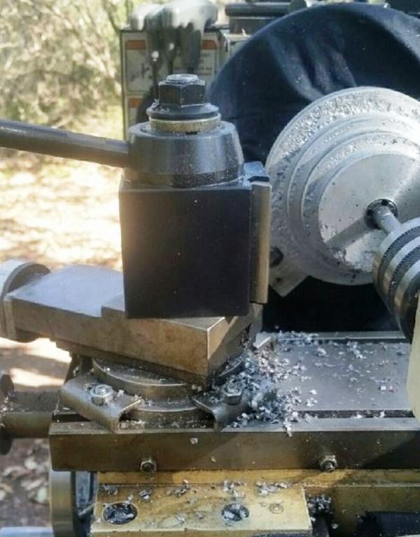

    Upgrading my lathe I bought a QCTP (quick change tool post) and it came with a base and mounting stud, however using the base will make your tools locate above center at the lowest position. The factory stud in the top of the compound is way too small and that allows the tool to wiggle under even a moderate cut. I first wanted to use the supplied stud and modify my compound for it but the threads on it were 9/16"x18 (not M15 commonly declared on the interwebs), an uncommon size that I didn't have a tap for.

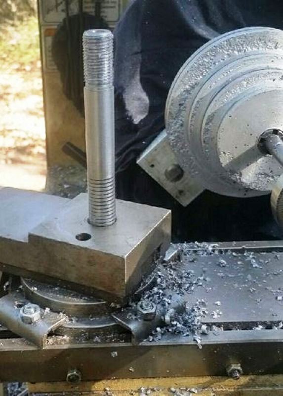

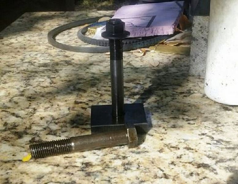

    The next larger common size was M16 but it wouldn't fit through the center of the tool post, but I bought some M16x100mm bolts any way and threaded the compound for that size since I already had a tap for that thread.
    Then I mounted the bolt between the chuck and the live center and turned all but the bottom threads down to 9/16" and single point threaded the other end to fit the supplied flange nut. Since a 100mm length would be tight with the SAE thick washer I intended to use under the flange nut I trimmed off the corners of the hex head so that when I turned the shank down I got an additional 8-10mm of stud length.
    Here's the new stud mounted into the compound using 262 Loctite (red).

    Tada! Bob's your uncle and it's much more rigid cutting now.

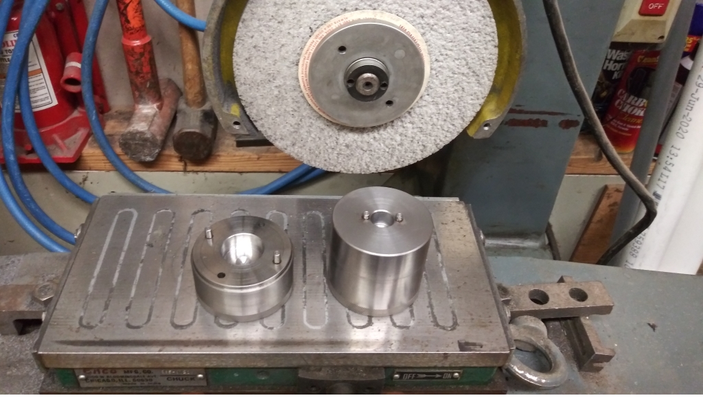

    Today I worked on the surface grinder, it came with the most useless face pin spanner wrench. It has 5mm pins. One of the pins slides in a milled slot. Very simple made from rectangular bar stock. So I made two from round bar scraps 3in diameter, about 3 inches long. I drilled out holes in the face at the correct spacing. I had 3/16" drill rod (Oil quench annealed) and used the vertical mill to space the holes accurately. I had a reamer that was 0.001 undersize and that used one of your "swing press" installations. It was looser then I thought, using a 8oz machinist hammer. I did a light knurl on the other end for easy hand grip. One is to tighten the left hand nut on the wheel hub, the other for the left hand nut holding the hub on the motor shaft.
