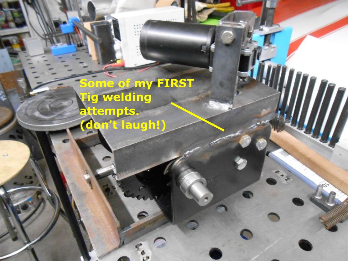

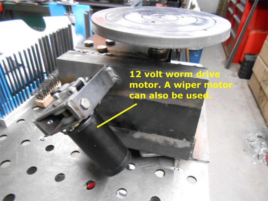

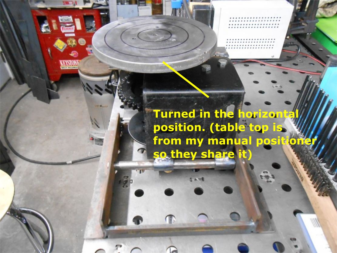

    This is my Franken-cobbled motorized weld positioning table! It's made from a Harbor Freight trailer hand winch and 12 volt worm drive motor. (a wiper motor can also be used)

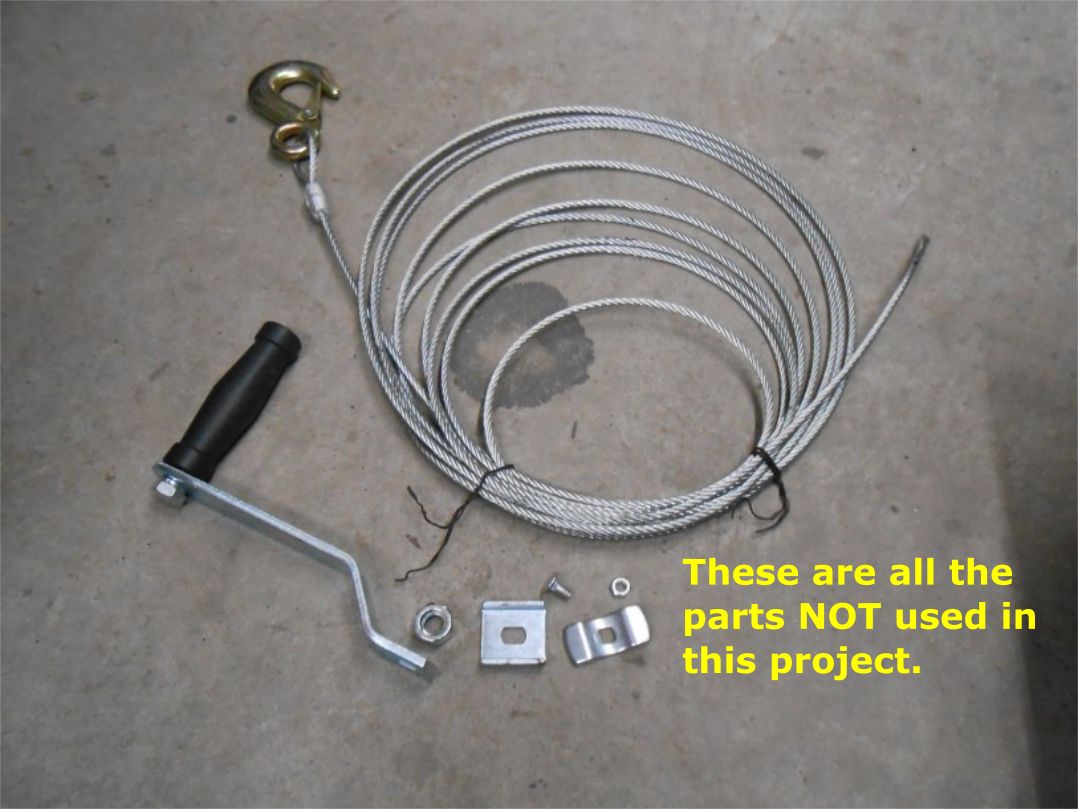

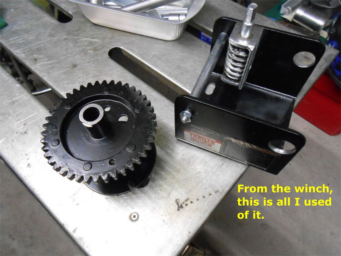

    The winch itself is NOT very useful as a winch (lol) as this has about a 40:1 ratio. You would spend most of the afternoon winching your car or boat up using this. Also, both gears are not hardened so using them to pull a heavy load would wear them out quickly! (has terrible reviews)
    It is however a GREAT starting place to build a rotary weld positioner! Just cannibalize the needed parts; worm drive, drive gear and housing and your well on your way. There are many parts left over (bonus) that can be used for future projects. (see pics)

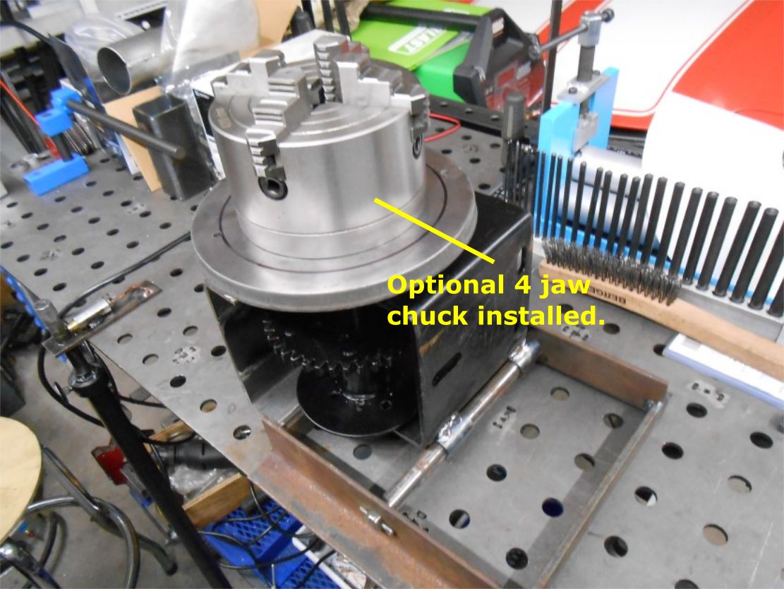

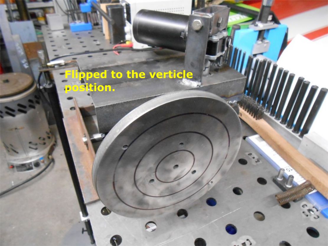

    This version features both horizontal and vertical positions. I was not going for beauty but rather function and I think I nailed it! lol Probably won't even paint this, just use it as is. (and make improvements as needed)
    I've run this from an adjustable power supply from 2 volts up to 30! You won't be welding anything at 30 volts but down around 3-3.2 volts looks about right. (have to time it yet, I heard 1/8" per second is about correct for Tig welding)
    If you want fancy, this one is not for you but if you want a cheap & functioning positioner, this fits the bill!

    Very nice, Bobs. What kind of adjustable power supply are you using and do you use a foot control?

    A good source for a motor like this is AS&S https://www.sciplus.com/car-seat-12v...-motor-49248-p

    The worm drive motor you're using is a power-seat unit and they are available all over for around $14. I use them for many things...

    Quote Originally Posted by Saltfever View Post
    I have this power supply:
    https://www.amazon.com/gp/product/B0...?ie=UTF8&psc=1
    I will need either a foot pedal or some other way of starting/stopping but so far, I haven't had time to even test it yet! lol
    They are great! I use this same motor as a hand held cross slide power feed and have another motor like this for a power X axis on my mill. Both are in my tools area on this site.

    Did you ever get this running? In particular speed control is so important in welding; what did you do for speed control?

    I've run this from an adjustable power supply like the one shown below from 2 volts up to 30! You won't be welding anything at 30 volts but down around 3-3.2 volts looks about right. (I heard 1/8" per second revolution is about correct for Tig welding)
