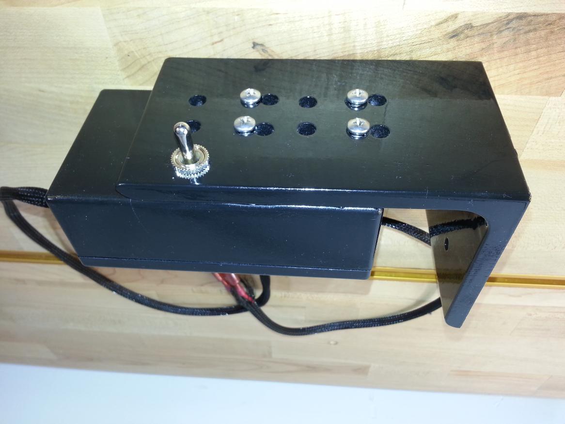

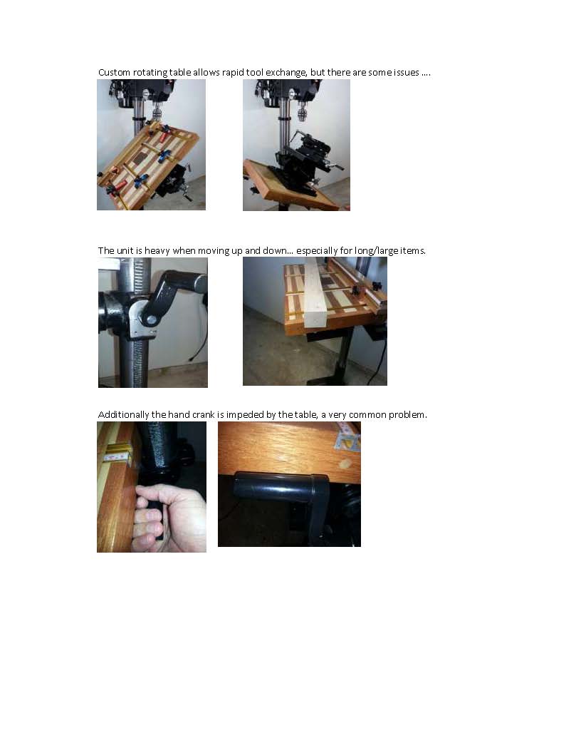

    Drill press table crank problems .... I know I'm not the only one!
    My DP table accessories are heavy.
    My custom woodworking table impedes the rotation of the crank handle.... knuckle buster!
    I routinely work large/long items, so my table lift gives me a workout.
    Given all of the advancements the DP has seen, variable speed, rapid speed change, keyless chuck, laser site, etc... The hand crank is laboriously outdated, especially on higher end machines.

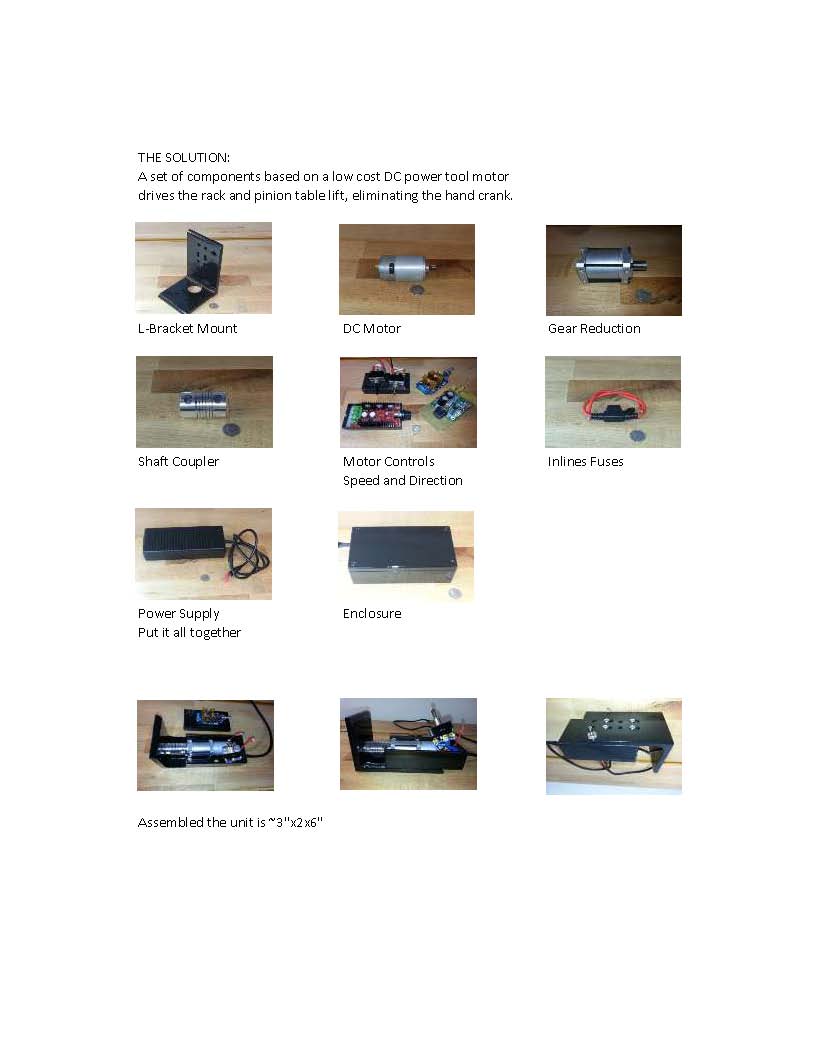

    I removed my crank handle exposing the rack and pinion drive shaft and found a way to mount a motor.
    Initial specs and estimates led to a lot of trial and error, but I found a great combo of hardware that gets the job done based on a $5 DC power tool motor.
    Parts include:
    Aluminum L bracket for mount
    Small high RPM DC motor with cooling fan
    3 stage gear reduction
    Drive shaft coupler
    Mechanical and logical motor controls for speed direction
    AC to DC power converter/supply
    Inline fuse protection
    Mounting hardware
    Cable management
    Motor enclosure
    Install requires: drill, metal bits, taps, screw driver, allen wrench
    Take a look at the video .... Very straight forward operation. Easy up, easy down!
    I've also added some photos.

    Cost
    Quote Originally Posted by DIYer View Post
    Cool mod. About how much did this cost you in parts?
    Thanks.
    The first prototype cost me less than $100. I had some of the minor supplies lying around.
    I am building a right angle lower profile unit now and my target is to build it for ~$50.
    It could be done for less, but I am building this to be able to move over 100 lbs. So it may be a little over engineered for a standard DP table weight.
