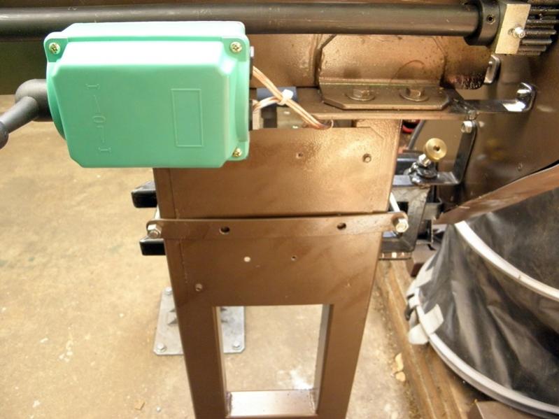

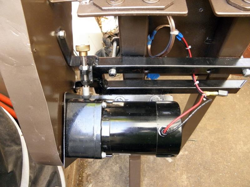

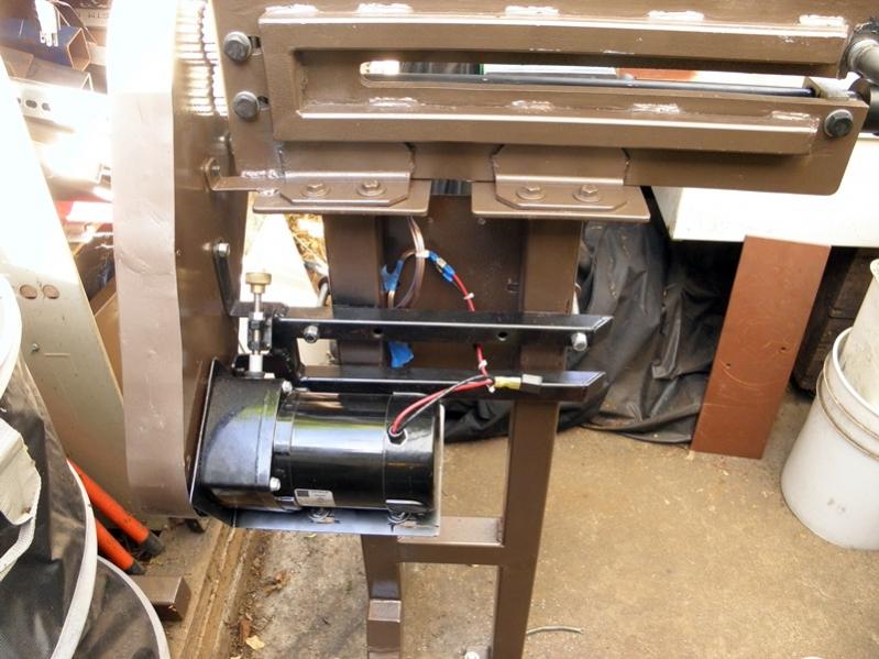

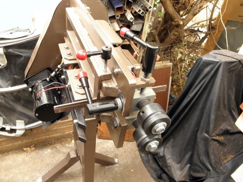

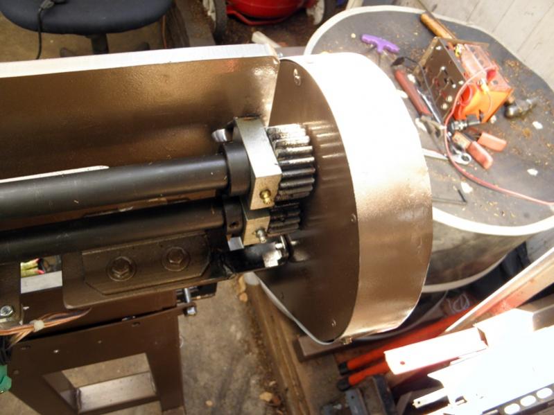

    Motorized Bead Roller with Stand with chain guard.
    Motor is a 12v DC gear head motor 41 rpm and a #35 chain and two sprockets 10 tooth and a 62 tooth.
    gives me 6 rpm. a little slow but beats doing it by hand. motor e-bay $55.00 sprockets e-bay $30.00,
    120 to 12 v dc 30 amp power power supply e-bay 25.00 waiting for it now Switch 12.50 . I will put a smaller sprocket on it later. :O) see tips tricks for for-rev switch diagram.

    For this project, how long did it take to get is up and running?

    Thanks for the spec details for the motor and driving hardware. I too like sourcing through eBay and especially the "Buy It Now" selections (and many with free shipping).

    Hi DIYer. Three weeks at 5 hrs a day. Also see switch wiring diagram on tips and tricks forum. Hi Paul where in ca. are you from?
