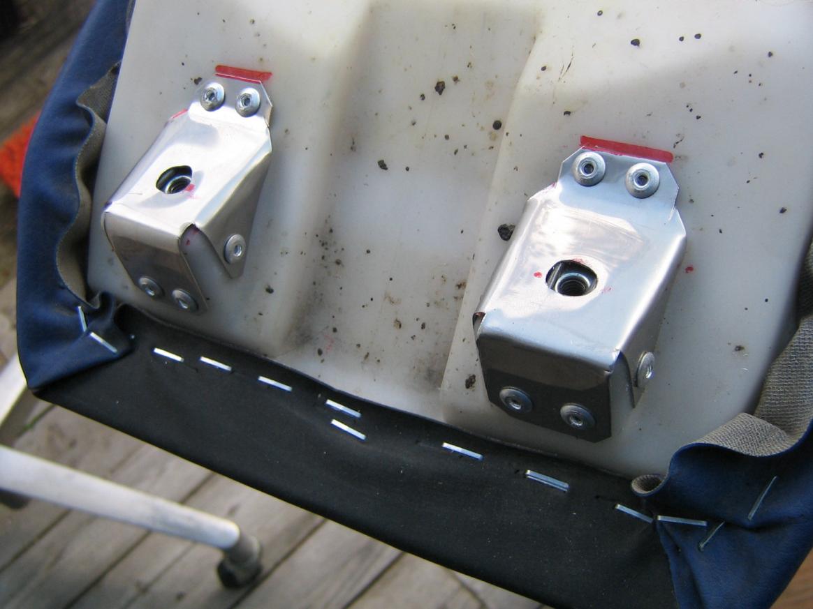

    Motorcycle seat mount repair
    If you own a Yamaha XT600 with seat mount problems this is one method of repair, using
    stainless sheet metal to retain the nuts in the seat base. click the link for more.

    Good job on that seat base. Look pretty solid!
