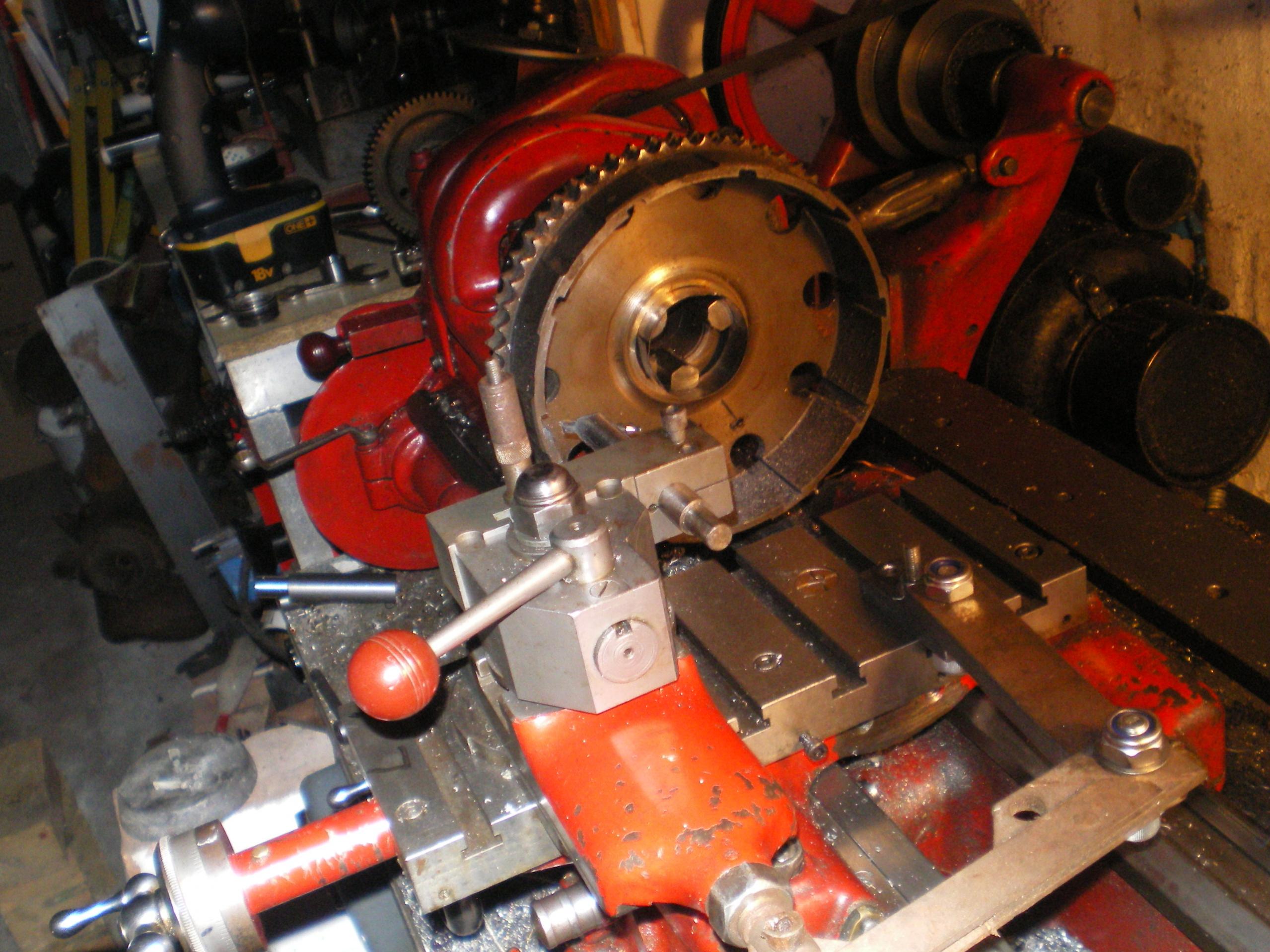

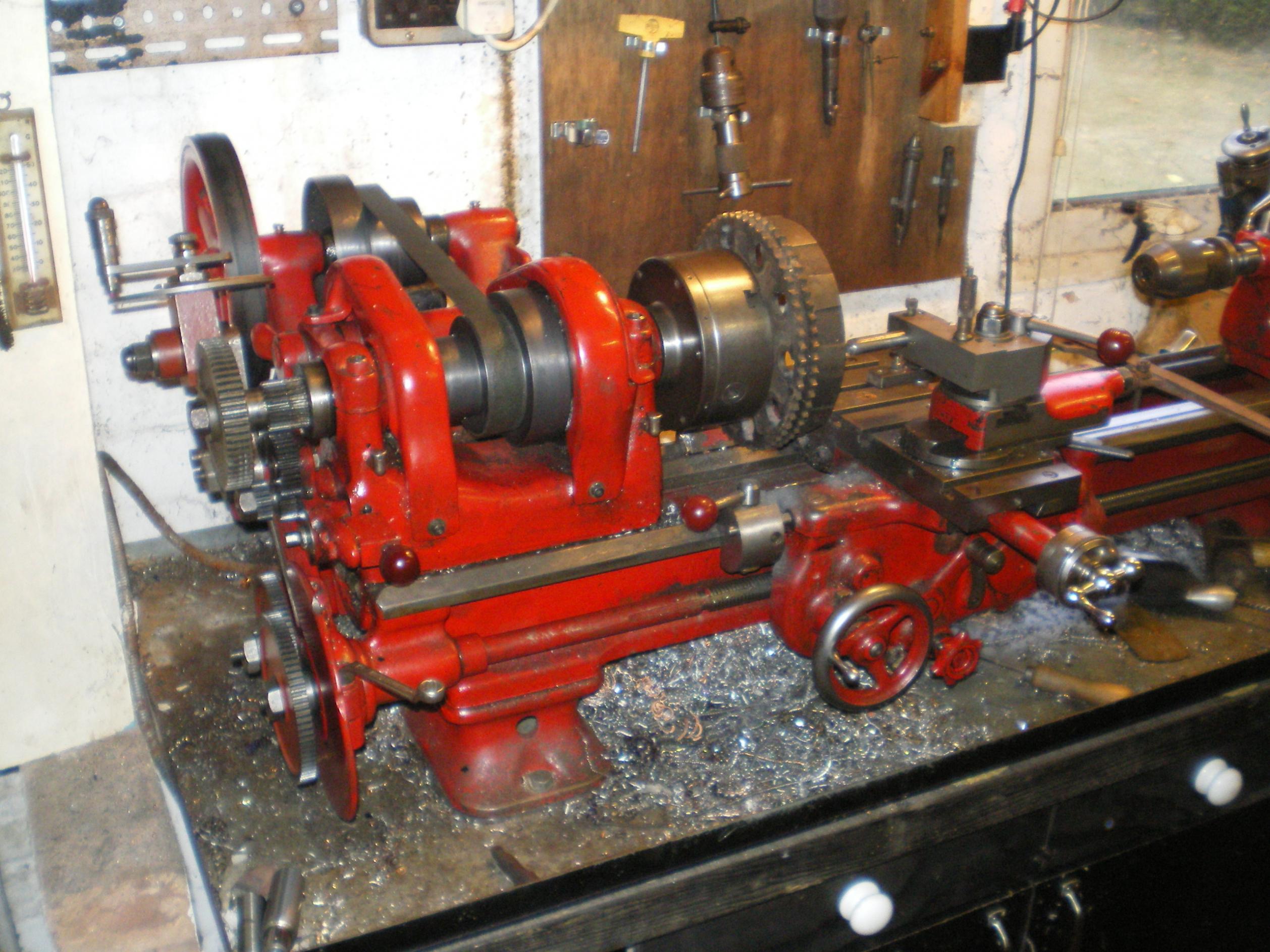

    I had a clutch basket that had become notched but was otherwise ok, tooth and bearing track wear was minimal so I decided to try and reclaim it and keep as a spare (nothing to loose).
    The width of the slots is not critical as long as they are smooth so I planed out the wear in the lathe.
    I used the topslide as a hand operated ram which has worked well in the past for keyways etc and with a suitable tool in a boring bar and indexed it turned out well.
    This was actually done on a faceplate but I forgot to take photos at the time so I mocked it up again in the chuck as an after thought.
    This is maybe not best approach for easily replaceable parts but this was done as an exercise for when there is no option, and anyway I can never throw anything away.
    I have made many things in the past but never thought to record them until joining HMT.

    Dan,
    Nice one, but widening the slots creates more backlash which can lead to a roughness, particularly in traffic when you are varying the throttle opening. This will also accelerate wear, but I guess that doesn't matter if the alternative is junking the basket.
    You are a man after my own heart, I never throw anything away either.

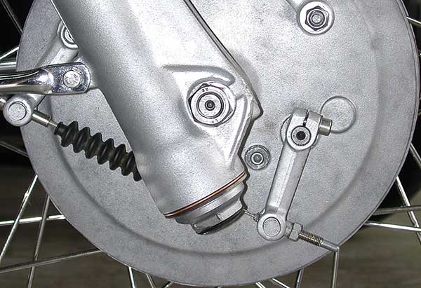

    I found some pix of the BMW drum brake activation.
    You can see the outer cable connected to the left side lever and the inner cable connected as usual to the inner cable

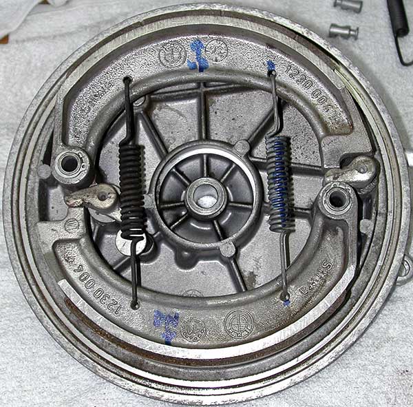

    Here you can see the BMW solution, which I had forgotten, to the problem that I mentioned of slightly different leverage of the cam on each shoe. Basically they offset one of the cams from the usual position. to ensure that the cam contact point on each shoe was the same.
    There is some other cleverness in there also. With this cable on each lever system all the springs do is pull the shoes closer relative to each other so one shoe may be pulled away from the drum while the other is left rubbing. The solution adopted was to have one spring stronger than the other and have an adjustable shoe stop. So the stronger spring would pull one shoe onto the stop so it couldn't withdraw any more and then the other shoe would be pulled back until stopped by the cable adjustment in normal fashion. In my opinion all DLS brakes should be done that way.

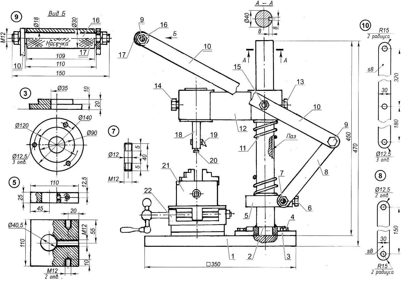

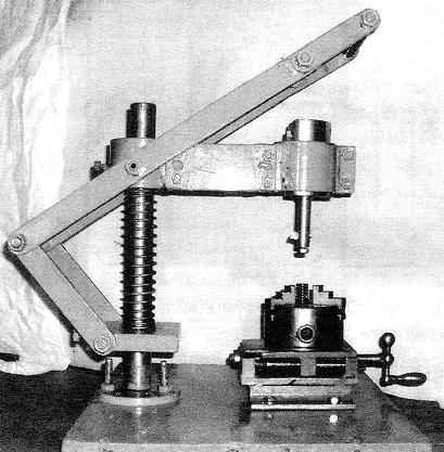

    Simple manual slotting device.
    I just came across a couple of pix of a manual stand alone slotter. I have no other details but the pix are detailed enough for anyone who would want to build something like it.

    I have been wondering about building a slotting/line scribing gadget mounted on my lathe. Any advantages of a stand alone over a lathe mounted ?

    Quote Originally Posted by steamingbill View Post
    My order of preference would be like this:
    1. Dedicated factory made machine tool for slotting.
    2. Factory made slotting head attachment for a milling machine.
    3. DIY made slotting head attachment for a milling machine. (This my method.)
    4. DIY made slotting fixture for a lathe.
    5. DIY made standalone device as in my post above.
    For single pass cutting like scribing markings on a dial it would be hard to beat a lathe with indexing. There are several versions of the technique in past posts on this forum.
