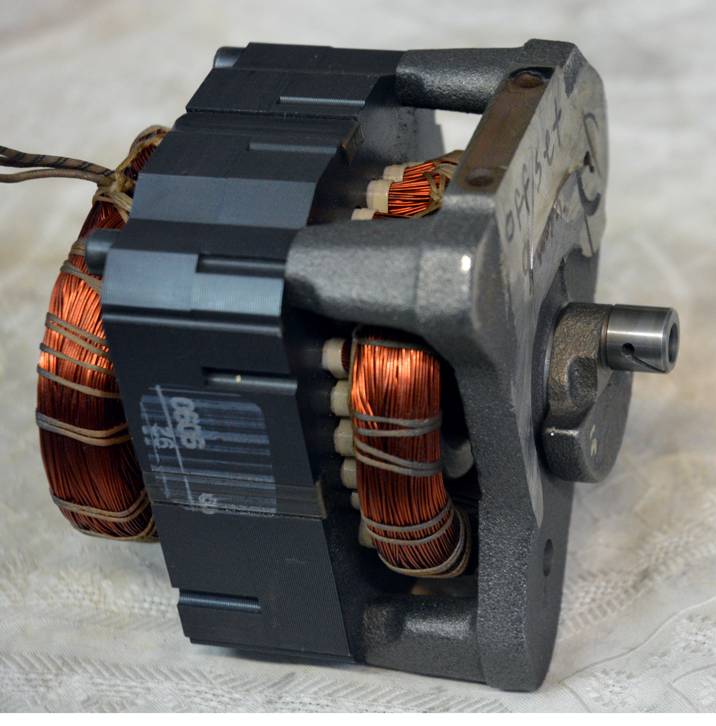

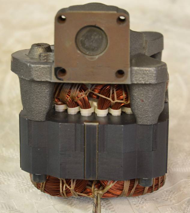

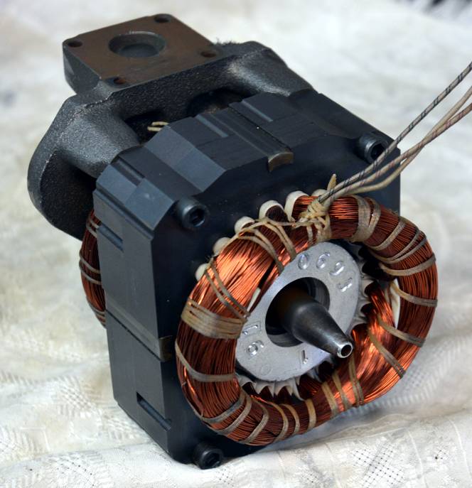

    Recently Sam posted about using a Fridge compressor as a vacumn pump at http://www.homemadetools.net/forum/h...ht=vacuum+pump
    As well as these units being useful as they are, they contain nice little induction motors which can be useful in their own right.
    More on fridge motors/compressors.-fridgemotor01.jpg More on fridge motors/compressors.-fridgemotor02.jpg Click on thumbnails for full size.
    More on fridge motors/compressors.-fridgemotor03.jpg More on fridge motors/compressors.-fridgemotor04.jpg

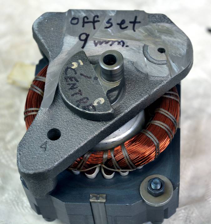

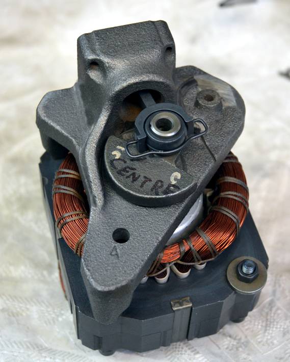

    These pix show the motor with the pumping cylinder cast into the bearing housing. Note that the rotor is only supported in bearings at one end. The output shaft has a single sided crank to drive the piston. The other end of the shaft is extended and is tapered. It was a while ago when I extracted this motor from its case and I don't recall if that shaft and taper had any function. I don't think so and its existence is a mystery to me.

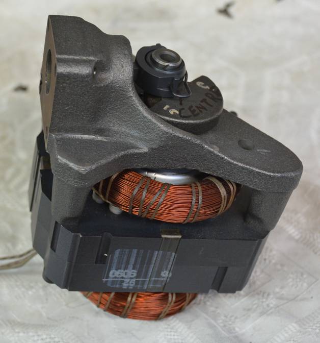

    I had a project for a motor with a crank on (that is for a later posting here) so I cut the pump part off as shown below. That end face was milled flat for mounting.

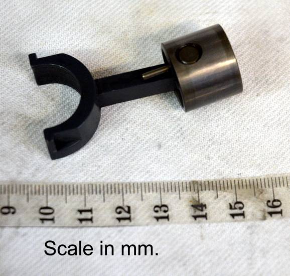

    More on fridge motors/compressors.-fridgemotor05.jpg More on fridge motors/compressors.-fridgemotor06.jpg
    Here is the tiny piston and conrod. the piston and its cylinder are both made in grey cast iron and so are very much self lubricating. When I used this as a vacumn pump I never added any oil which is contrary to the advice given in the previous post. When I extracted the motor and removed the piston there was NO sign of any wear. The crank is also made in CI and there was no wear on that either.
    I believe that taper, is an oil pump, it rotates in the sump of oil, and centrifugal forces of the oil in the hollow shaft brings the oil to the top of the hollow crank shaft, where it slings out to lube the con rod via an oil gallery, and the piston.
    I checked mine and can confirm the truth in the quote, except that it is not the taper that is the pump, it is the eccentric nature of the crank that is effectively the pump.

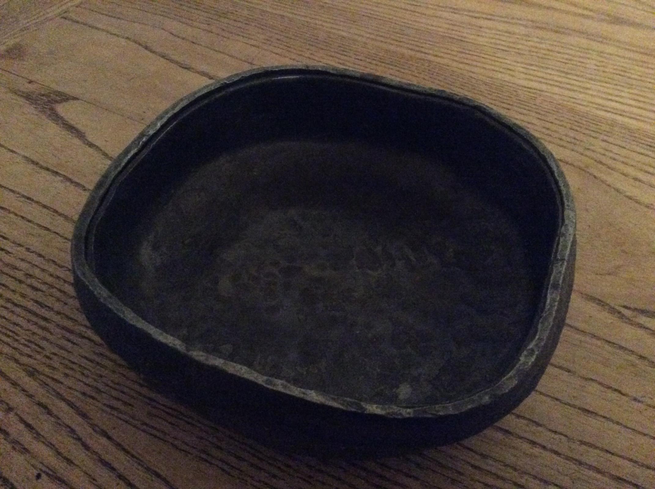

    More on fridge motors/compressors.-e42079d7-48a9-41e7-b8b0-03c04205dfd8.jpg
    This is the OUTSIDE! (Modified.) ( Modified by heating and beating it a bit) Bloody awful job getting that motor out.
  13. #9
    Supporting Member madokie's Avatar
    Oct 2017
    165
    Thanked 54 Times in 47 Posts
    oh its not that bad,i scrap these all the time,,just use a 4 1/2 inch angle grinder with a thin black aluminum /oxide cutoff wheel, let the wheel cut at its own pace,try to use a 1/4-3/8 length of the wheel to do the cutting instead of the side of wheel which is 1/16 and wheel will last longer,.cut off the top, drain the oil inside , and dissasemble,,,dont use those diamond wheels for anything but thin guage sheet steel,,they will load up with AL, brass, copper and even steel and then be useless,,the diamond wheels like to skid all over ,making it hard to get a cut started,,the AL/ox wheel will dig right in,, i buy the cheapest ones off e-bay,, 50 f 25$...040-.045 thick, the dewalt one that LOWES sells are .055-.060 thick, made in canada or europe,they do last longer and are less apt to break while using, but cost 3 -4 times my 50 cent ones,yet only last twice as long,,be carefull and the cheap thin ones work just fine...ALWAYS USE A GUARD !!!!!!! ALWAYS WEAR SAFETY GLASSES !!!!!! #1 scrap copper is up to $2.95 a pound !!!!! WOHOOO!!!!!!
