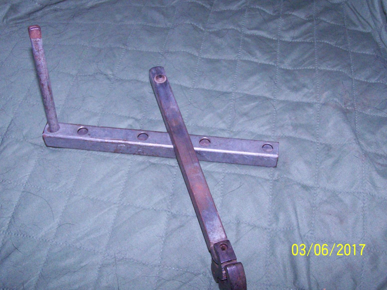

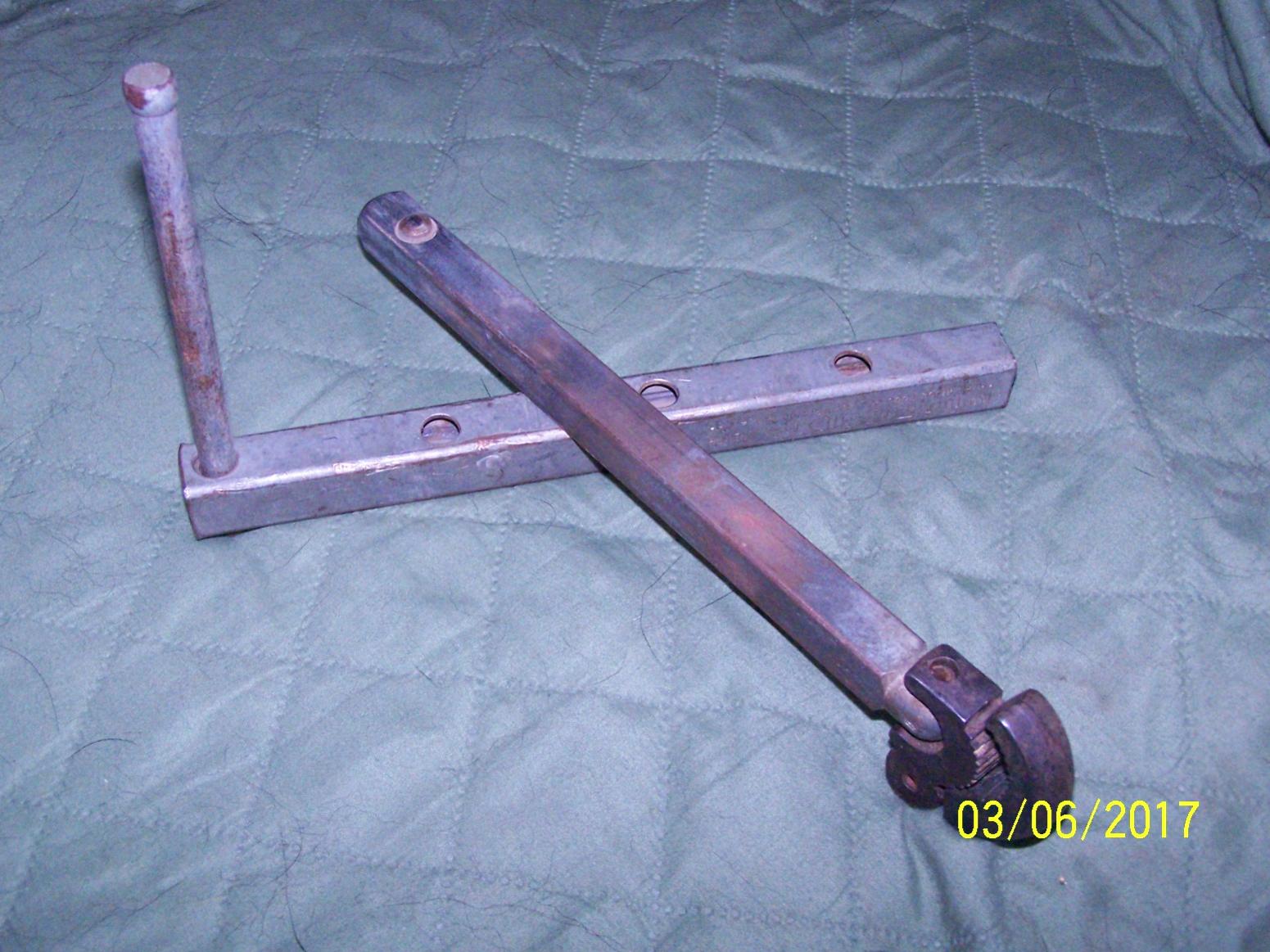

    Friday last; faucet replacement. Predicament was dependable 35 yr old faucet/basin wrench impeded by undersink hardware and lack of universal joints in elbow/ shoulder. This model 1017 had four adjustments, 10" to 17" in 2 5/16" increments. Holes receive spring loaded detent pin. Neither 12 5/16" or 14 5/8" lengths allowed the jaws to reach AND loosen faucet fittings.
    Maintain same spacing offset by half, drill 3 additional holes opposite face of 4 original locations.
    more adjustments; Basin Wrench-basin_wrench1.jpg more adjustments; Basin Wrench-basin_wrench2.jpg
    Used original hole to duplicate centerline, flipped the sleeve 180 degrees, centerpunch and drill as described. New effective intervals are 1 5/32". Didn't take 15 minutes, and saved extensive anger-tinged vocabulary for later.
