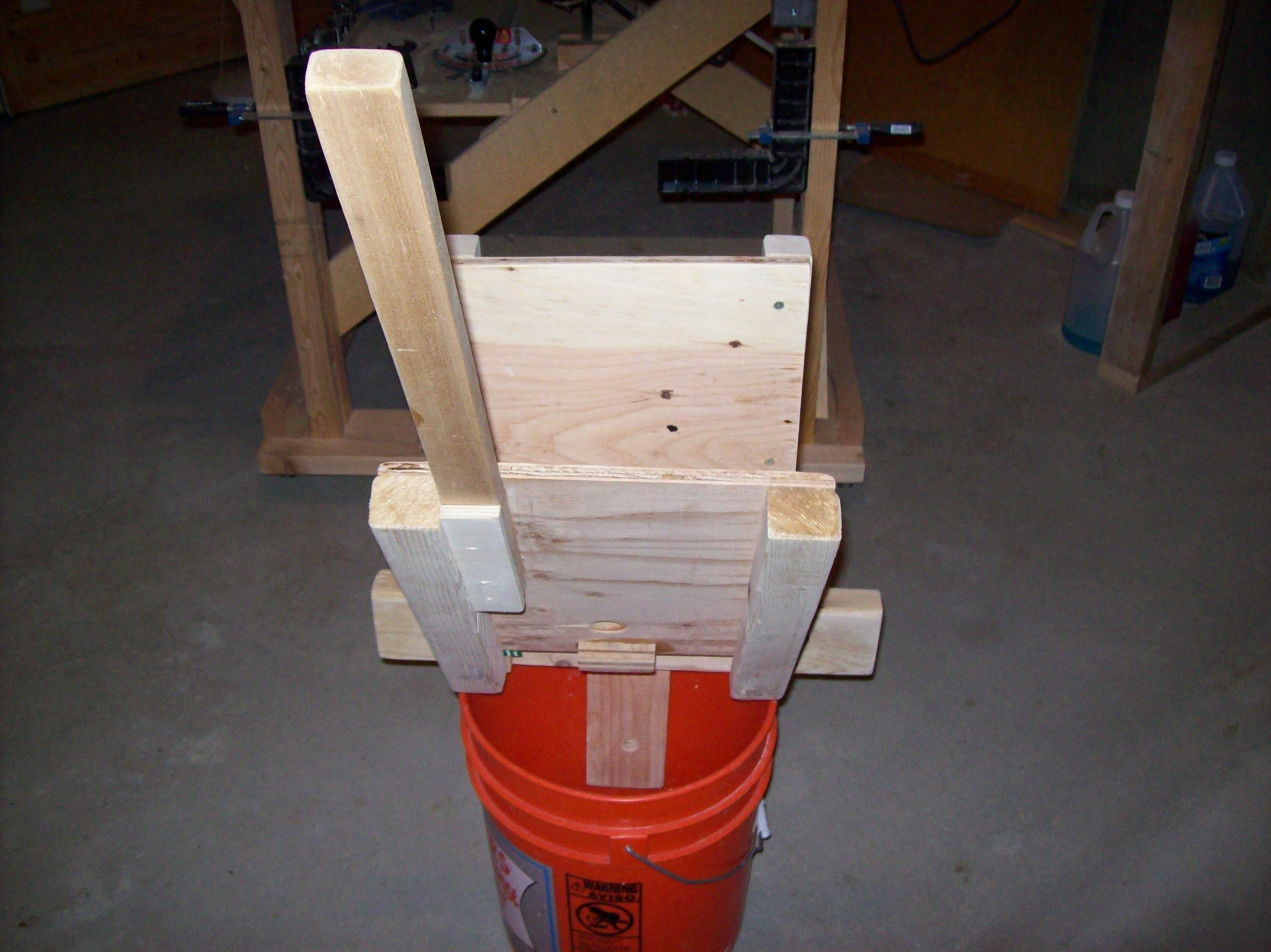

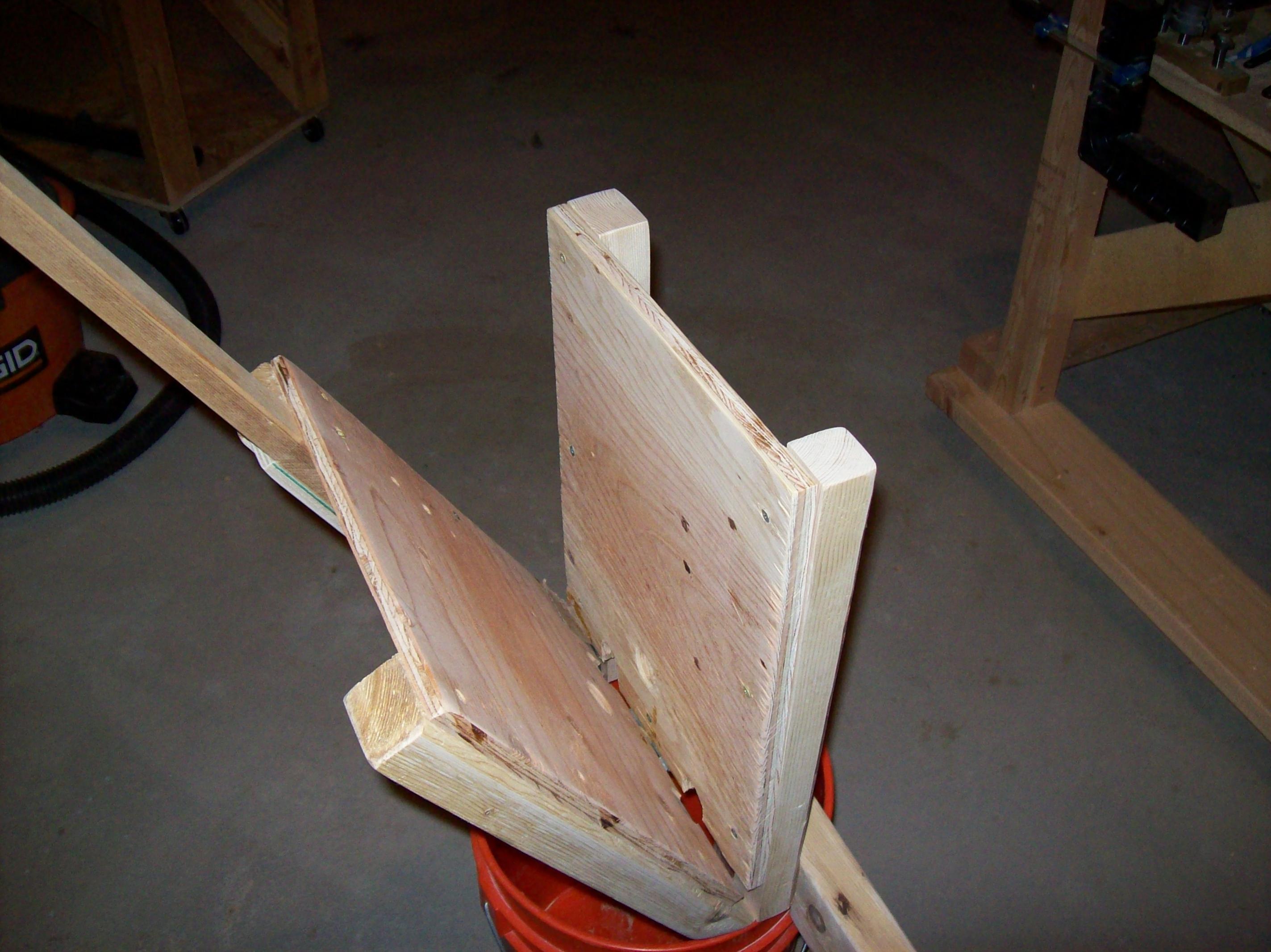

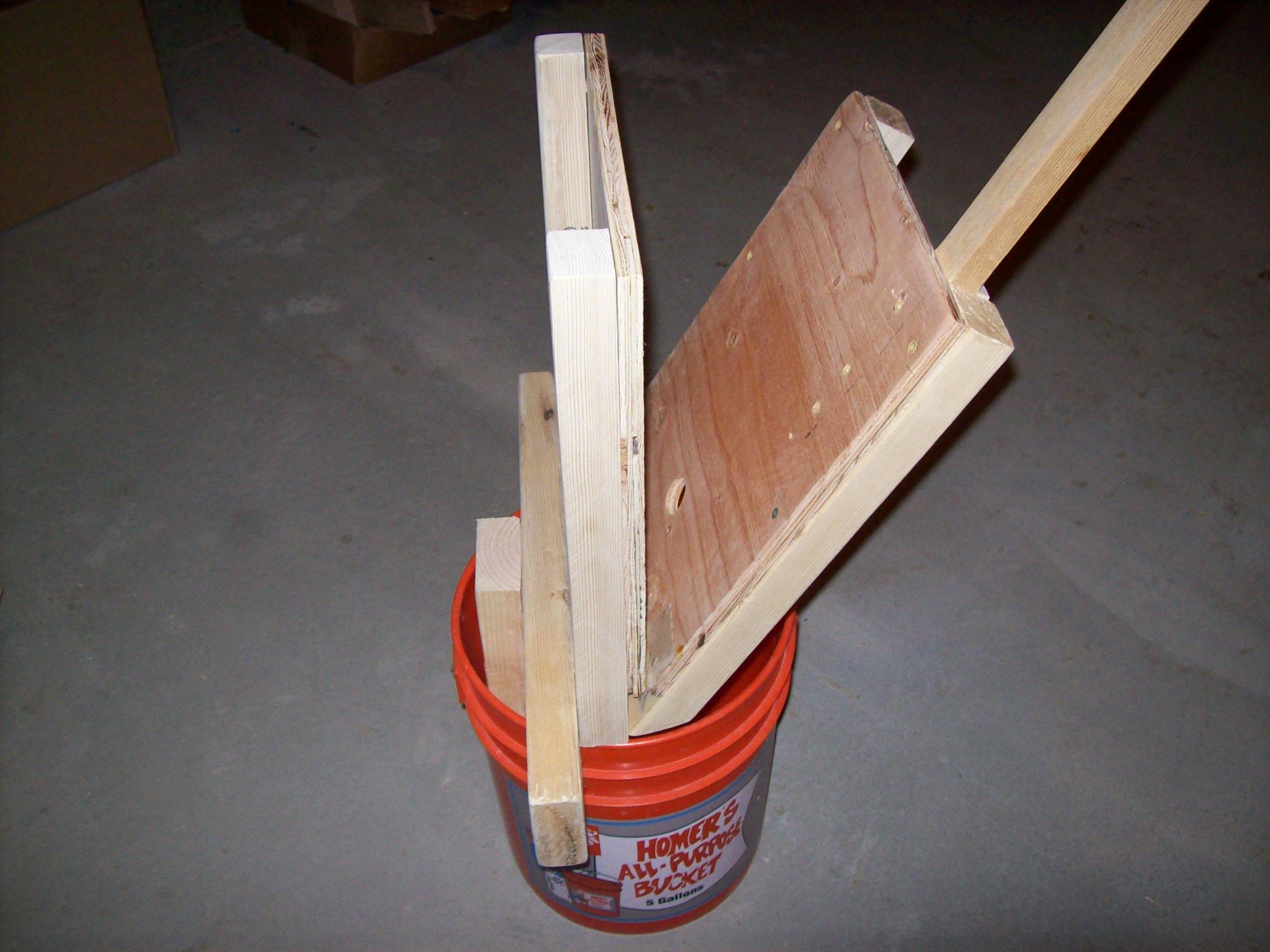

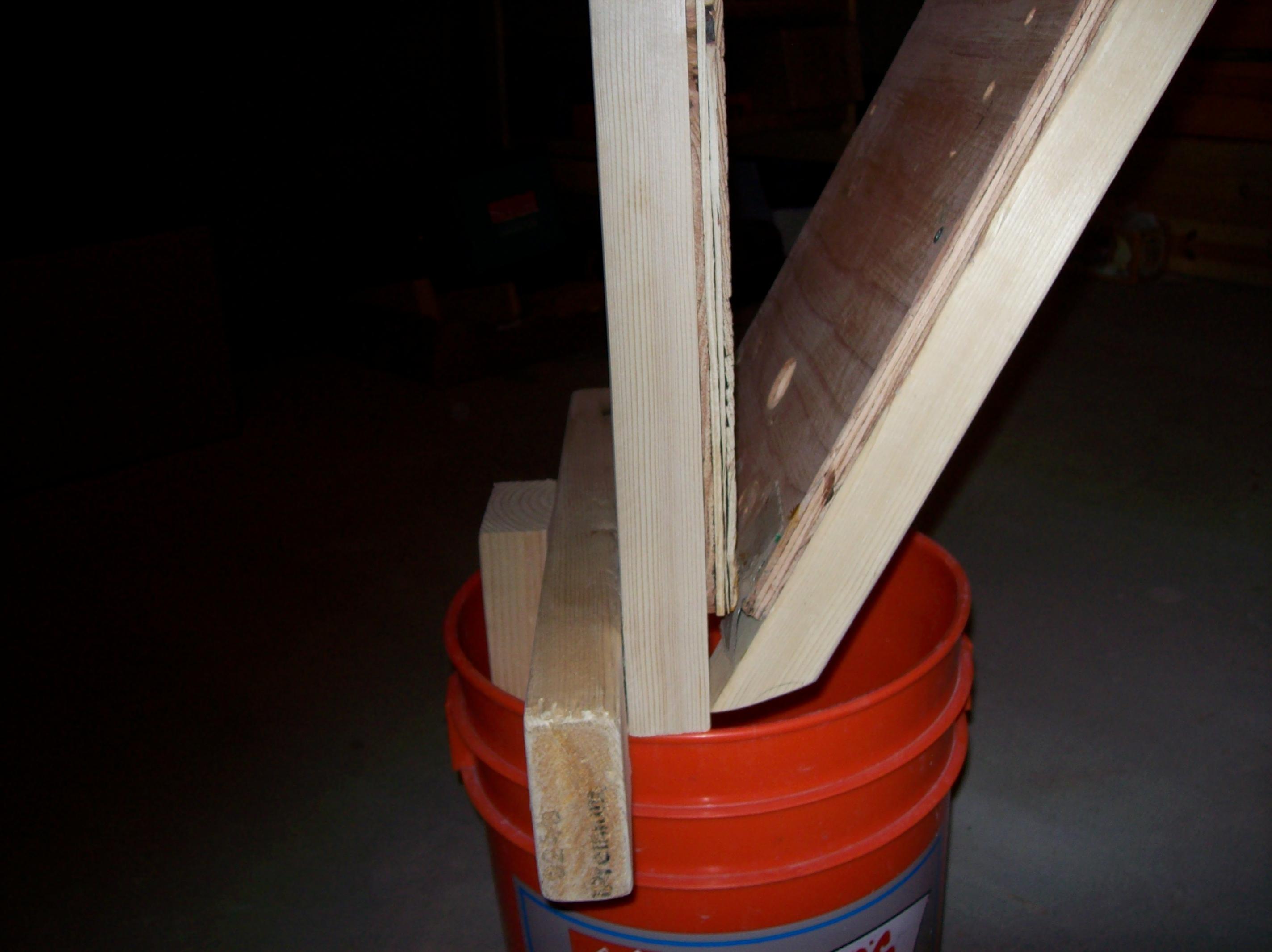

    this simple mop wringer saved me 40 bucks. Its all wood and just uses a door hinge to pivot. It sits on a 5 ga bucket by a crosspiece with notches in it.Drill holes in the plywood to drain the water. The handle is long for leverage. 2 hours build time.
