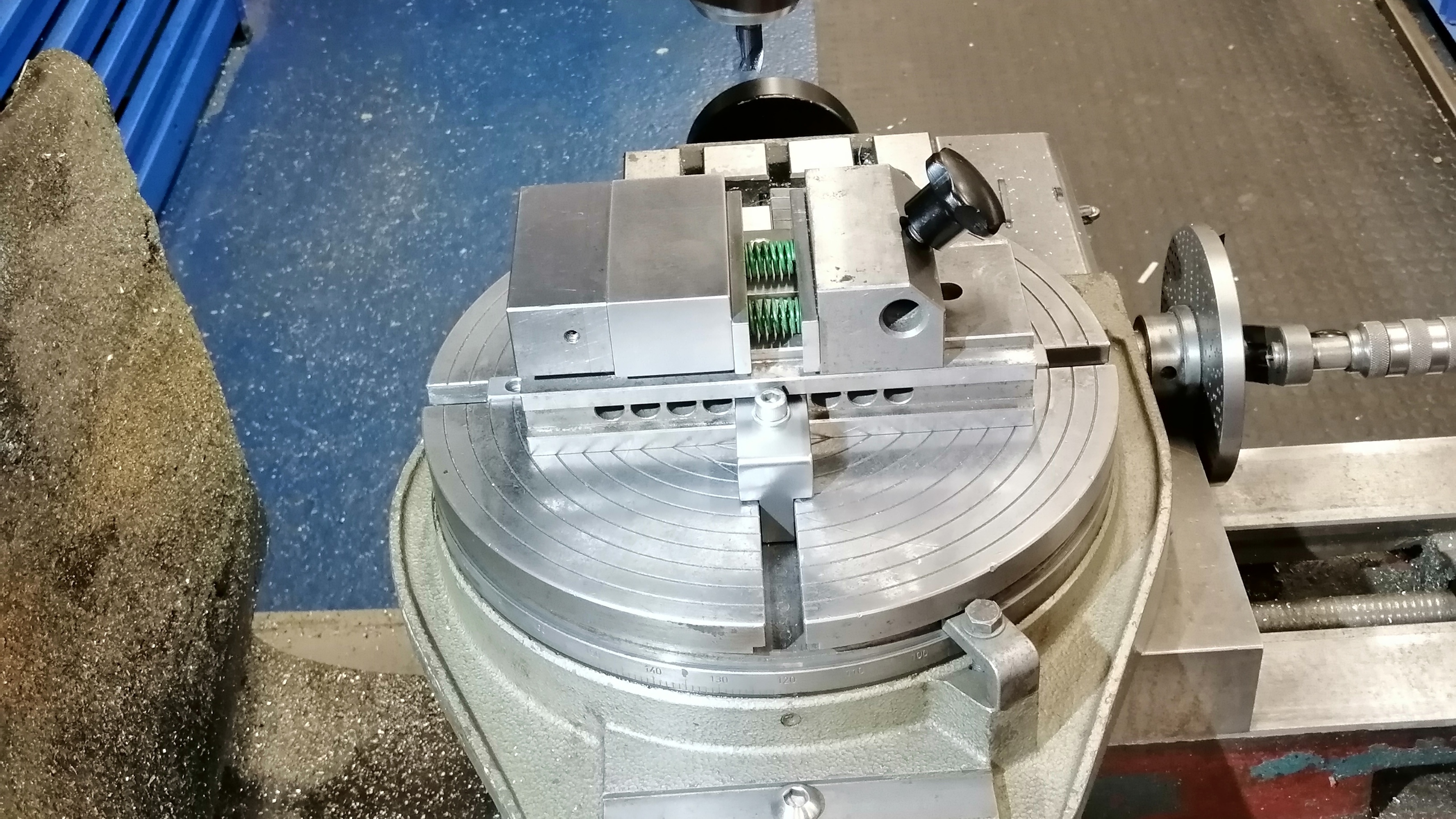

    I have similar vise clamps but have reduced the width of the heel to go into the tee slot & lengthened the heel to seat at the bottom of the tee slot. I find it helps keep the clamp square and does not damage the bed.
    I would really like to see the clamps removed from the RT. I like the idea of a long T-nut.
    Thanks for posting this version.

    Hi Mook
    Thank you for sharing your clamps I like the idea of clamping the vice to a rotary table.
    The clamps l made are aluminium and hopefully the machine table is always wiped down clean to prevent any damage to the table. The reason I made the clamps this way also allows for the vice to be clamped at any angle on the table once the tee slot dogs are removed. This obviously would not be an issue if like yourself the vice is clamped to a rotary table.

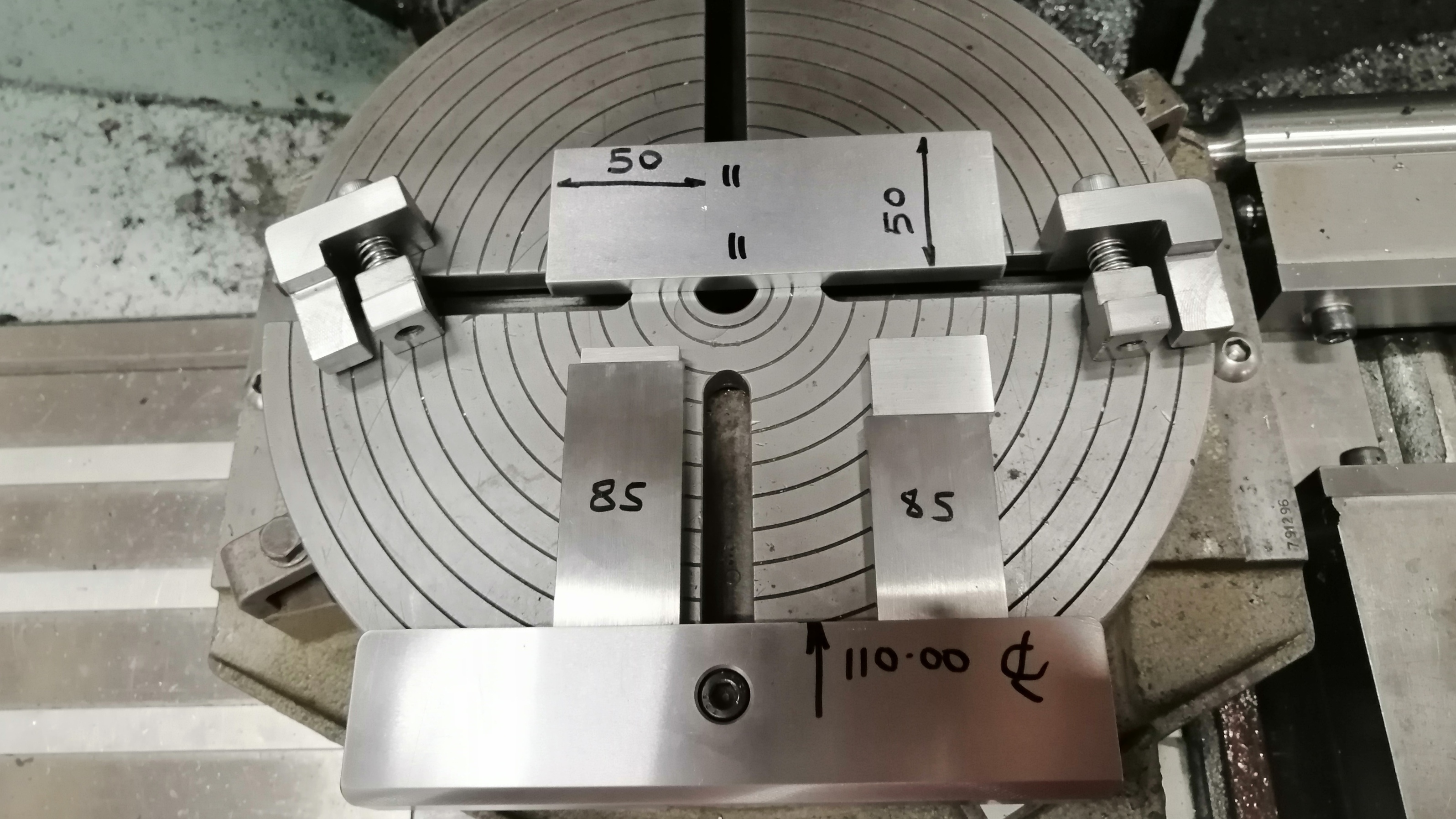

    Here is an image of the clamps removed. They are part of a total system for quick and easy setting of the rotary table and toolmakers vise.
    I have a few videos on my channel showing the various uses of the system. If you want the links please let me know.
