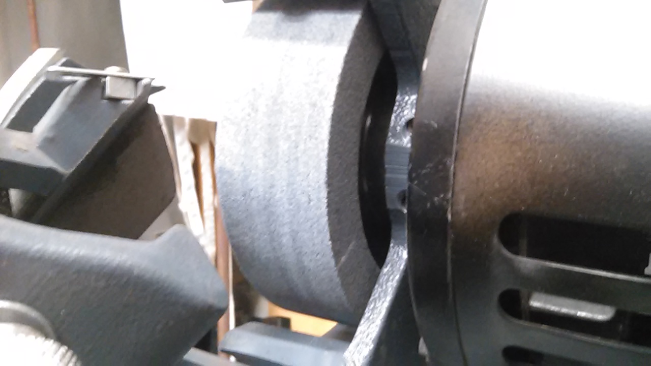

    So I started with a spacer so the wheel would not rub on the machine casting.
    Modify spindle of Lisle 91000 drill sharpener to hold larger grinding wheel-img_20200210_211916.jpg

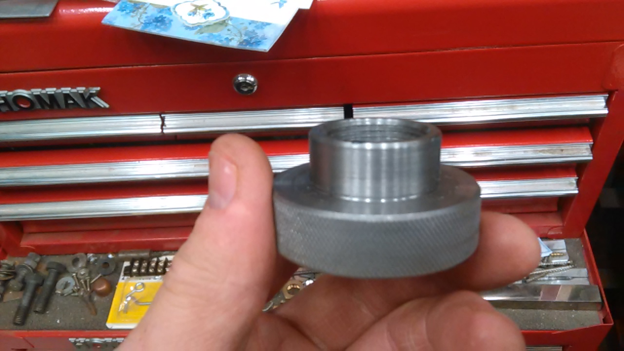

    The wheel is for a 1-1/4inch arbor diameter, so I made the nut holding the wheel to also keep it concentric to this;
    Modify spindle of Lisle 91000 drill sharpener to hold larger grinding wheel-img_20200210_212029.jpg

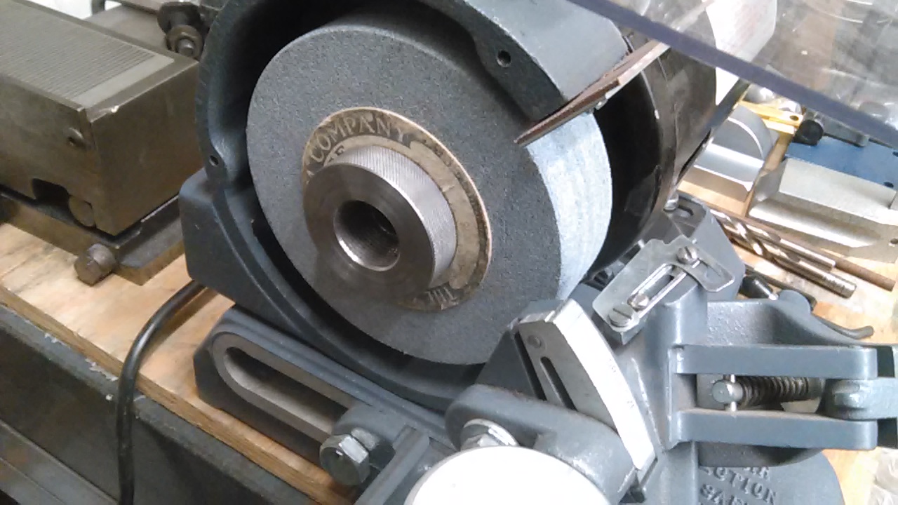

    The OD of this nut is 1.250 to fit the ID hole of the stone.
    Modify spindle of Lisle 91000 drill sharpener to hold larger grinding wheel-img_20200210_212018.jpg

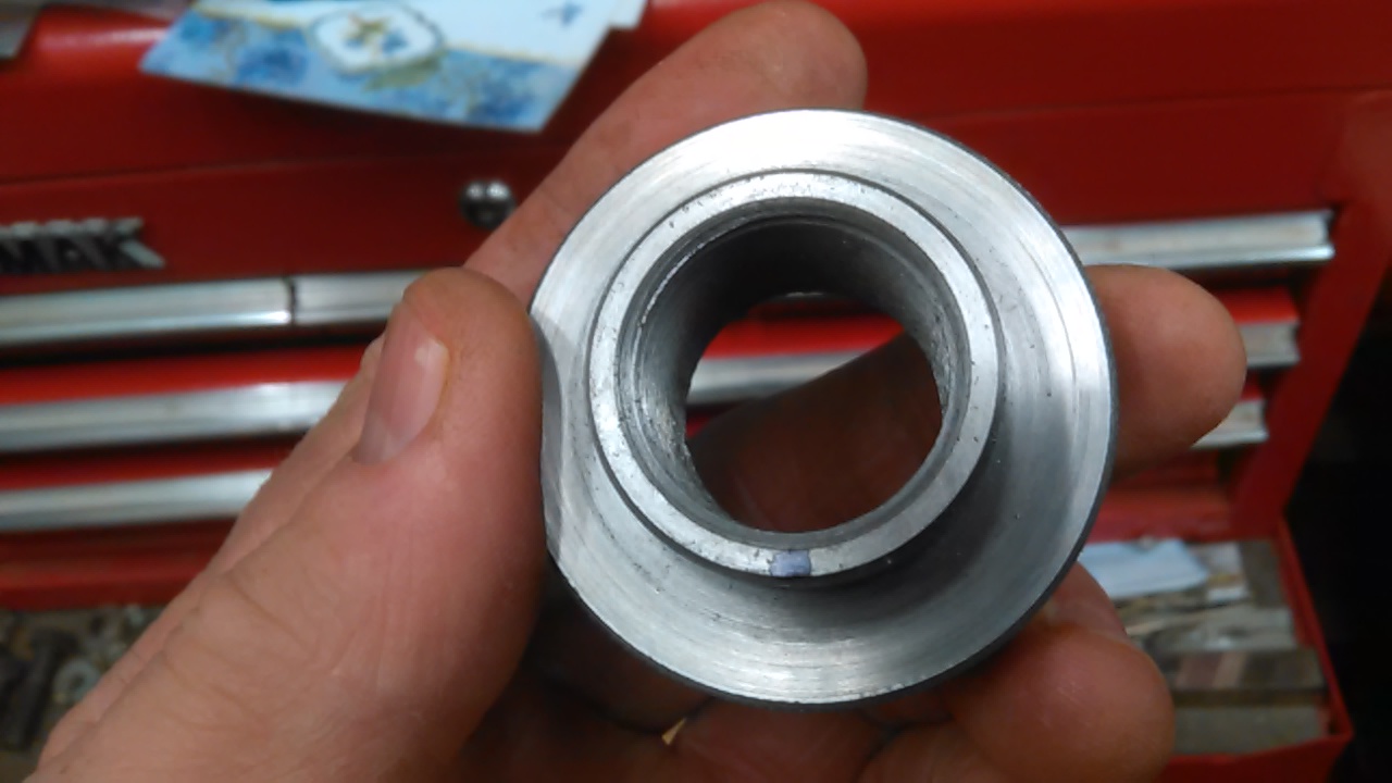

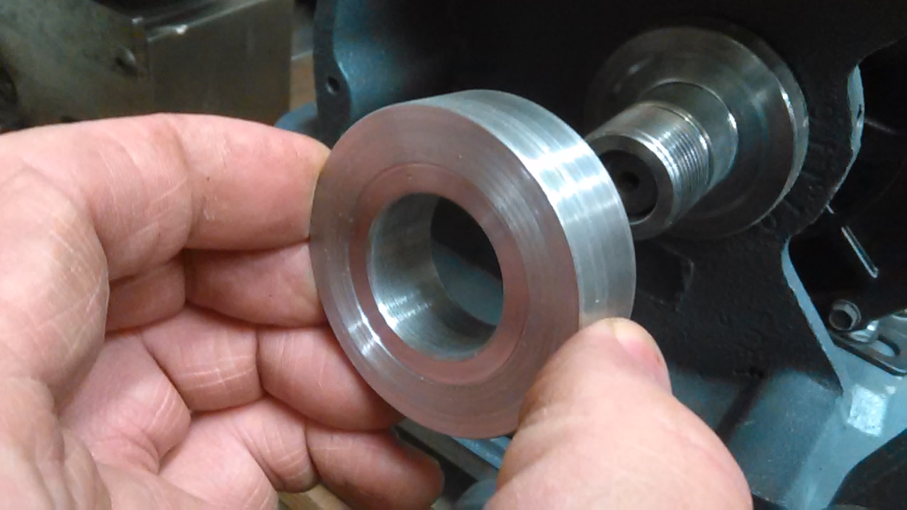

    It was fun figuring out the left hand thread, and what the bore ID had to be for this.
    Modify spindle of Lisle 91000 drill sharpener to hold larger grinding wheel-img_20200210_211611.jpg
    Modify spindle of Lisle 91000 drill sharpener to hold larger grinding wheel-img_20200210_211636.jpg
    Modify spindle of Lisle 91000 drill sharpener to hold larger grinding wheel-img_20200210_211656.jpg

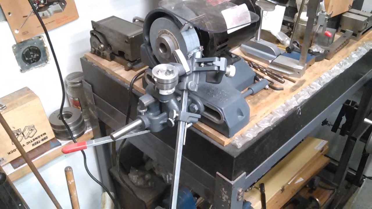

    I was able to sharpen a 1-1/2 bit. The only issue with this sharpener is that the bit holder is adjusted for each different diameter of the bit. And 1-1/8 was its intended maximum size.
