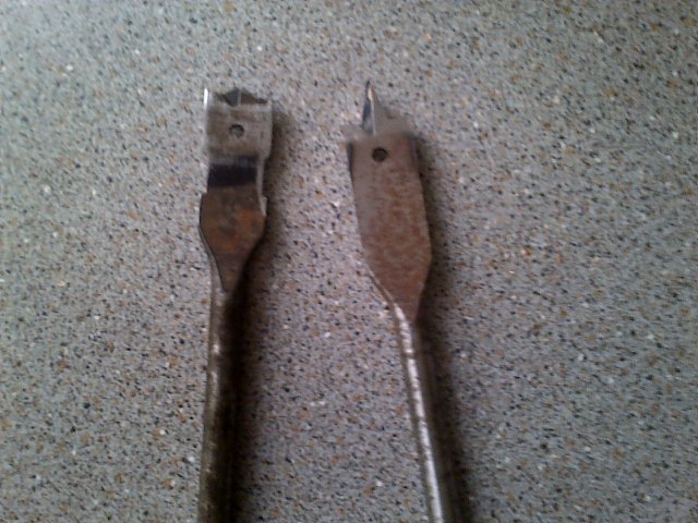

    got to build some new vivs for my snakes and want to make them flat pack as easier to get from shop into house.
    got a box load of camloc fittings rom various flat pack stuff ive dismantled in past.
    so had to modify some spade bits for it.
    started with some 16mm bits that i turned down o 15.1mm then on second one i ground of point and turned notch part way up easy visual guide for depth.
    Attached Thumbnails Attached Thumbnails modified spade bits for camlocs-camloc.jpg
