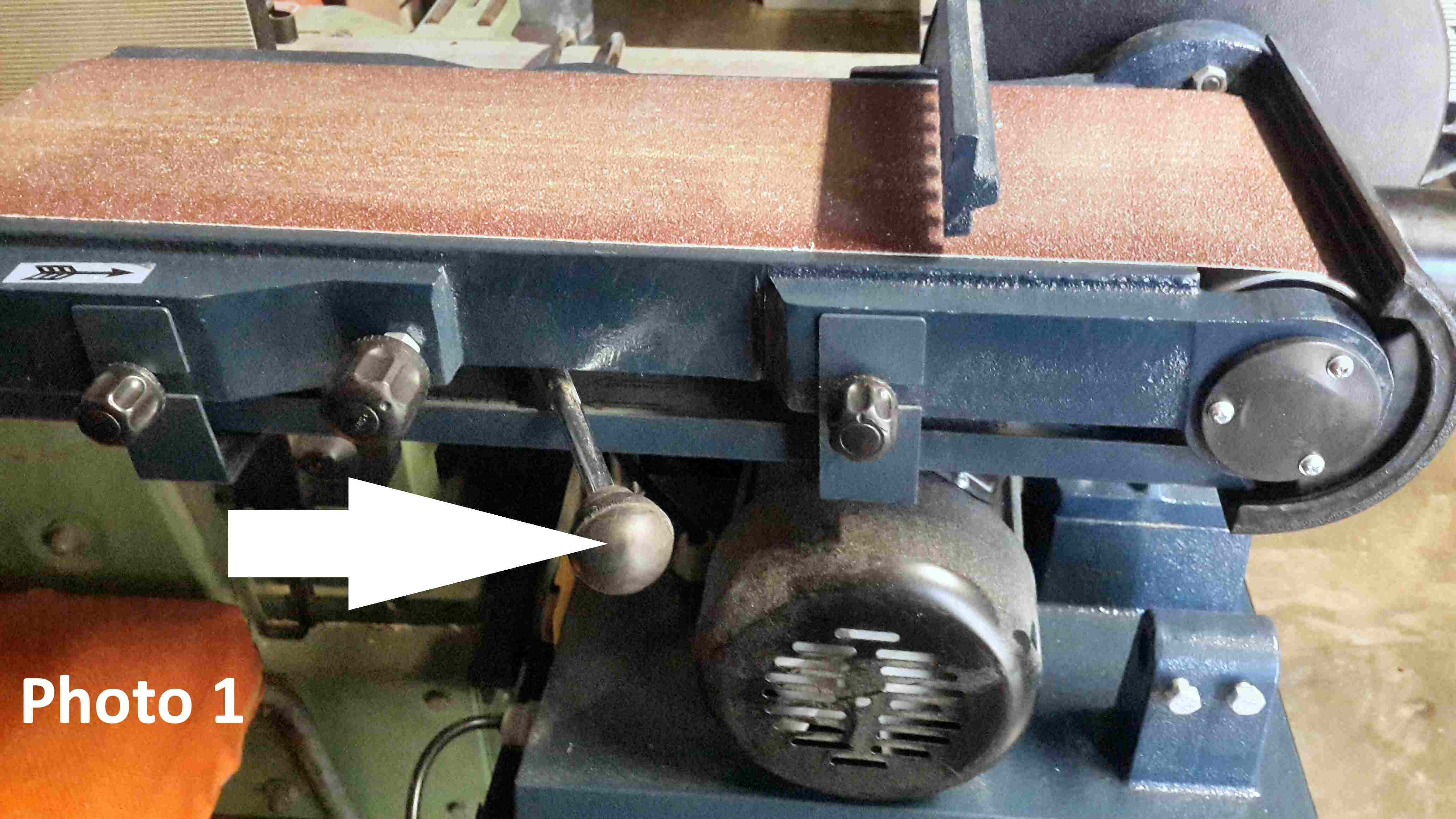

    I recently acquired a combination disk/belt sander of Eastern manufacture. One of the plus points of the tool is the quick release tension lever used when changing belts (Photo 1). Other models require a tedious process involving adjusting tension and re-tracking the belt every time you change belts. Unfortunately the roller guard/dust port, which needs to be removed when changing belts, is affixed with four M4 screws (one on the left-hand side and three on the right-hand side), which have to be unscrewed every time you change belts.

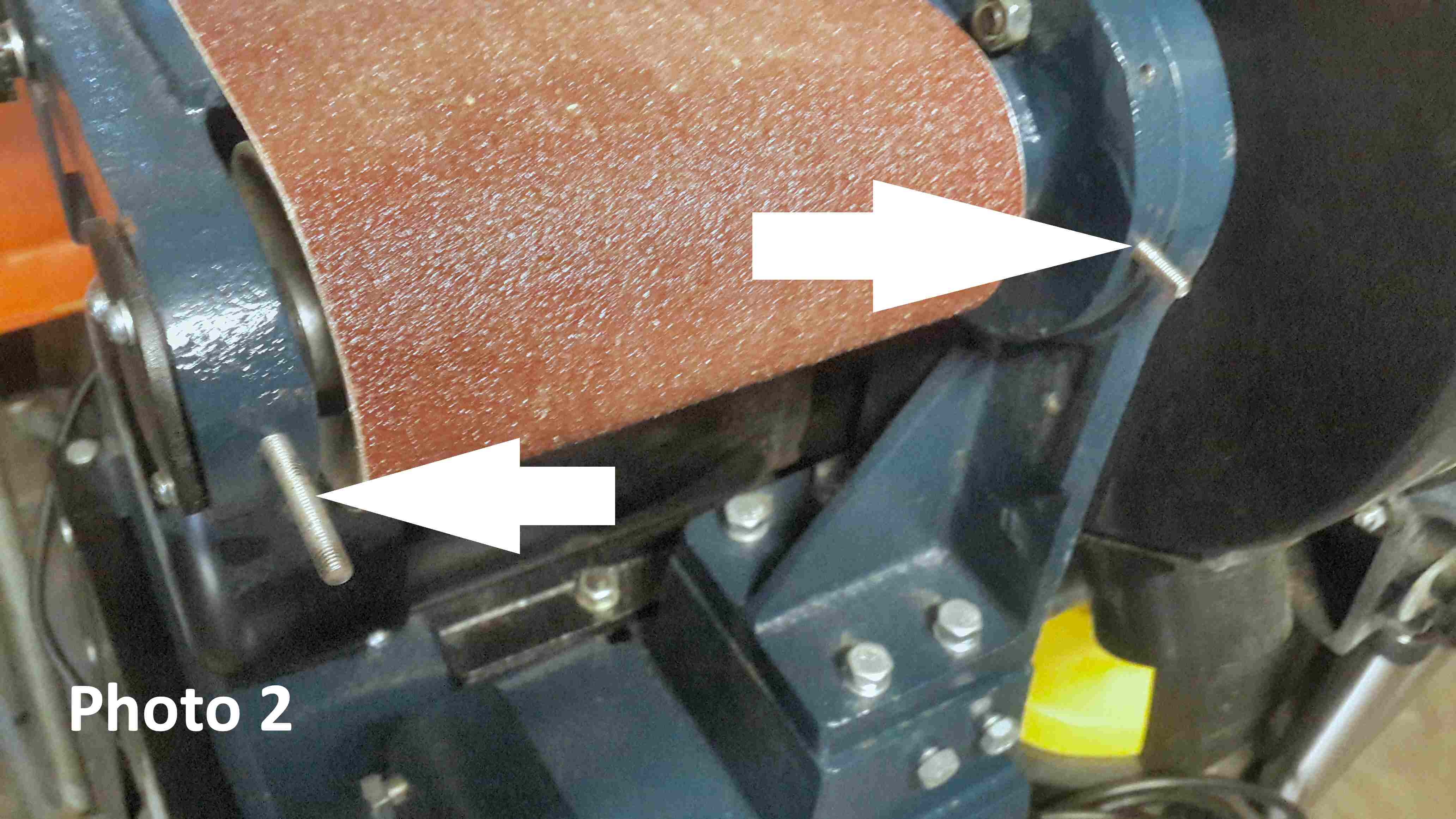

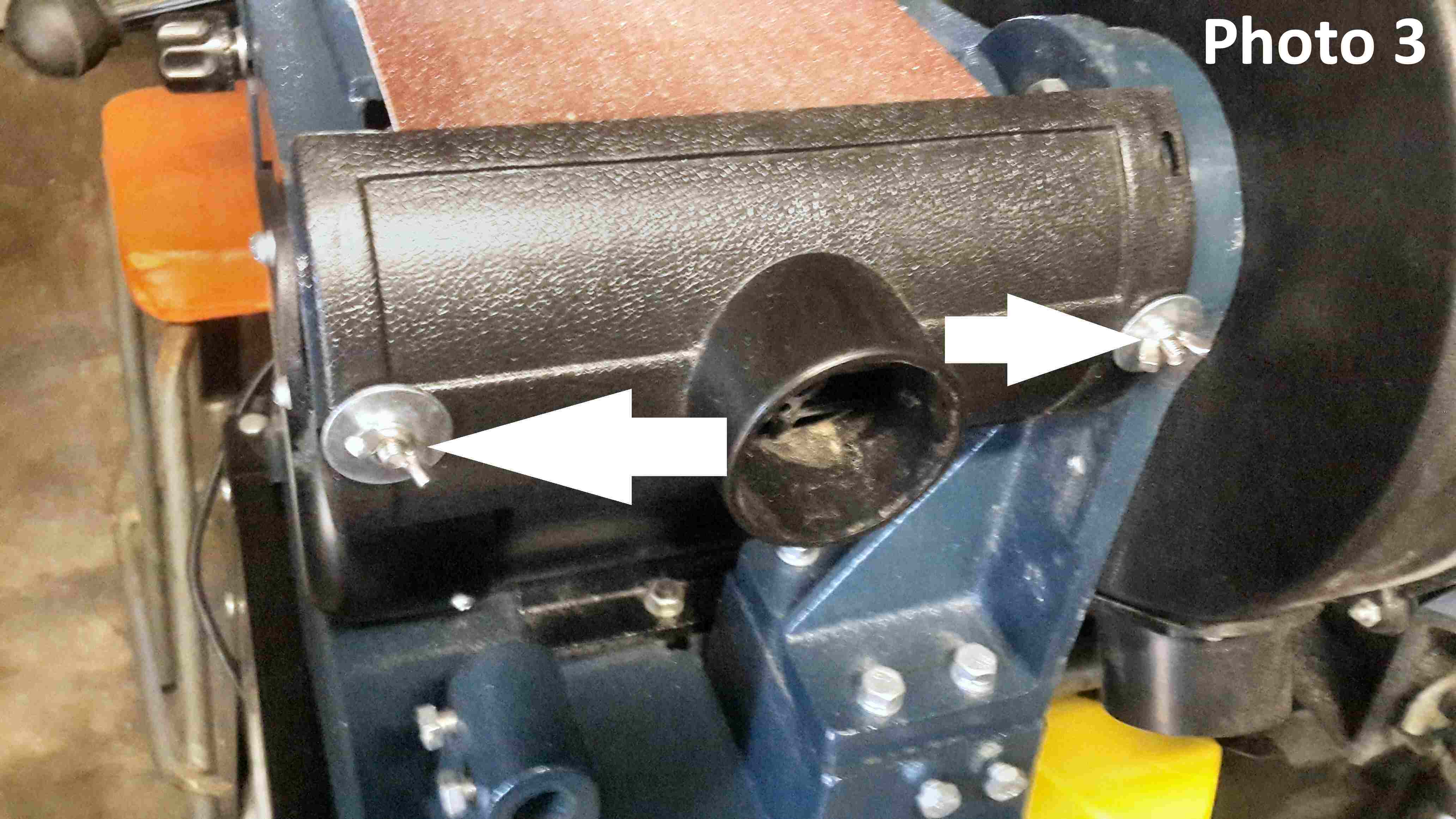

    I do not want to use the tool without the ability to connect my shop vacuum to the dust port. I therefore drilled and tapped the hole on the left-hand side and the center hole on the right hand side to M5. I then inserted a section of M5 threaded rod on either side (Photo 2). The cover is then affixed with M5 wing-nuts and fender washers (Photo 3). It now takes a few seconds to unscrew the wing-nuts and remove the cover when changing belts (without using tools).

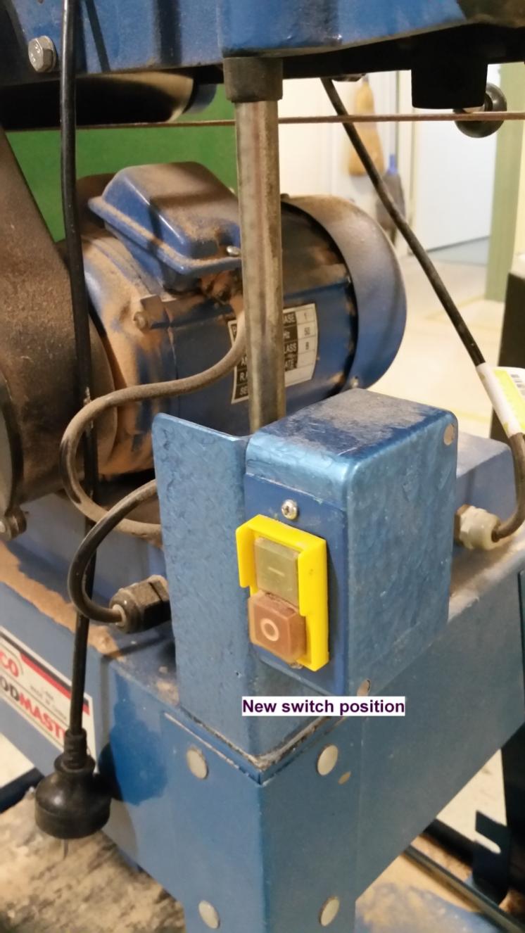

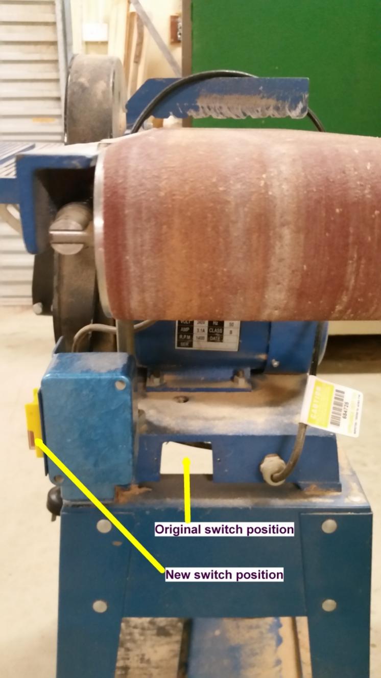

    Good move Natie123. My next project for certain.
    May I strongly suggest another modification that is safety related.
    If yours is like mine the on/off switch is directly under the belt and that means that if the belt shreds and you instinctively reach for that switch all the flesh CAN be flayed from your hand.
    A friend had a belt shred on his and as he reached for the wall switch to kill it he leaned forward a few cm and lost the tip of his nose. Not pretty.
    Unfortunately I will not be home for a few days yet so I cannot send photos today of how I modified mine but I will as soon as I get the chance.

    These photos show the original and relocated positions of the original switch. Also shown is the knee switch I am about to fit. USD26 from Amazon (https://smile.amazon.com/Switch-Star...ds=hy56+switch). The same make and model costs $100 in Aus, the postage from Sydney is more than the postage from Seattle, and AusPost regularly take 12 days from Sydney (1800km/1200miles) so I got it four days faster as well. Amazon also have a similar switch for only USD 13.99 but I know this brand so went with it.
    I should have purchased a mounting box for it from Amazon as well as it does not quite fit the local boxes, looks like another weeks delay.
