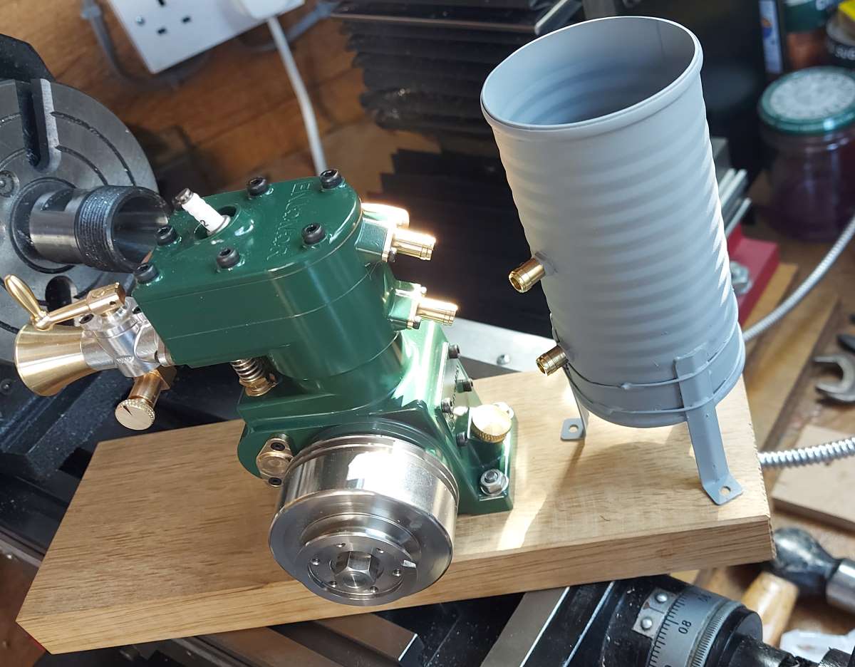

    I needed a cooling water tank, trouble was the larger tins had the right look and the smaller tins were the right diameter....

    Someone commented that this doesn't fit the aesthetics of the normal models I make, I think he has a point....

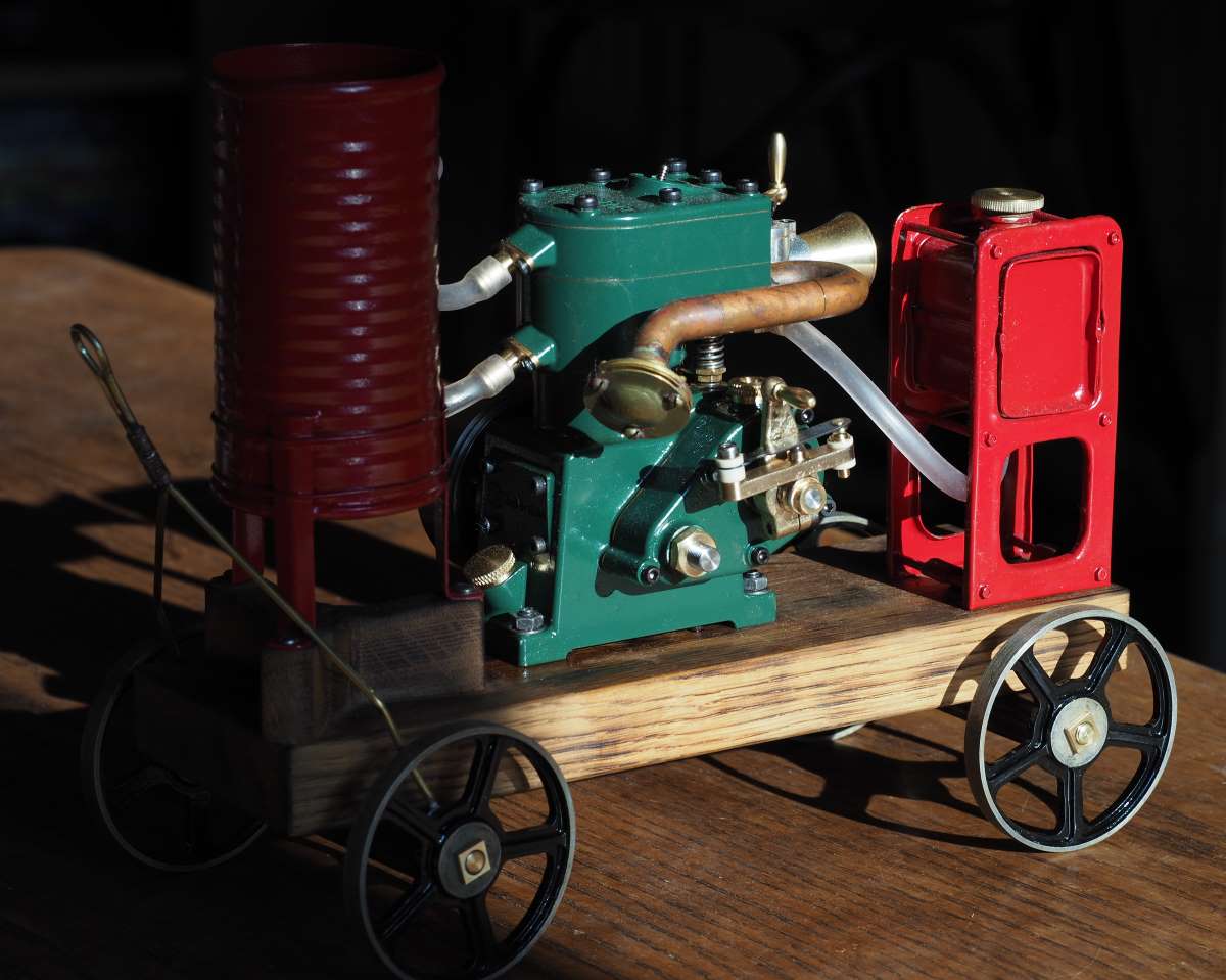

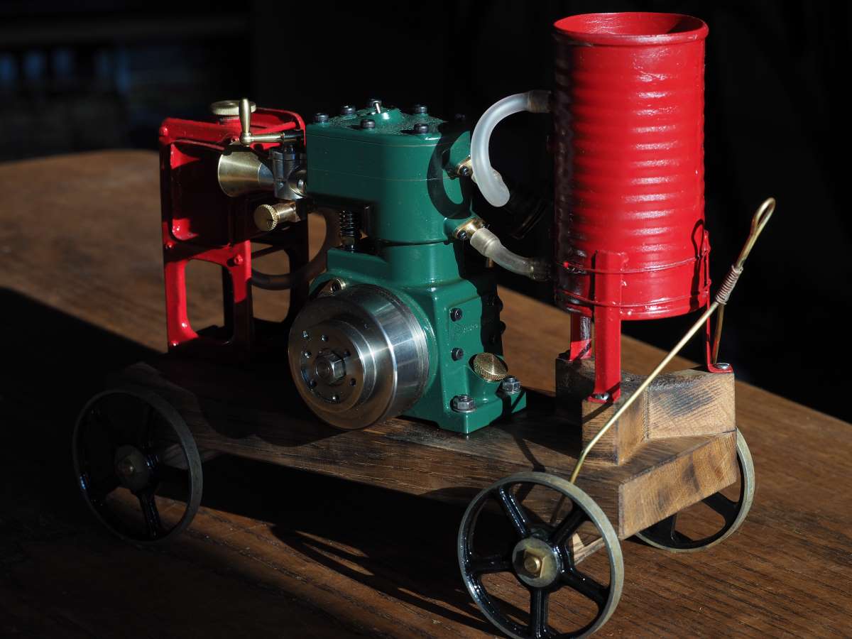

    The final design and installation of the Enjomor Whippet engine on a trolley
    What do you think?
    I will now run it as installed on the trolley and post the video.
