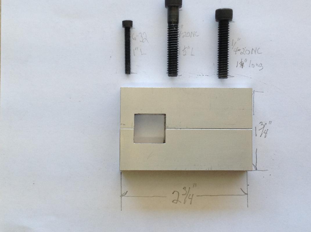

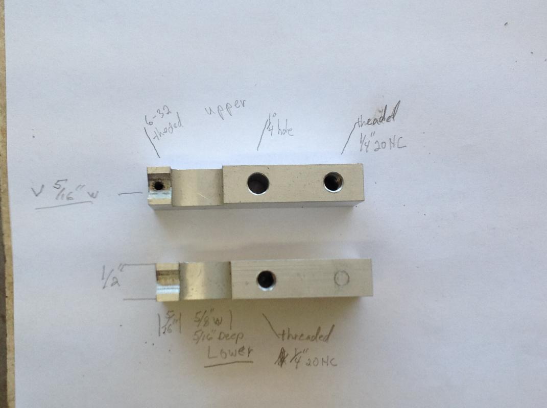

    What are the basic dimensions on the lantern vise shown in the photos? I'd like to make one of these, but having some idea where to start and how big to make one would be helpful.

    I'd be glad to, it just might take a little time. Contrary to what some think around here I don't work off drawings, napkins, paper scraps or anything else. I got the idea from Marv's post who seems to work like me. I took the basic idea and and scaled to the job(in this case trimming 1/4" socket head screws) and found some stock I had laying around. I'll see what I can come up with, thanks for asking.

    Thanks for the quick reply! If you could just tell me the approx. overall length, width, and thickness of the vise, and of the square hole, that will be enough info for me to start on. I can use one of your photos, with a known dimension, to get the other dimensions by putting the photo in my CAD program. Works the best when the photo is taken very perpendicular to the object. Your first picture is very close to that.

    Ok, here goes Metalmuncher. It ain't no TM51 special, but I hope they help.
