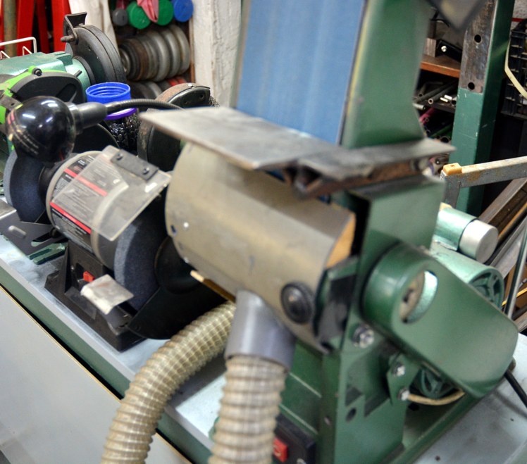

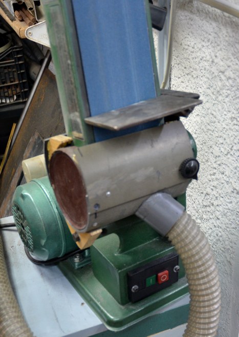

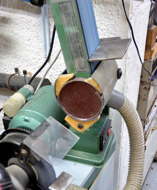

    Quote Originally Posted by TomBuildsStuff View Post
    .... I also found that when trying to plumb my shop vac into the dust collection port on the back, that when the vac was turned on, the belt would not turn... there was not enough clearance between the belt and the port to get adequate airflow, and not enough torque in the stock motor to overcome the suction. .....��
    i added a dust collector as shown in these pix. As the dust is carried downward by the belt it just falls captive to the air being sucked in. There is no tendency to suck the belt onto the platten. It is made from some scrap plastic drain pipe, the lid off a coffee jar and some scraps of wood. It works really well. The black knob on the front is the only bolt holding it on, elsewhere it just rests on a shaped support.
