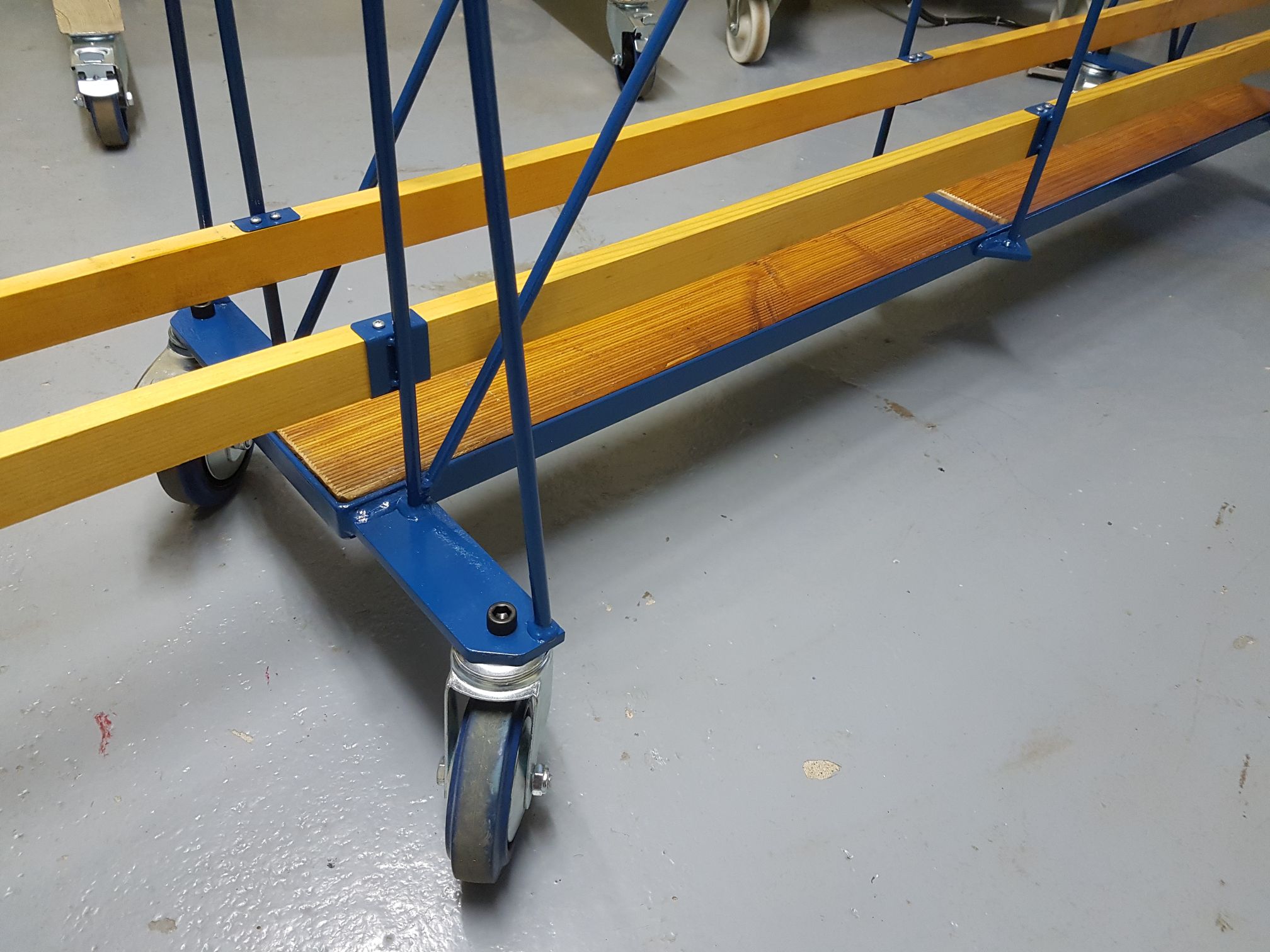

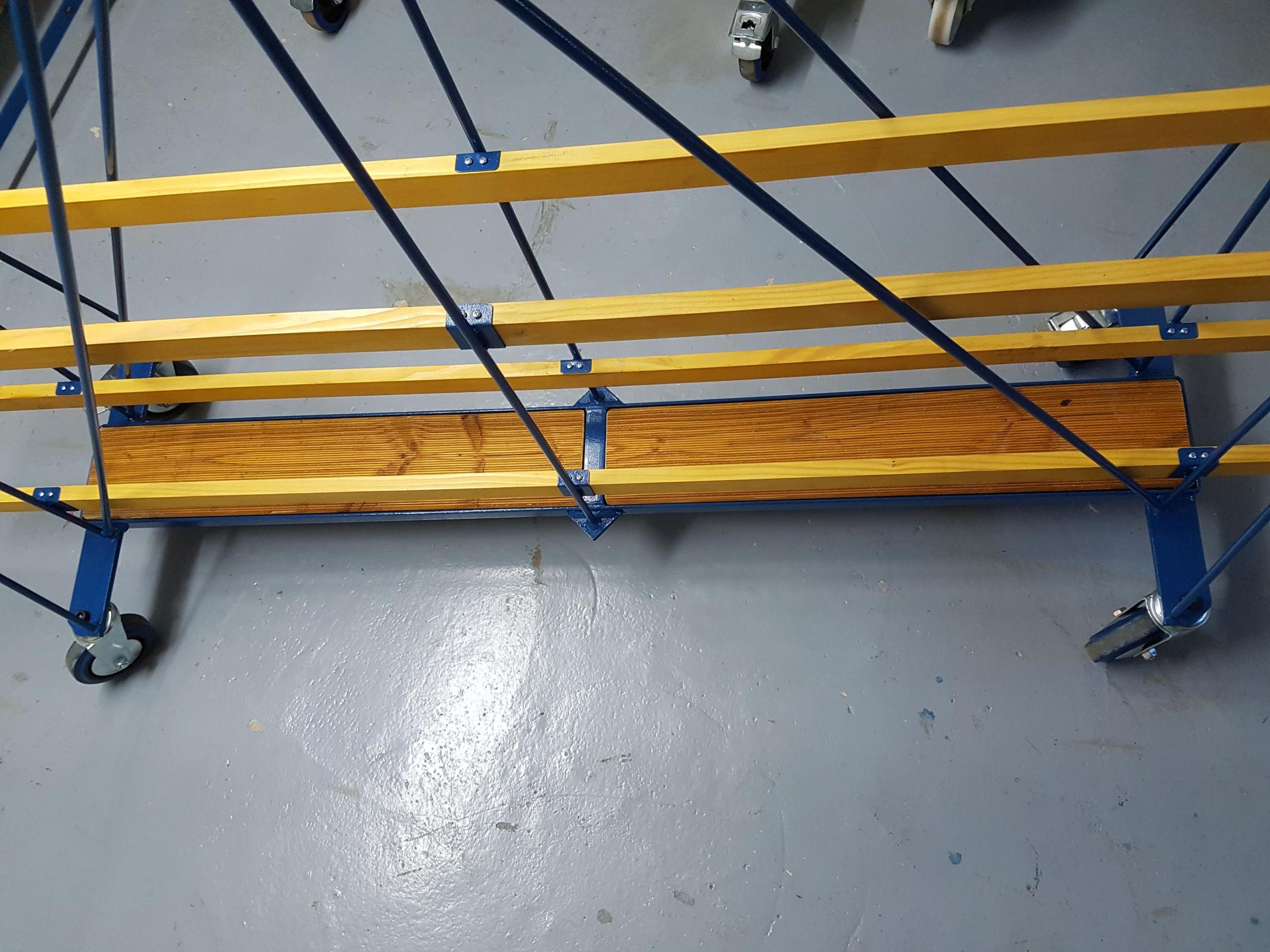

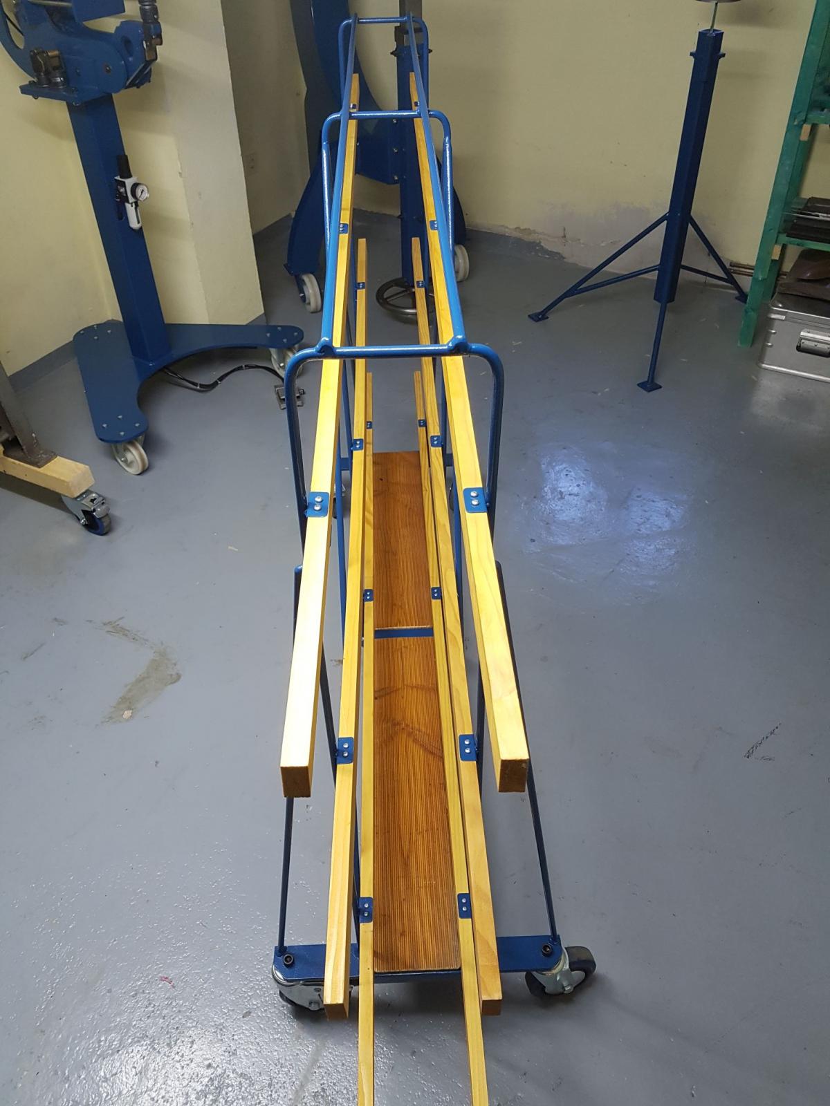

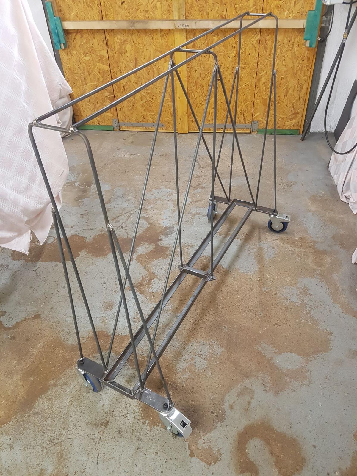

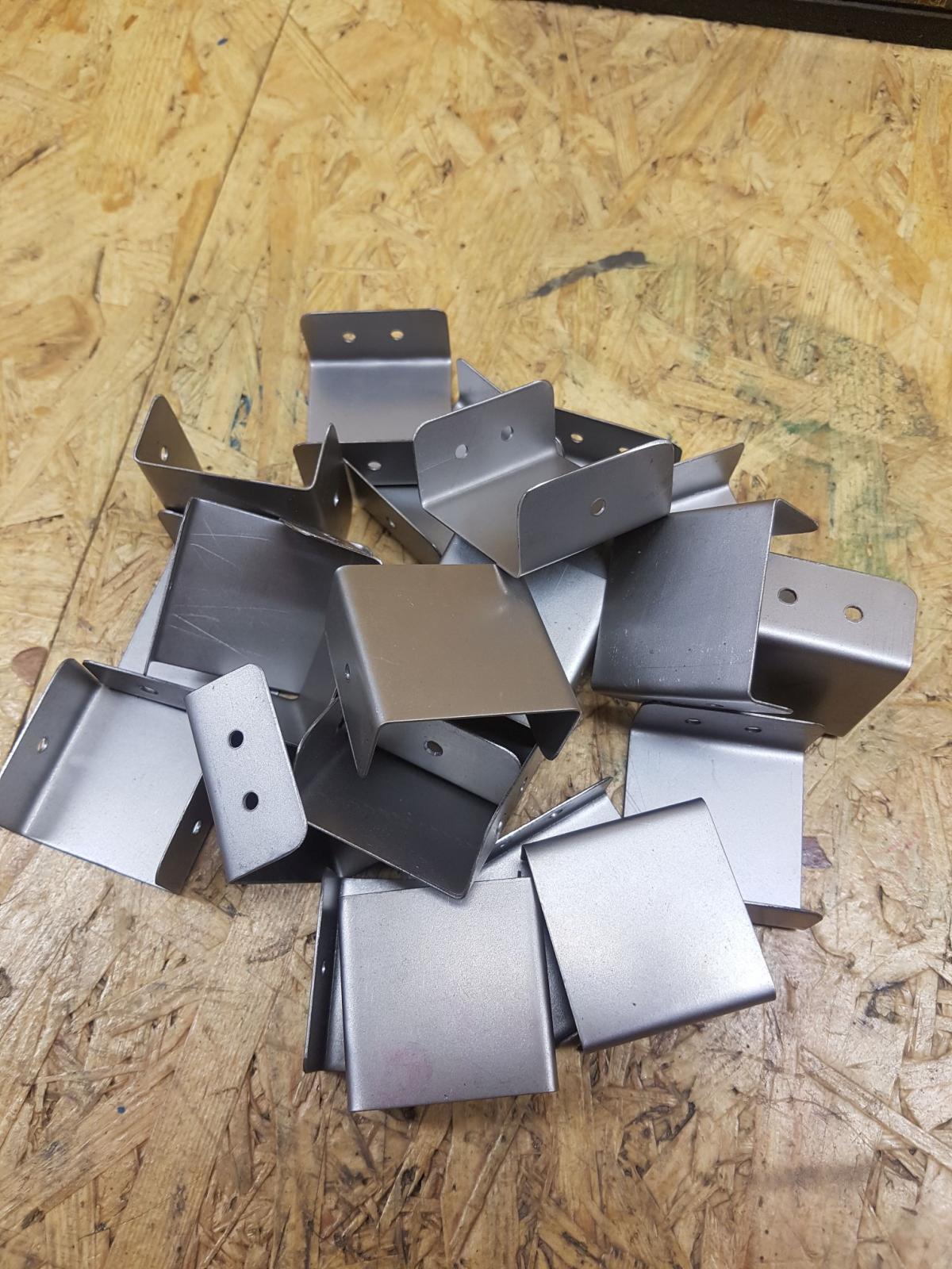

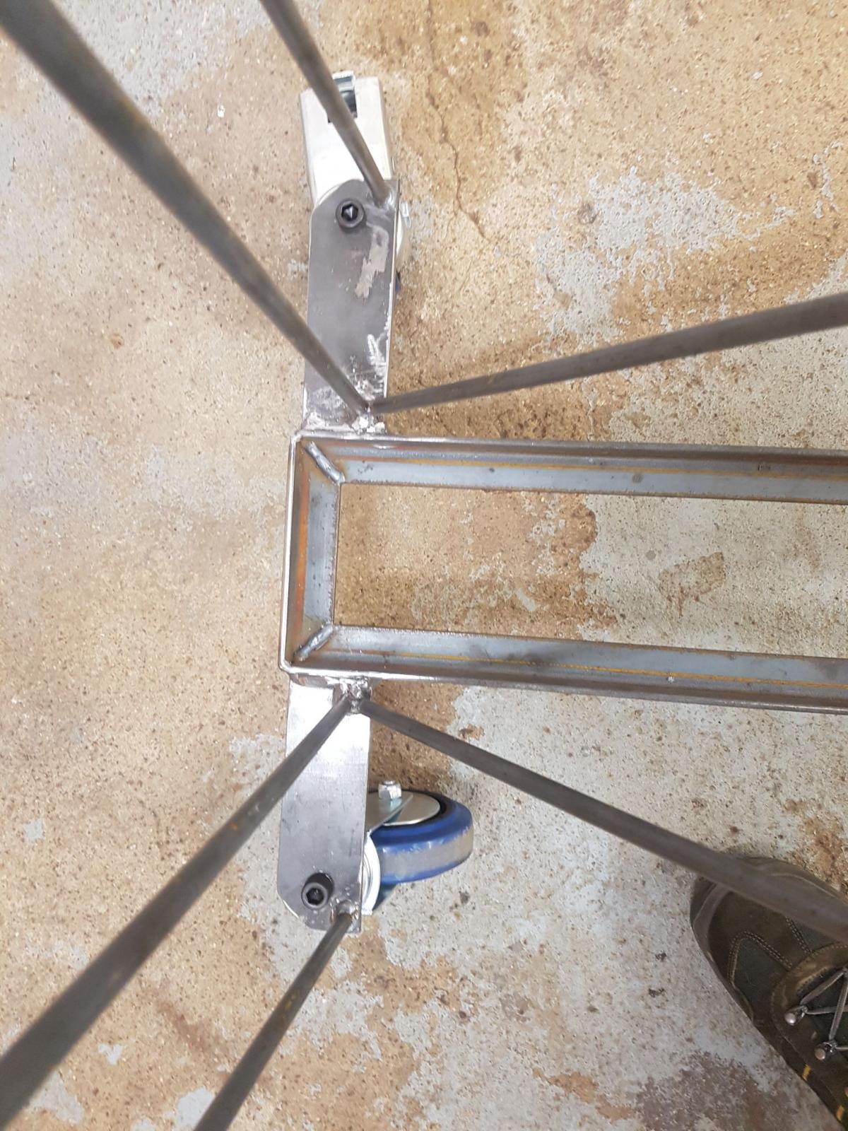

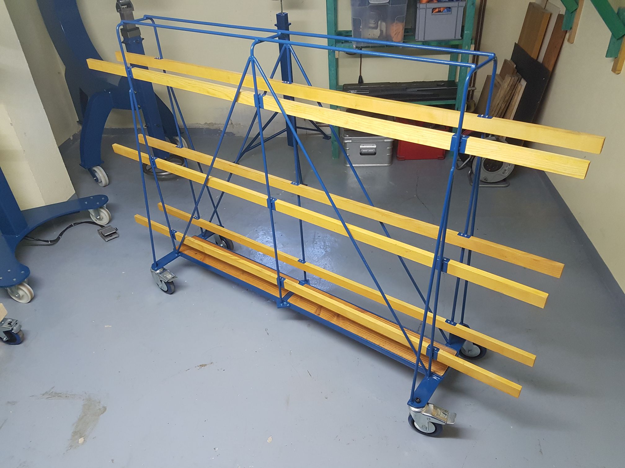

    Hi Folks
    This might be something for you panel beaters in the community. This storage was built to suit 2x1 meter sheet metal. Made of mild steel profiles and some wood I had in stock. Nice thing especially when you have few space in your workshop.
    Cheers
    Charst
