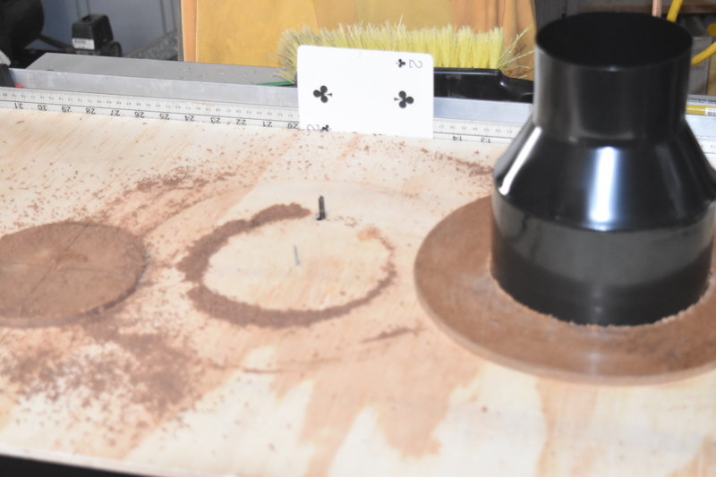

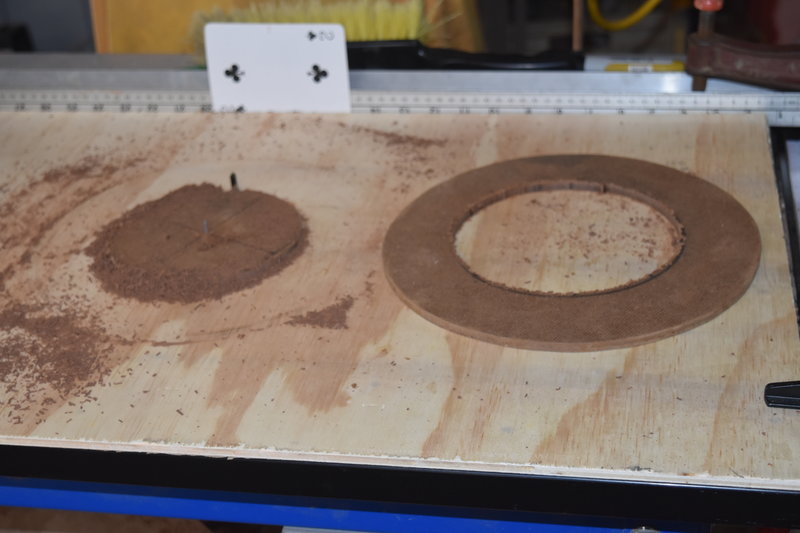

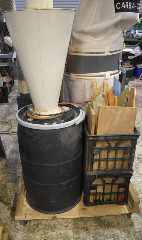

    When I purchased a drum sander all that had to change as they HAVE to have extraction.: So I planned and built this (version 2 which is stepped for height differences of the extractor (that had no wheels) & cyclone separater with drum. The rolling stand is made from used pallets : the only items I had to purchase were the braked rollers. My original drum, a 44 (Aus) gallon(200 litre) was too large to clear overhead timber & steel storage so I used one that I was using for fertilizer which did not have a flat top so I routed out a masonite ring and siliconed & bolted it to the drum lid.
    MOBILE DUST EXTRACTION WITH CYCLONE-rsz_dsc_0890.jpg MOBILE DUST EXTRACTION WITH CYCLONE-rsz_dsc_0892.jpg

    I also envisaged more difficulty in emptying the large one as I get older & arthritis issues to boot.
    I had to make a couple of conduit couplers for the cyclone & flexible pipe also.Not wanting to waste space I used the empty area for timber storage by screwing 2 milk crates (top one with bottom removed) to house 3' to 5' lengths.
    Now I can roll the unit around to various machines after moving others aside.
