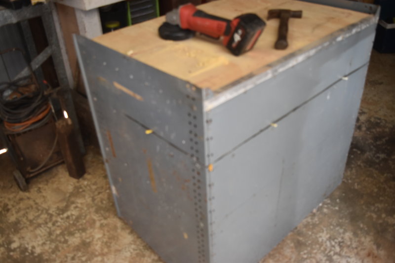

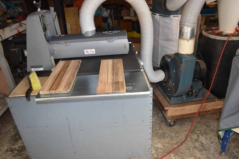

    When my 19_38 SuperMax drum sander arrived, I had a spot planned for it but found that it was unsuitable due to being fixed to a wall.
    I had some Brownbuilt metal shelving in another shed & thought at 900mm high it would work well.
    I use some for sharpening & mitre sawing & that height is comfortable for me. It was too awkward to use after attaching 100 mm castors & reducing the height a bit for the sanders ends. I also fitted a sheet of plywood over some checkerplate foam rubber to dampen bumps & noise generated by the steel bench. A piece of scrap aluminium was used to brace the open front.
    Attachment 29283
    Therefore it was on to plan B.

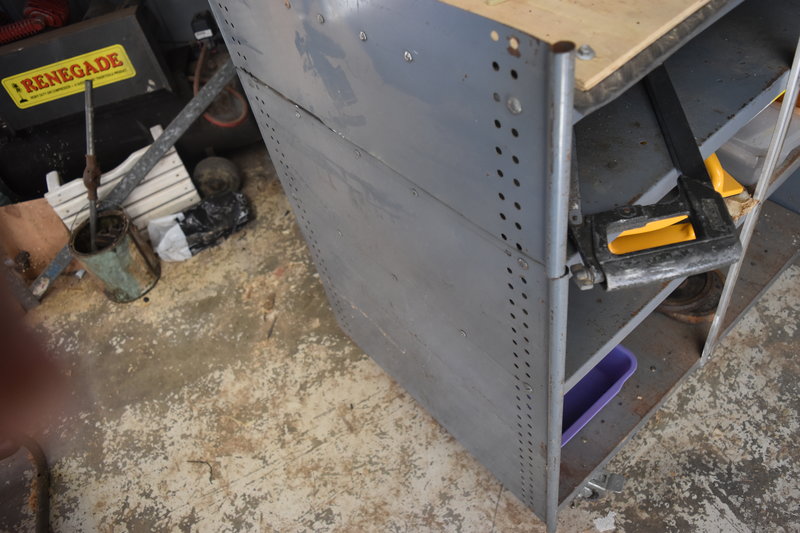

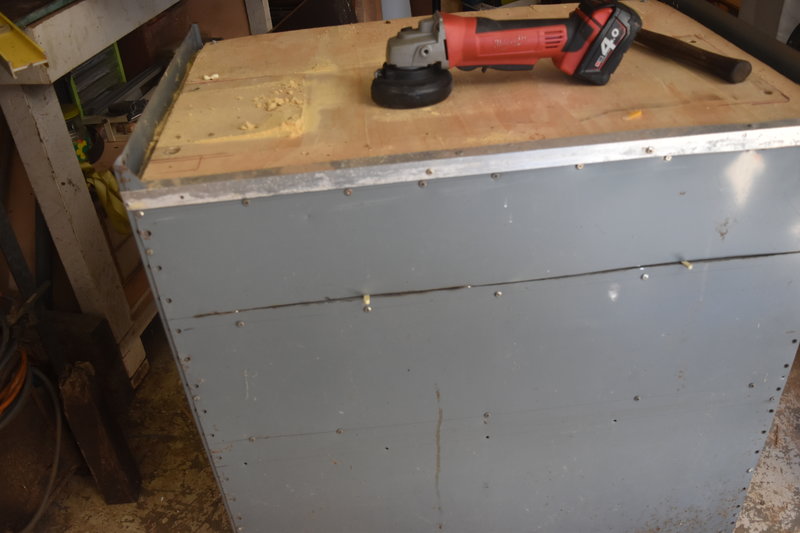

    I decided that 230mm should be cut off the cabinet (& keep the finished height a little below my tablesaw height) so did that. To avoid jaming I inserted tiling wedges as I cut.
    MOBILE DRUM SANDER TROLLEY-rsz_dsc_0049-1-.jpg MOBILE DRUM SANDER TROLLEY-rsz_dsc_0050.jpg
    I also left the front two corners till last & cut them with a hacksaw. I had thought of using a G cramp spaced over the hearby cut but decided against that.

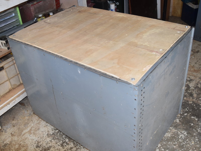

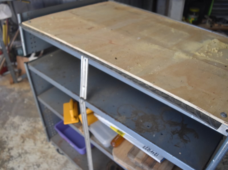

    MOBILE DRUM SANDER TROLLEY-rsz_dsc_0055-4-.jpg MOBILE DRUM SANDER TROLLEY-rsz_dsc_0054-4-.jpg
    I replaced the top with foam & ply & it now it is much easier to manage. The final height is approx 870mm.

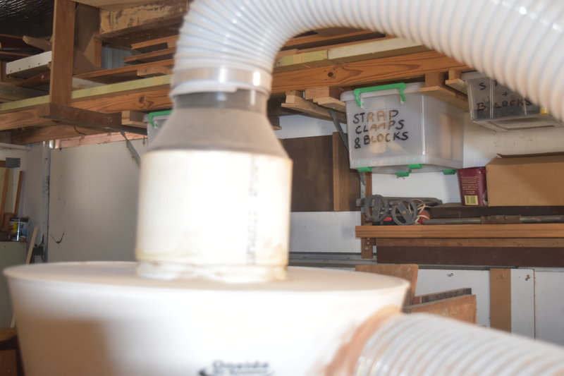

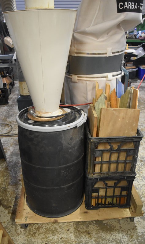

    It's an Oneida, Super Dust Deputy from North America: (I really like US, Canadian. UK, NZ, German, Swiss and Oz made stuff). There is some detail in my HMT post for the mobile dust extraction unit, but here is some more info. I purchased from Carbatec for $500 but worth it as my homemade one was thrown out yonks ago as I just couldn't get it right: some might FITH: maybe should have tried just either metal or wood instead of combining materials.

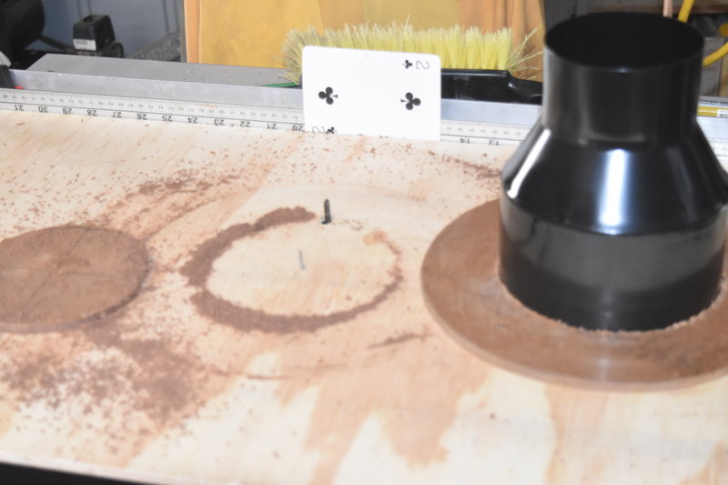

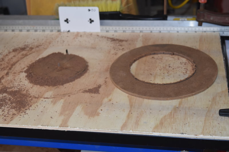

    Had a couple of minor issues with fitting. There is a 5" inlet and after declining my 200 litre flat top plastic drum, I went for a smaller, lighter when filled, shorter (to avoid my overhead storage as I needed mobility) drum which did not have a flat top so made a spacer type union from masonite using a router.
    Pic showing inlet for template with union
    for attaching base of cyclone to drum top.
    That was then siliconed & bolted to the clip off top of the drum and looks like this
    As the Oneida has a 6" inlet, & doesn't come
    with a step down I bought 6"/5" one from Carbatec.
    It of course didn't fit so used some 6" pvc down/storm pipe
    which worked fine. Siliconed on for dust proofing and strength. MOBILE DRUM SANDER TROLLEY-rsz_dsc_1274.jpg

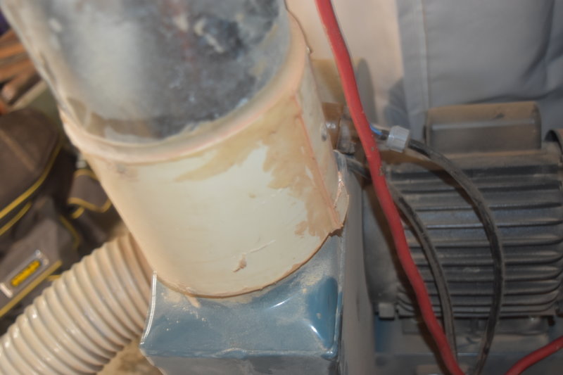

    Next minor issue was the connection to my 1992 extractor.
    The metal one that came with cyclone or I bought with it wouldn't
    slot together so to make them align I made this connector
    by cutting some more 6" pvc and joining with long alloy
    rivets and more silicone. Worked a treat. MOBILE DRUM SANDER TROLLEY-rsz_dsc_1275.jpg
