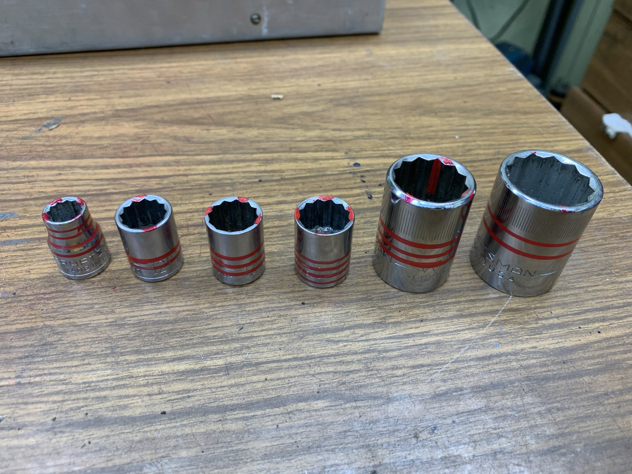

    I can hear you now. Some will hate this approach to marking metric sockets. Hopefully, a few will at least give it a second thought.
    My goal was to find a simple way to mark my metric sockets for quick access.
    If you are interested, please, click here.
    Your comments are welcome. All of us are smarter than any one of us.

    Your approach has the obvious benefit of costing little to nothing. If one is willing to spend a bit, this is the solution I use...
    https://www.amazon.com/Precision-Def...6JSFRGYD7NPMA5
    Room for regular size and deep sockets, held in place magnetically so spill proof, can be picked up with one hand, and the magnetic base allows you to stick it to the side of your tool cabinet if so desired.
    Given your EE background, an improvement to your scheme might be to color the rims of the sockets using the resistor color code. For your scheme only four colors would be needed - brown, red, orange, yellow. With the whole rim painted, it would be much easier to see and there would be no need to count dots.
    Get a set of these or similar...
    https://www.amazon.com/Anything-Perm...s%2C223&sr=8-5
    and you'll never need to open a paint can when doing these small marking jobs. (Can you tell that I hate painting?)
    Regards, Marv

    Thanks Marv, I just placed my order for those markers. Rick

    These oil based markers are great!
    Thanks for the tip.

    If you are concerned about identifying sockets that are laying on their sides:
    Rick
