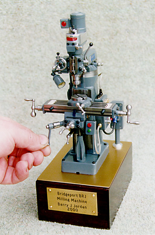

    I'm glad you enjoyed my models, Hemi. As I mentioned earlier in the thread, they're all dollhouse scale, 1/12 (inch to the foot). If you're incorporating the models into model machine shop dioramas or such, there are many doll house accessory suppliers to provide auxiliary items and scale paneling, windows, etc. for the display.
    A working 1/25 scale of a Bridgeport would, I fear, be just too small. It's not undoable, of course, but it would try the patience of a watchmaker. For a more realistic 1/5 scale model, take a look at the work Barry Jordan has done...
    https://www.craftsmanshipmuseum.com/Jordan.htm
    I've seen these models at the Craftsmanship Museum and they are indeed spectacular.
    Barry has completed an even smaller 1/14 scale working model of a Bridgeport (pictured below), but nothing like 1/25.
    You don't reveal your location but if you're ever in Southern California, be sure to visit the Craftsmanship Museum. You'll be speechless for days. :-)

    Marv,
    WELL that being said, in 1/25th scale I wouldn't be trying to make them operate, just static, for display purposes with the model cars and trucks I make and I plan to make a garage to go with them for display.
    I wonder just how much be incorporated in making static ones...... Follow me? (I did NOT realize, in the beginning of seeing this), that these 1/12th scale ones actually worked..... -WOW, even more impressive!!!!!!
    The work you put forth however in the 1/12th scale ones is impressive all on its own never mind that they actually operate!
