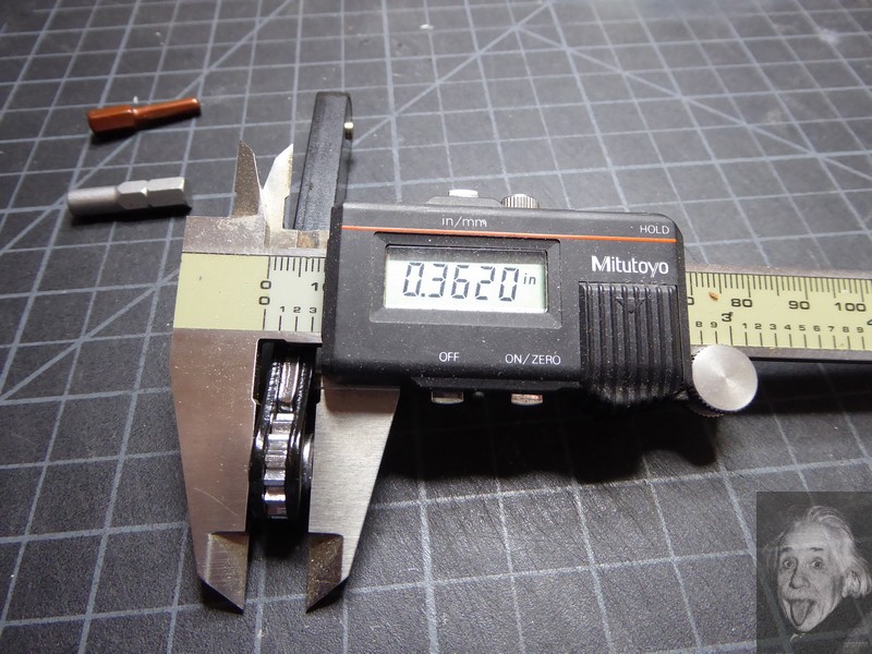

    I didn't want to take the time to do a complete build as they did, but still wanted to have the capability for the rare occasions where it might be needed.
    This style offset screwdriver...
    https://www.amazon.com/MulWark-Profi...191343&sr=8-20
    has the advantage of a small, thin head as well as a switch to reverse direction. I have one I picked up cheaply at HF a long time ago.
    The problem is that it takes only a 1/4" hex, not 4 mm. An adapter is needed. Wiha makes a 1/4" to 4 mm adapter, e.g. ...
    https://www.amazon.com/Wiha-75802-In...8958965&sr=8-1
    but its length nullifies the advantage of the thin offset screwdriver head...

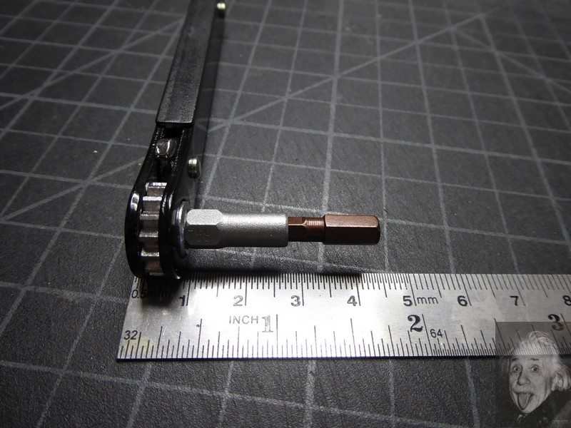

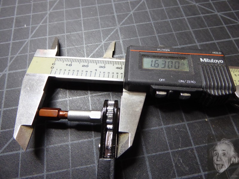

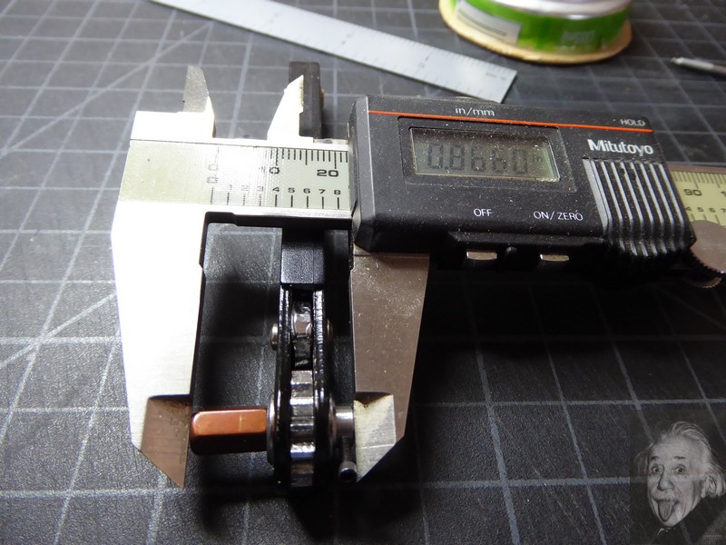

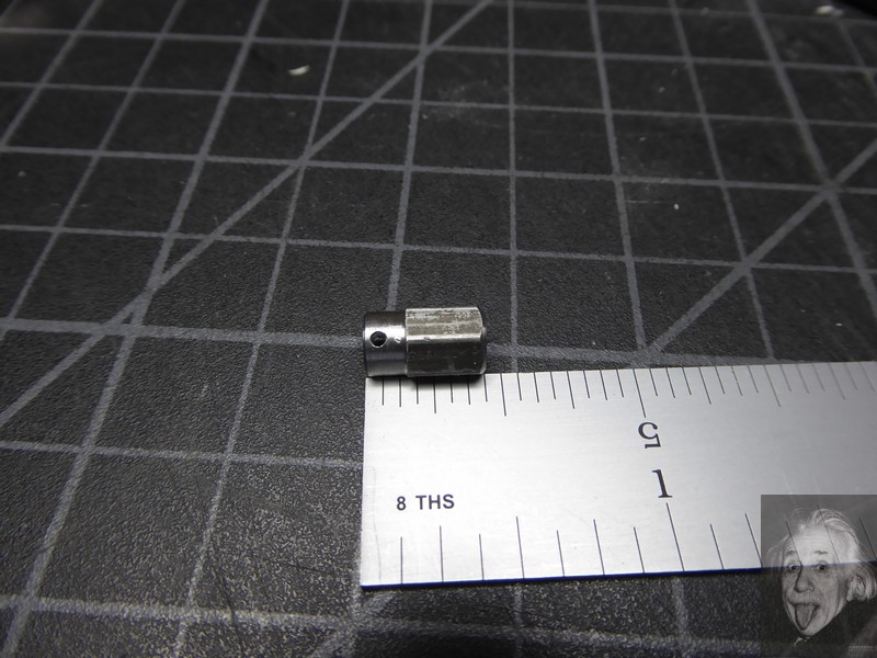

    I have some 1/4" hex steel but carving a 4mm hex into it would test my patience. This is a really low torque application so a simple hole with a setscrew acting on the 4mm hex flats would work so I made this...
    A half inch length of hex has a turned down section (to slip between two retaining tabs on the wrench) which has a cross-drilled and tapped 0-80 hole for a setscrew to lock the bit in place. The hex is drilled through with a #16 drill (0.177" ~= 4.5 mm) that is a slip fit on the 4 mm hex shanks on the various bits and sockets.
    Fully assembled, it looks like this...
    and can fit into a crevice less than an inch wide.

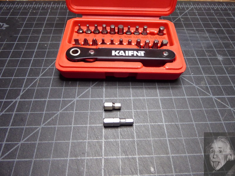

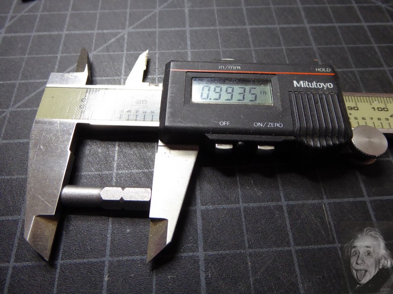

    When I was making the adapter for 4mm bits, I noticed that the headroom needed to use the wrench was limited by the length of the bit. If the bits were shorter, they could be inserted into a smaller free space above the fastener. Not a real problem; when necessary, simply cut the 4mm bit shorter and gain a little clearance.
    Then it occurred to me that the same thought applies to the 1/4" bits commonly used with this style wrench. I was ready to get out the disk grinder and make a set of amputated bits when it occurred to me that I couldn't be the first person to notice the occasional need of short bits. A quick check on Amazon proved this true...
    https://www.amazon.com/dp/B07YCP213C...roduct_details
    This set is shown in the photo along with a short 3/16" hex bit compared with its normal sized brother.
    Normal size length = 0.98"
    Shortie length = 0.59
    Headroom gained = 0.98 - 0.59 = 0.39"
    Something to keep in mind if you do a lot of work in close quarters.

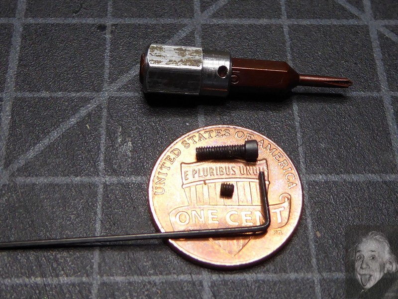

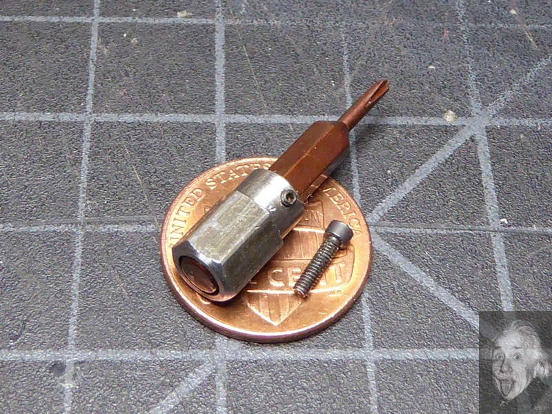

    I discovered that the 0-80 hex head screw mentioned in my original post, while a workable substitute for a 0-80 setscrew, got in the way on some of my smaller models. Not many folks have 0-80 setscrews on hand but I've got them in several lengths and metals. The one I selected, shown in the middle of the penny, is 0.064" in length and 0.060" in diameter. Below it is shown the 0.028" Allen wrench used to tighten it. [Aside: How in blazes do they make the 0.028" hex hole in the setscrew?]
    This photo shows the setscrew installed in the adapter and the machine screw it replaces.

  9. #7
    11,690
    2,217
    Thanked 9,187 Times in 4,391 Posts
    Marv; are you sure that is not a 3" diameter Penny with a 1/4-20 setscrew in the picture.? It would be much easier to fake a picture than imagine making a .028" hex hole in a screw less than a 1/16 of an inch in diameter. But I have worked with 0-80 screws in the past so I am aware of their size. Can't say as I have ever needed a 0-80 grub screw though.
