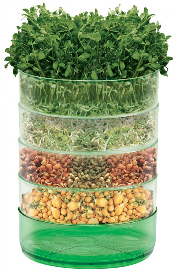

    I'm trying to build my own sprouting system for every kind of sprouts.
    Obv, there are a lot of prepackaged tool (like this one for example), but they are very expensive considering that they are only made of plastic! So, I fend with some cheapest solution (stacked colanders and collector for water).
    Now, I'd like to improve my own "creation" adding to it a mini-sprinkler to sprinkle water at predefined intervals. The idea is similar to the sprouter in this photo, where you can see the helical sprinkler at the top of the sprouter.
    However, I don't know where to start and what to buy and I'm here to ask your help.

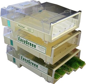

    I'm not the least bit familiar with sprouts, but from the looks of the first pic it looks like a stacking food dehydrator's stacking trays may be a good start.

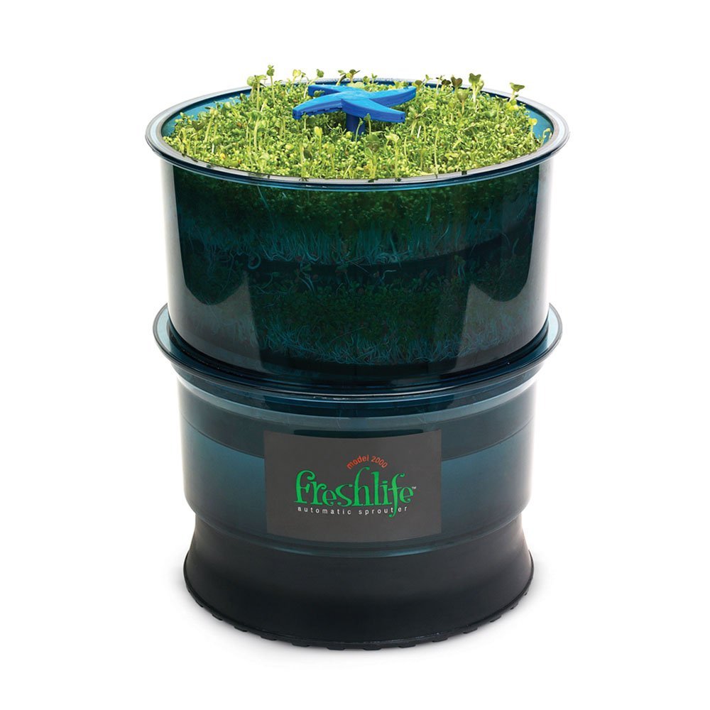

    Just adding some of these pics inline, so people can see what the pre-made commercial units look like.
    Is your plan to use these just for sprouting, or also to grow grasses? (And I mean that in the perfectly legal sense, despite the fact that I am from Colorado ).
    Sounds like you've already solved half the problem with stacked colanders. So, what's left? Pump on a timer with some tubing and a fine misting nozzle?
    Attached Thumbnails Attached Thumbnails Mini sprinkler for sprouts-sprouter1.jpg   Mini sprinkler for sprouts-sprouter2.jpg   Mini sprinkler for sprouts-sprouter3.jpg

    - a timer to activate the pump every X hours. Are these kind of timer produced? I mean, I've only seen timer that activate at hour X every day, but never seen one that activates every X hours during day. Also, because the pump's flow is very low and the "Freshlife 3000 automatic sprouter" you posted use a permanent watering system, maybe I can also avoid to use a timer at all.

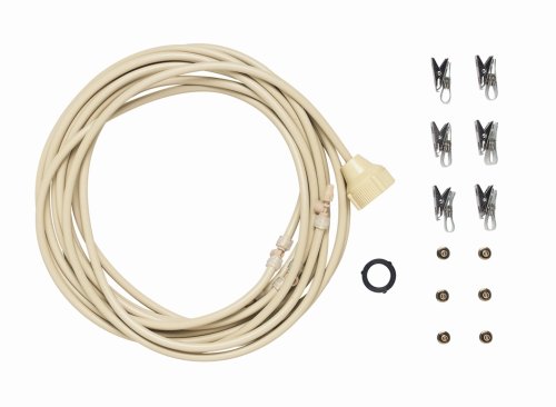

    Can you run this off of a garden hose connection? Then you could use an irrigation timer on the hose, and completely eliminate the cost of the pump. It would also give you enough pressure to run a very fine atomizing mister.
    Then you could use one of those prefab "outdoor mist kits" that people use for outdoor areas in hot climates, like this one: Amazon.com : Orbit 20066 Portable 1/4-Inch Outdoor Mist Cooling System : Garden Hose Parts : Patio, Lawn & Garden .
    Attached Thumbnails Attached Thumbnails Mini sprinkler for sprouts-mistkit1.jpg   Mini sprinkler for sprouts-mistkit2.jpg
    Hey Jon, thanks for your time
    Well, the outdoor mist kit is a damn good idea. I can also use a system like it to moist other kind of sprouts.
    What I'm concerned about is its size. I mean, I have to built all for a very little system (about 30x30x50 cm). Also, it's placed in the kitchen (on the fridge to be precise) and I don't have full availability of the tap to attach a timer+hose on it. Moreover, I don't need so much water, just very very little (100 cc every 6-8 hours or something like that).
    So, maybe I can install some smaller nozzles on the mini pump.
    What do you think about it?

    My only concern is that the pump might not provide the pressure necessary to power one of those super-fine misting nozzles. I'd hate for you to turn on the pump and water just dribbles out of those nozzles. You'd have to be certain to match the pump PSI to the necessary PSI for whatever misting nozzle you used.
