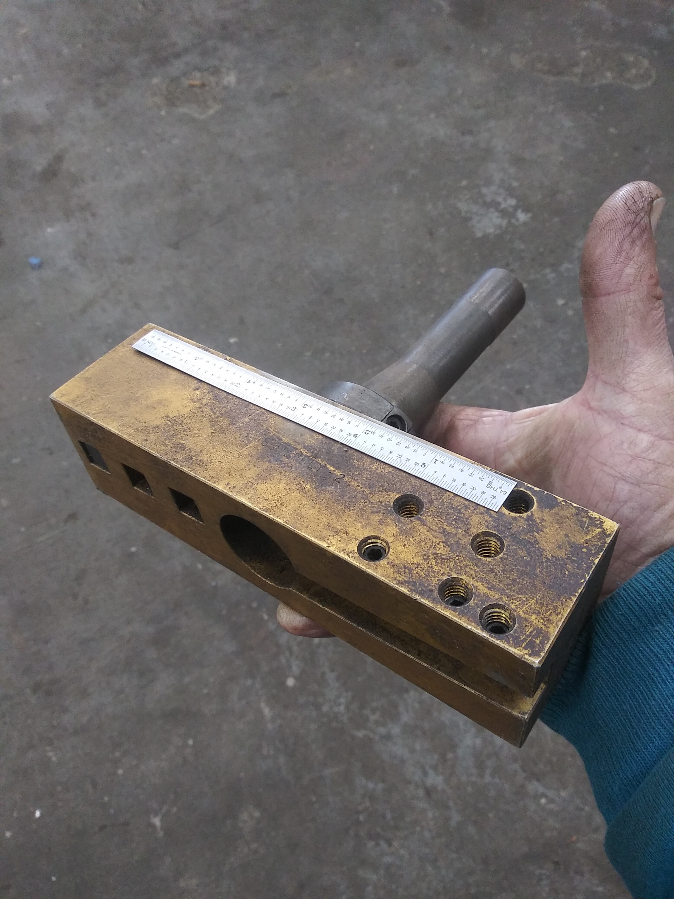

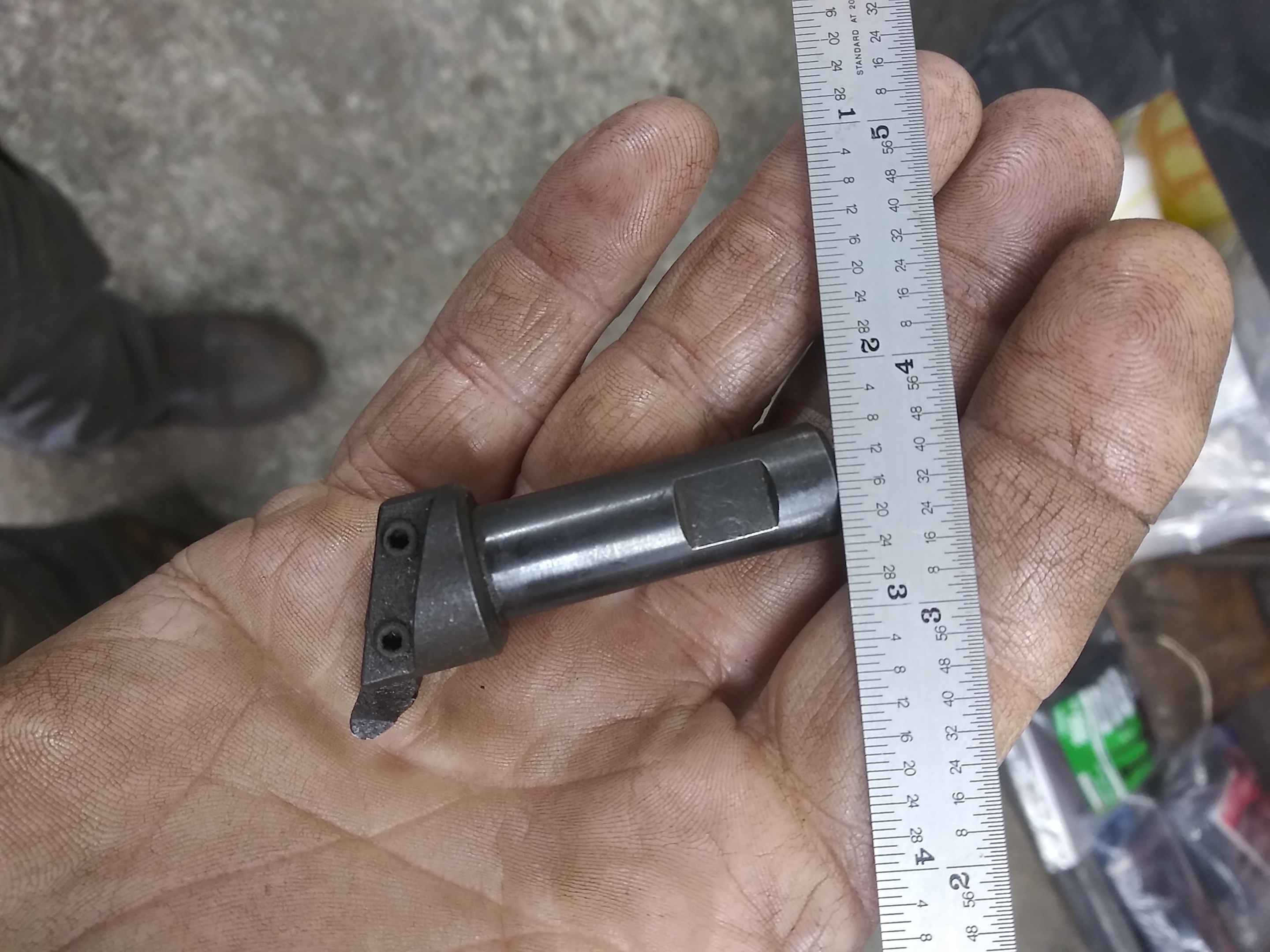

    Fly cutters are my favorite form tool when applicable. Few can hand grind 2 or more equal cutting edges on an endmill.
    Careful planning and work will blend intersecting surfaces (fillet) with a undetectable lap or toolmarks.
    And size? From Mini mill fly cutter - video-20221110_110502.jpg to Mini mill fly cutter - video-20221110_111751.jpg
    That's about limit I'll test my or a knee mill's limits. Little one 1/2" shank, larger is R8, with an aluminum body to alleviate rotational mass.
    Just yesterday (compared to 03:08 am) the larger fly cutter was employed as a boring tool, on a stainless plate 3/8" thick x 28" square in Bridgeport. The cutter was stepped out by hand for hole to 8-1/2". In cases like this, (mainly poor clamping) the feed mechanism wasn't used. Locked the quill in uppermost position, and fed the work manually with the knee, lowering to re-set cutter, and thus proceeded until reaching size.
