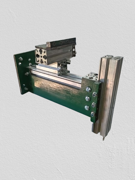

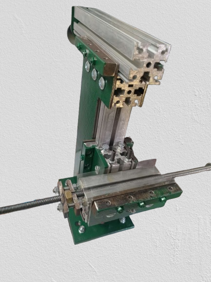

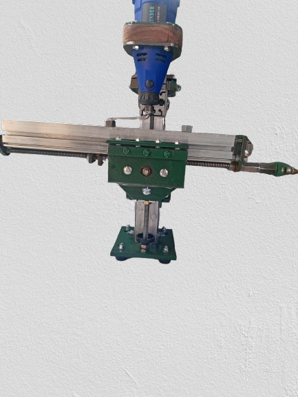

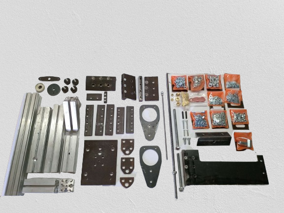

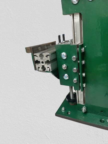

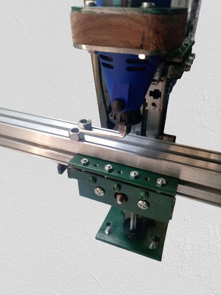

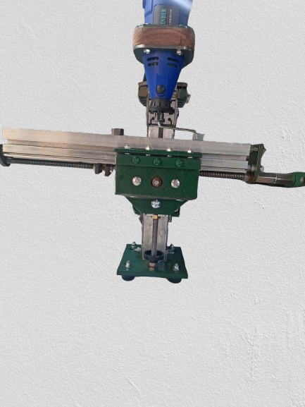

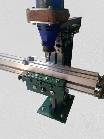

    Scratch built table top mini mill made from common materials. Simple to construct without the complications of specialised tooling being needed. It is possible to make and assemble this machine using only basic hand tools and a drilling machine.
    • 1 meter (3.2 Feet) or less of Aluminium Profile
    • A single 300x300 MM sheet of Material is sufficient for the entire build
    • The flat and square bar seen was used for convenience. The parts could arguably be derived from the same material as the machine sides
    • Tapped holes are not strictly necessary
    • Base plate is salvaged mild steel 130MMx120MMx8MM
    Took about 6 hours to put together. Quite a fun little build and the machine capabilities blew me away a bit, wasn't expecting much but am now impressed after some tests. The aluminium extrusion is 35x35 MM with 6 MM T Slots, I recon PG40x40 Heavy will work as well (10 MM T Slot).

    The sheet of clear plastic is a chip guard that slots into the table.

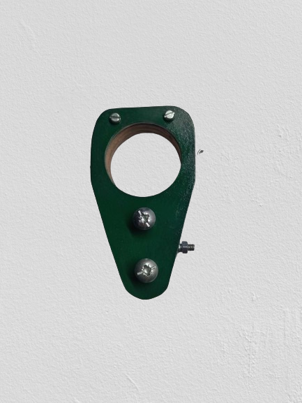

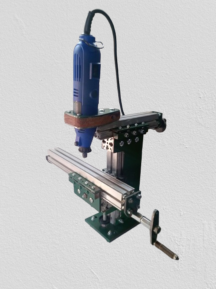

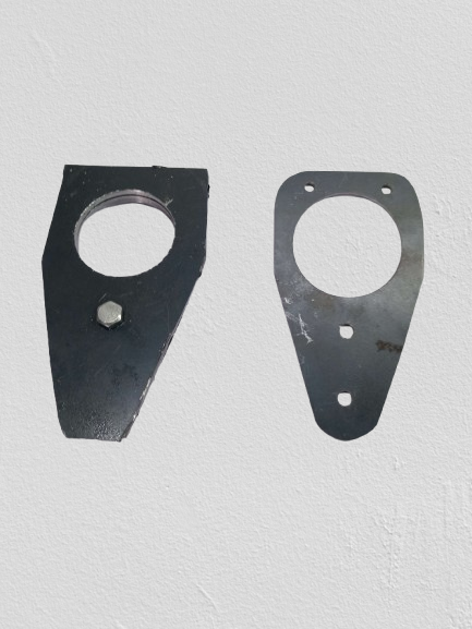

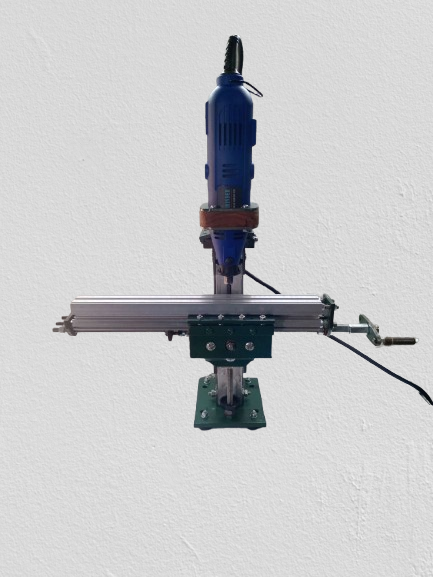

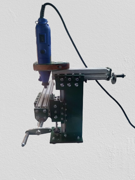

    Mini Mill - DIY Milling Machine-iso-view-image.pngMini Mill - DIY Milling Machine-front-view.pngMini Mill - DIY Milling Machine-side-view.png

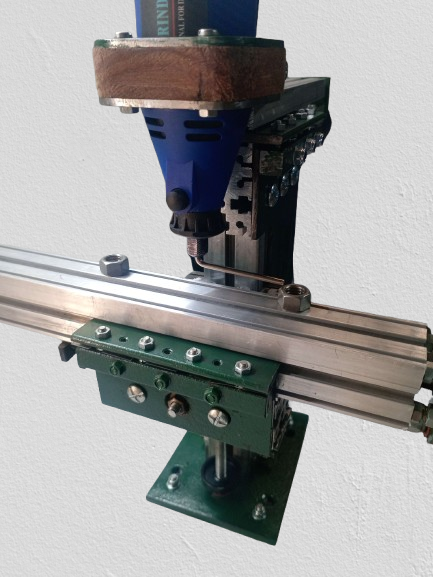

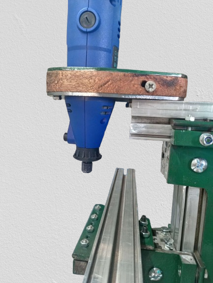

    Three views with Rotary Tool Spindle fitted

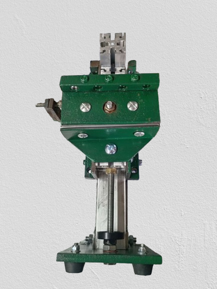

    The Z axis is a bolt and brass nut combo. The knee is drilled about 80% through to accommodate the screw.
    Mini Mill - DIY Milling Machine-img_20241007_193940.jpgMini Mill - DIY Milling Machine-img_20241007_193826.jpgMini Mill - DIY Milling Machine-img_20241007_185744_edit_81587411391784-removebg-preview.png

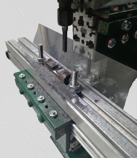

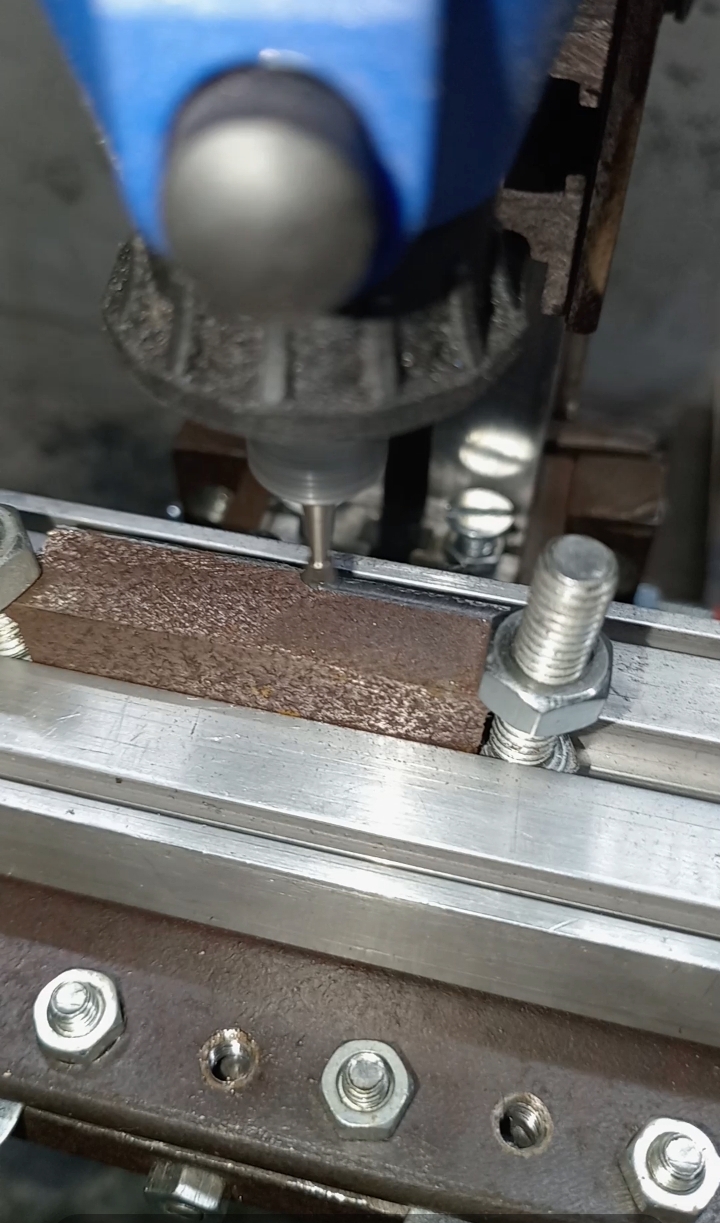

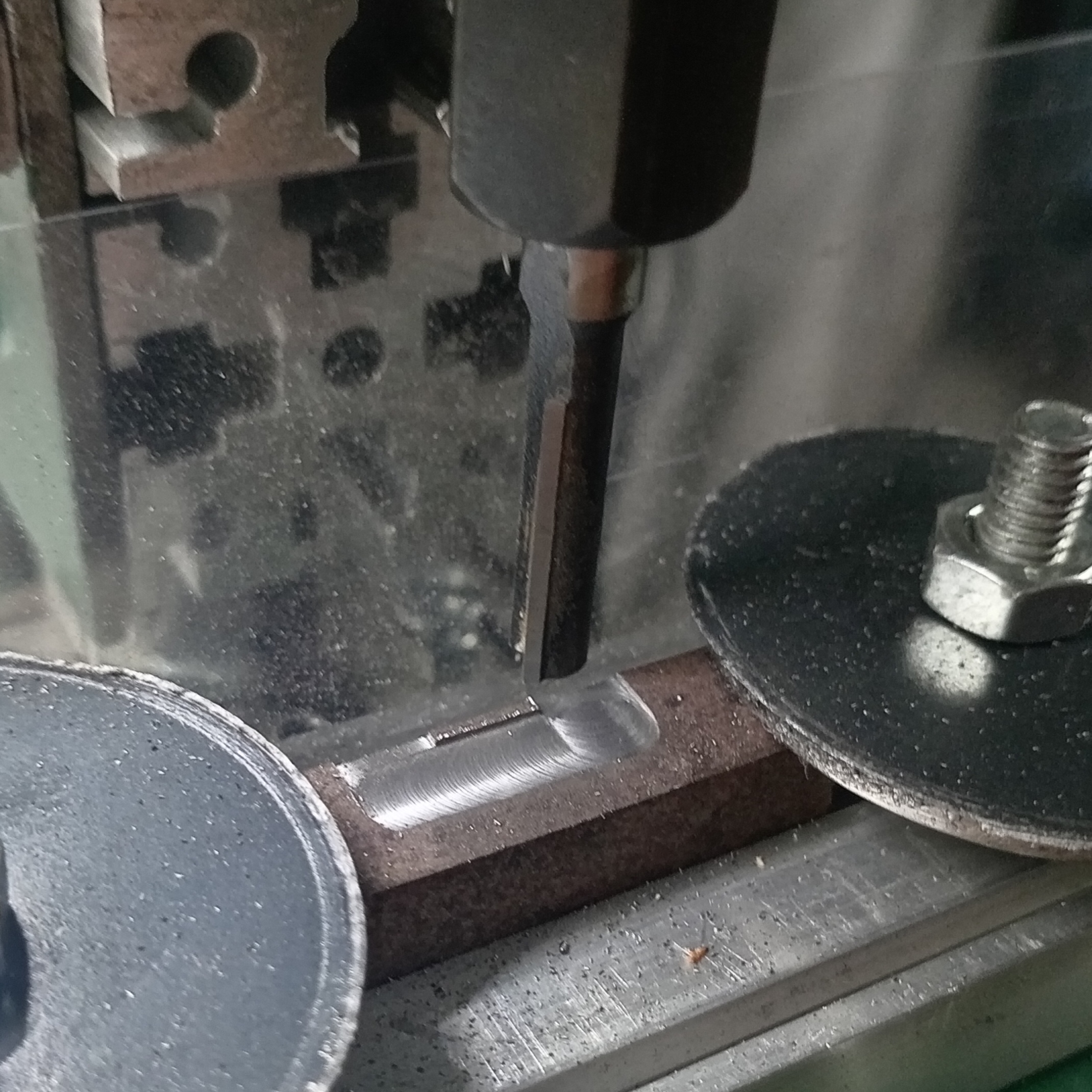

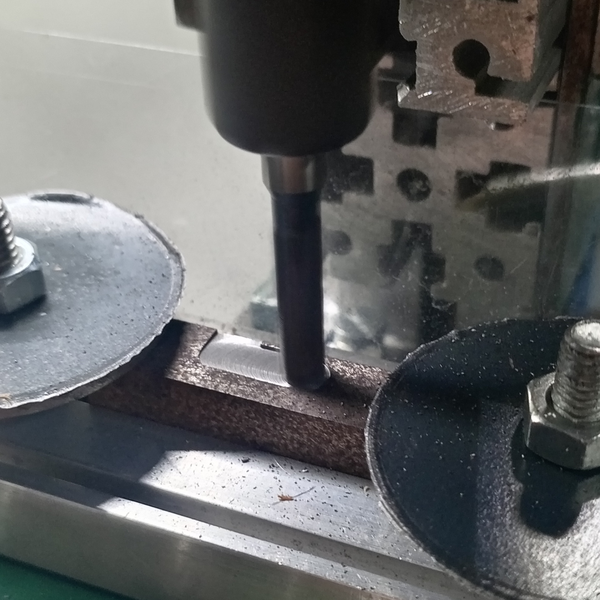

    Close Up Milling Action.

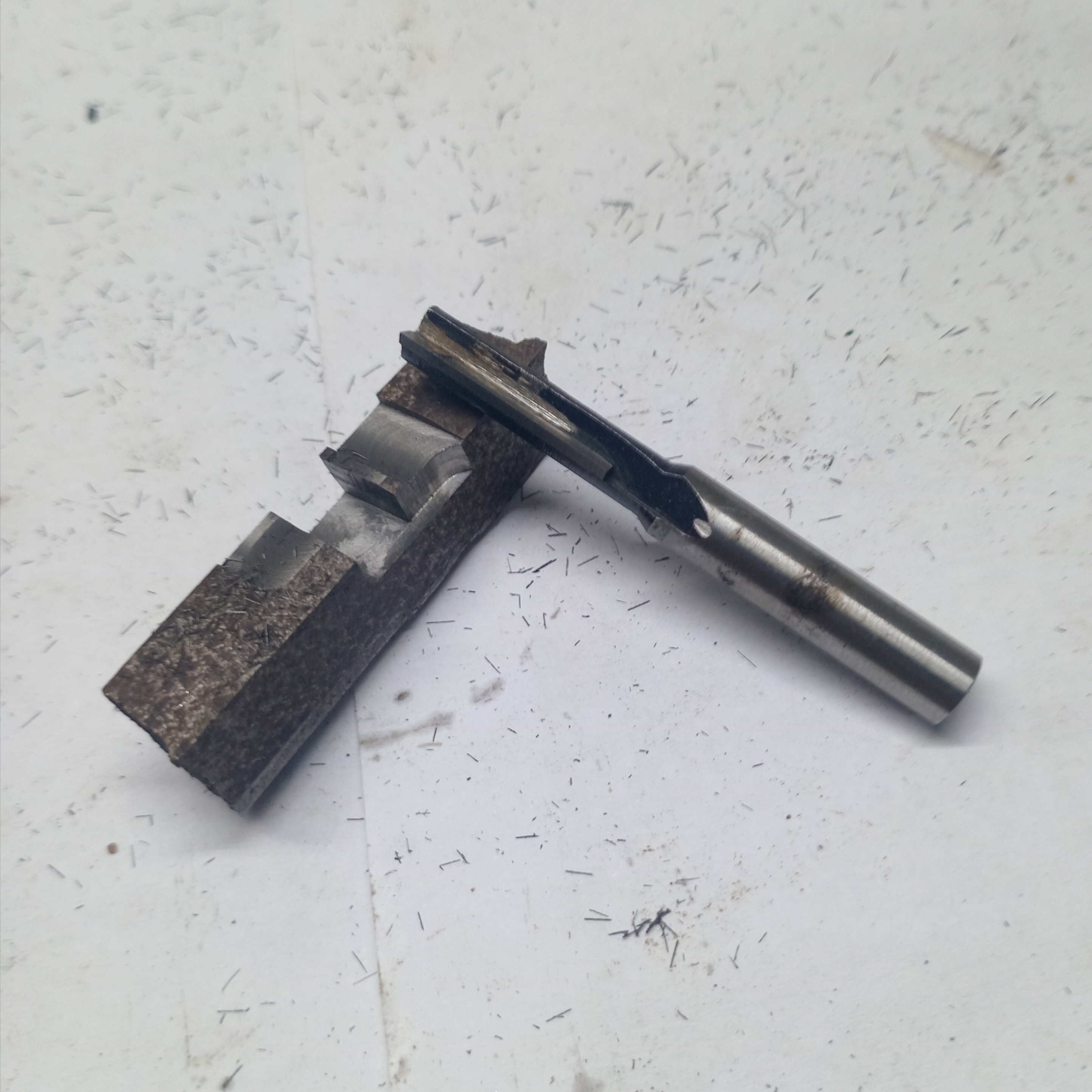

    Tested climb milling, plunging and slot milling without any drama. One notable issue is the lack of machine dampening, although rigid with little to no chatter. from what I can tell, at higher spindle speeds vibrations tend to wiggle things loose.
    Mini Mill - DIY Milling Machine-screenshot_20241007_135900_com.hihonor.photos.jpgMini Mill - DIY Milling Machine-img_20241007_190423_edit_81542745923166.jpgMini Mill - DIY Milling Machine-img_20241007_190507_edit_81524518393549.jpg

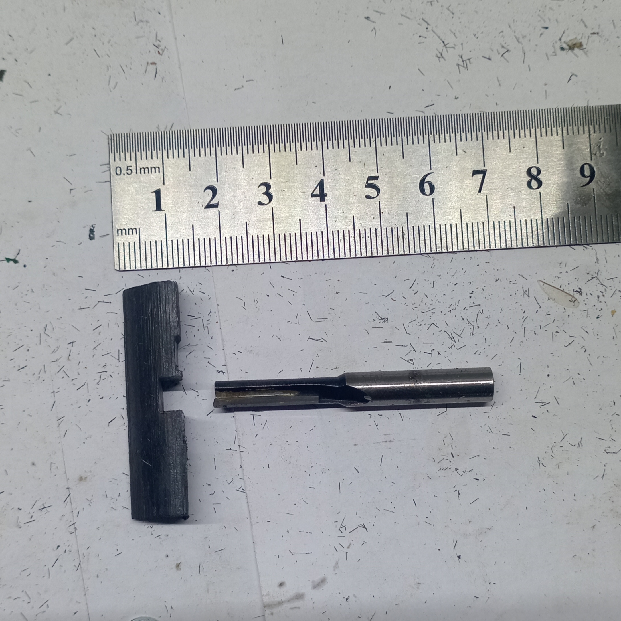

    6 MM 2 Flute Carbide Cutter (Straight Flute) in cast iron plus micro milling with 3 MM HSS dovetail cutter
    Cutting parameters: 0.4 - 4 MM depth of cut. 18000-25000 RPM @ 100-200 MM/MIN full cutter width

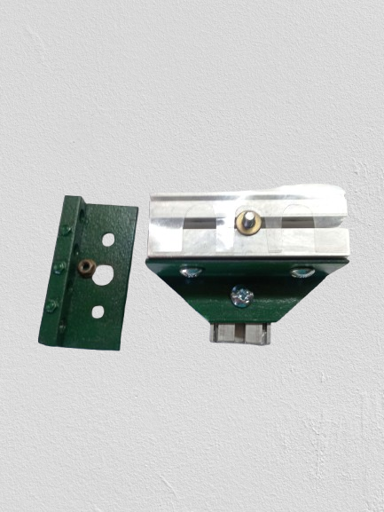

    The threaded holes are for set screws and would be used to level the gibb and remove slop. The holes should have been drilled closer to the operator (offset from the through hole axis'). I had to use thick shims without set screws to achieve the desired results.

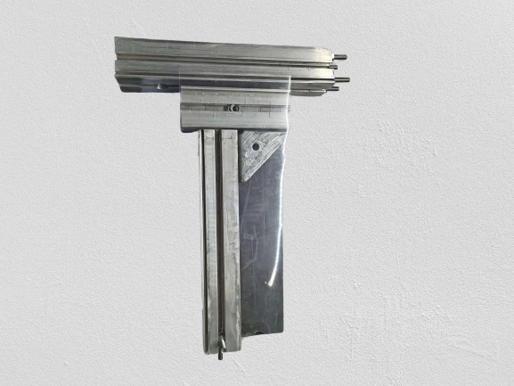

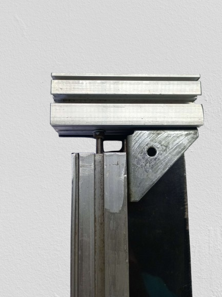

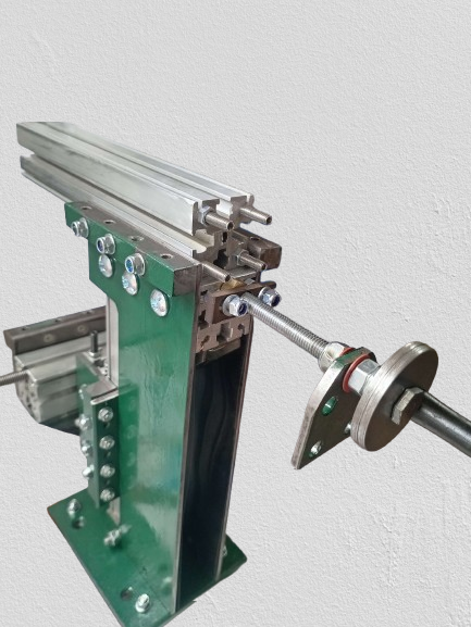

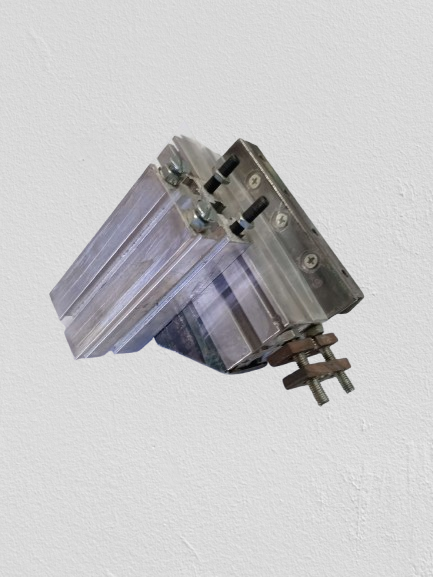

    To avoid drilling into faces of the extrusion I opted to run an M5 rod through the centre and bolt the ram guide block and base plate together through the column. I tested the unit without this rod and it works just fine. Obviously the tool ends up less ridged but it didn't seem terrible.

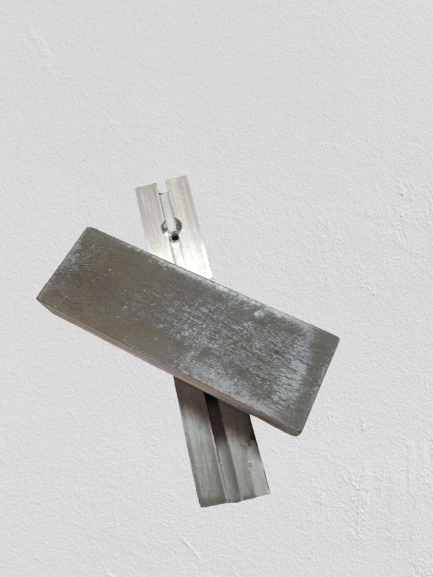

    Metal-on-metal contact is avoided by using book biding cover plastic cut outs with slits cut in them to trap oil. These cut outs are sandwiched between sliding surfaces.
    This same plastic is also used as shim stock when required. I'm sure its not the best all round material but it certainly does the trick and costs pennies a sheet at any stationary shop. I may also like to try gasket paper perhaps.
    All faces of the aluminium extrusions were honed to remove burs and other surface defects.

    This is an excellent build. Is the rigidity noticeably different between the rotary tool and the spindle? Do you happen to have any drawings or diagrams with dimensions?
    Supporting Member cagiva's Avatar
    Apr 2021
    4
    57
    Thanked 9 Times in 1 Post
    cagiva's Tools
    Thank you, glad you approve. The spindle used here is a pretty old Bosch POF 50 Router which has a touch of play in the z axis direction, the rotary tool is new out the box with practically zero play. Even so, there hasn't been a difference in rigidity when taking light cuts. When pushing both tools the rotary tool out performed the Bosch but I think that is more because of the unit being around 20 years old. (Wouldn't try anything bigger than the 370w Bosch, seems right on the money) The whole setup is far more rigid than I'd initially hoped for, really surprised me. Please see an A4 drawing Sheet attached. The drawings are of an earlier prototype but dimensions are basically identical. All metric hardware, etc.
