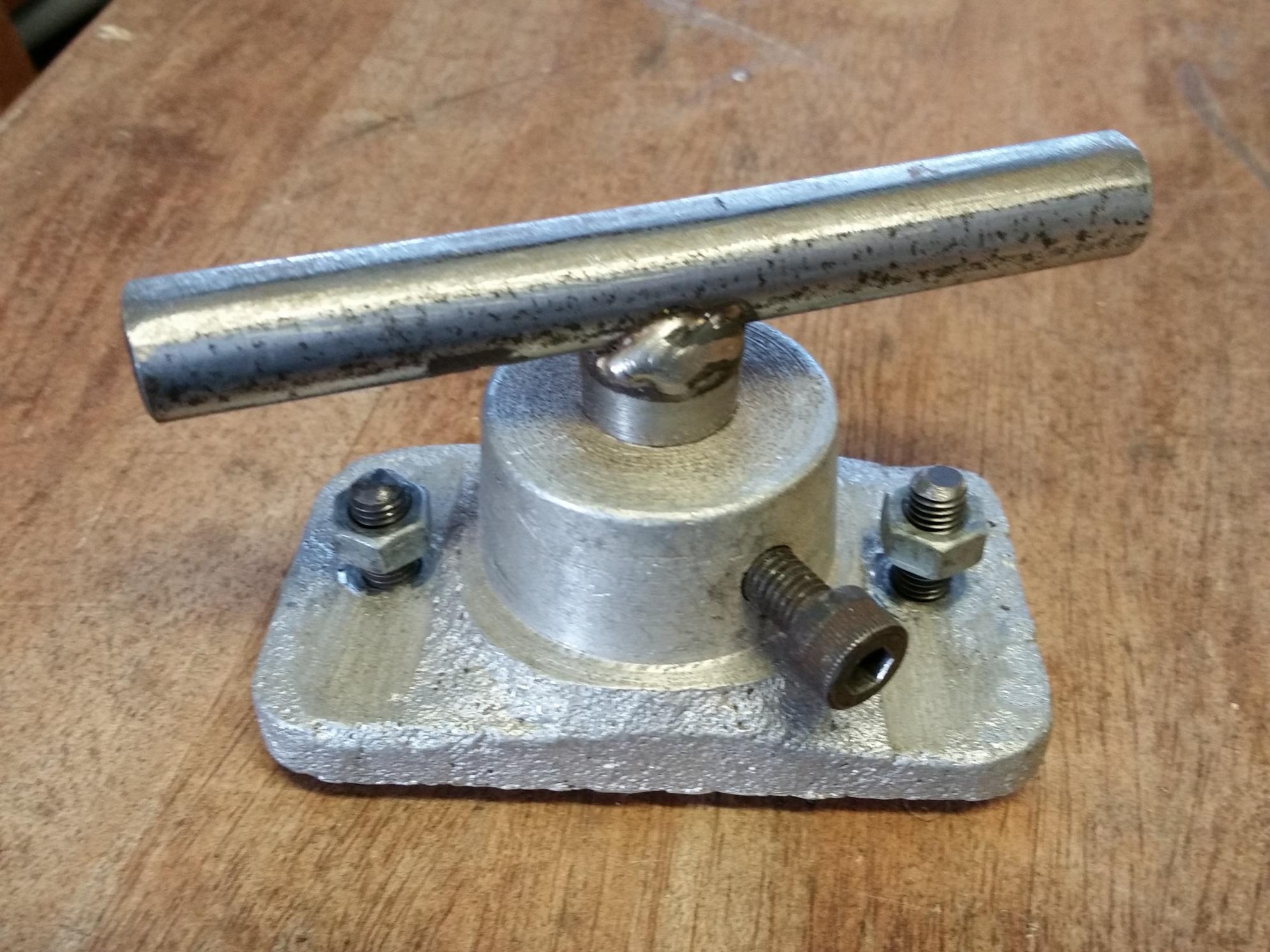

    I do woodturning ... therefore I would like to have a tool post for it to allow me to be set up - when not doing metal -- as a station to turn pens using my EWT carbide cutters. Has anyone made a tool post for this size lathe?

    Wood dust is not good for metal lathes. It tends to wick up oil and rob the sliding precision surfaces of lubrication. Also certain woods, especially roots, can have a lot of sand/grit in them which won't do the precision surfaces any good. Oak contains rust-inducing tannins so you may want to avoid it.
    On the rare occasions when I hand turn metal on my lathe, I improvise a rest by mounting a length of metal in the boring bar holder. This arrangement allows the rest to be easily repositioned by simply turning the holder.
    Metal lathes generally run at speeds much lower than those used for wood lathes. Will you have enough speed to turn small diameter wood such as pens and get a good finish?

    Marv is correct.
    Machine tools depend on sliding surfaces and lubrication far differently than woodworking equipment. Incidental use is feasible if; 1] The ways are fully shielded by plastic such as food wrap, oiled for adherence of desired surfaces. 2] Sufficient RPM is available for the small diameters of pens. 3] Duty cycle of motor isn't exceeded. 4] Lubrication and cleaning are attended to accordingly.
    All manner of examples pertaining to homebuilt wood lathes are in HMT.net. They shouldn't occupy much space, power requirement, or cost. You'll find yourself better served by two machines, I think.
    Wed 10 Aug 2017 0753;
    A recommendation occurred to me in respect to this topic. I'd move carriage far right and place tailstock [if needed to work between centers] inboard, and use 1 thru 4 detailed above. This solution would require a self supporting toolpost, independent of crossslide/ compound, quite like a wood lathe uses normally. This alleviates far more issues connected to dust, lubrication, and fitted surfaces.

    Little Machine Shop sells a wood tool rest and center for the mini lathe. I just bought 1 for my daughter to use on my mini lathe. To prevent any problems I INSIST that she cleans up and wipes down the whole area and lube the bed and anything exposed to wood particles when she's done. Here is a link to LittleMachine.Search For... - LittleMachineShop.com
    This is a small tool rest I made to turn up some odd jobs. As said by the posters before me if you do clean thoroughly and oil after use.

    Yes, it turns nicely, some years ago I turned several intermittent positive pressure valves from acrylic bars, acrylic is not abrasive. Regarding turning wood on a metal lathe, don't avoid doing it. We all use tool post grinders to precision grind round parts, covering the ways and compound with rags. Grinding swarf is much worse than anything found in wood, except, maybe industrial diamonds. I have been grinding on my South Bend 9" lathe occasionally for the past 67 years, with no harmful effects.
    Since you are not generating red hot sparks, slightly oiled rags will do a great job of trapping particles, while lubricating the ways and compound. Just don't store oiled rags
    bunched up, indoors, Hang them over something preferably outside, to avoid heat building up heat leading to spontaneous combustion. In the shop, oily rags are stored in a steel drum with a tight lid.

    I agree. Turning wood isn't the issue, the effects are. A bit of preparation insures those won't cause problems.
    As far as toolpost grinding I differ soundly. While an old practice and recommendation, rags are not reliable. Rags, oiled or not, are generally ineffective barriers to abrasive grit, the bonding resins, and metallic fines [particles] produced. The density of cover material has to be higher than the smallest particles. Examine back side of an engine air or oil filter!
    Oiled, I use wax paper, newsprint, plastic food wrap etc to attain a far more effective 'seal' against particle invasions. Drape over required surfaces in the same manner shingles are laid to shed unwanted material, to be removed in the reverse they are applied.
