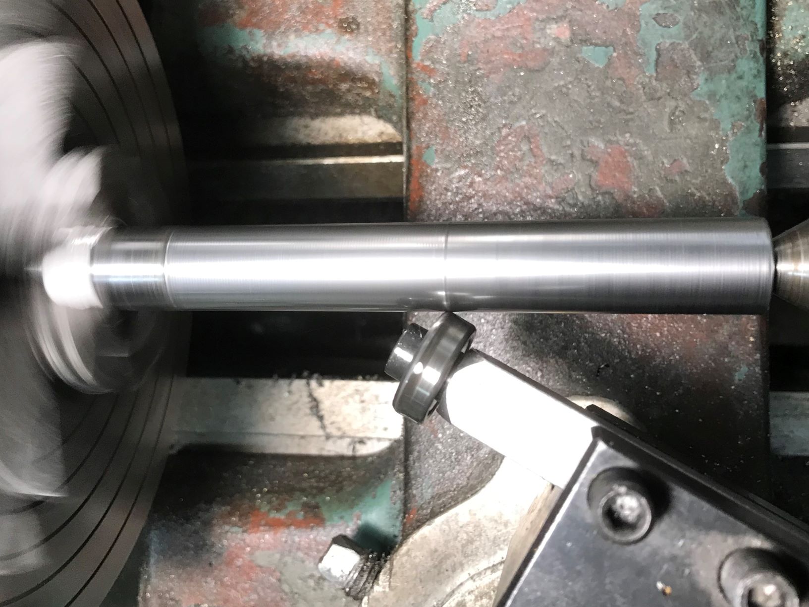

    Nice build with surprisingly meagre results.
    As the guy asks for suggestions here's my 2 cents :
    Tighten all gibs and check lathe rigidity, especially the compound - try replace it with another block bolted to the cross slide directly.
    Check the grinder's runout, check/ dress uneven surfaces of the wheel for minimum unbalance.
    I use these Proxxon wheels myself, and a red one is right for plain steel, AFAIK.
    In my chinese Hilda cheapo grinder I get excellent results with these 60 grit disks in DIYed arbors when tried on BMS.
    I always use Saran Wrap around my chuck when grinding and freshly wetted "bedsheets" on the lathe, but still awfully messy and noisy.

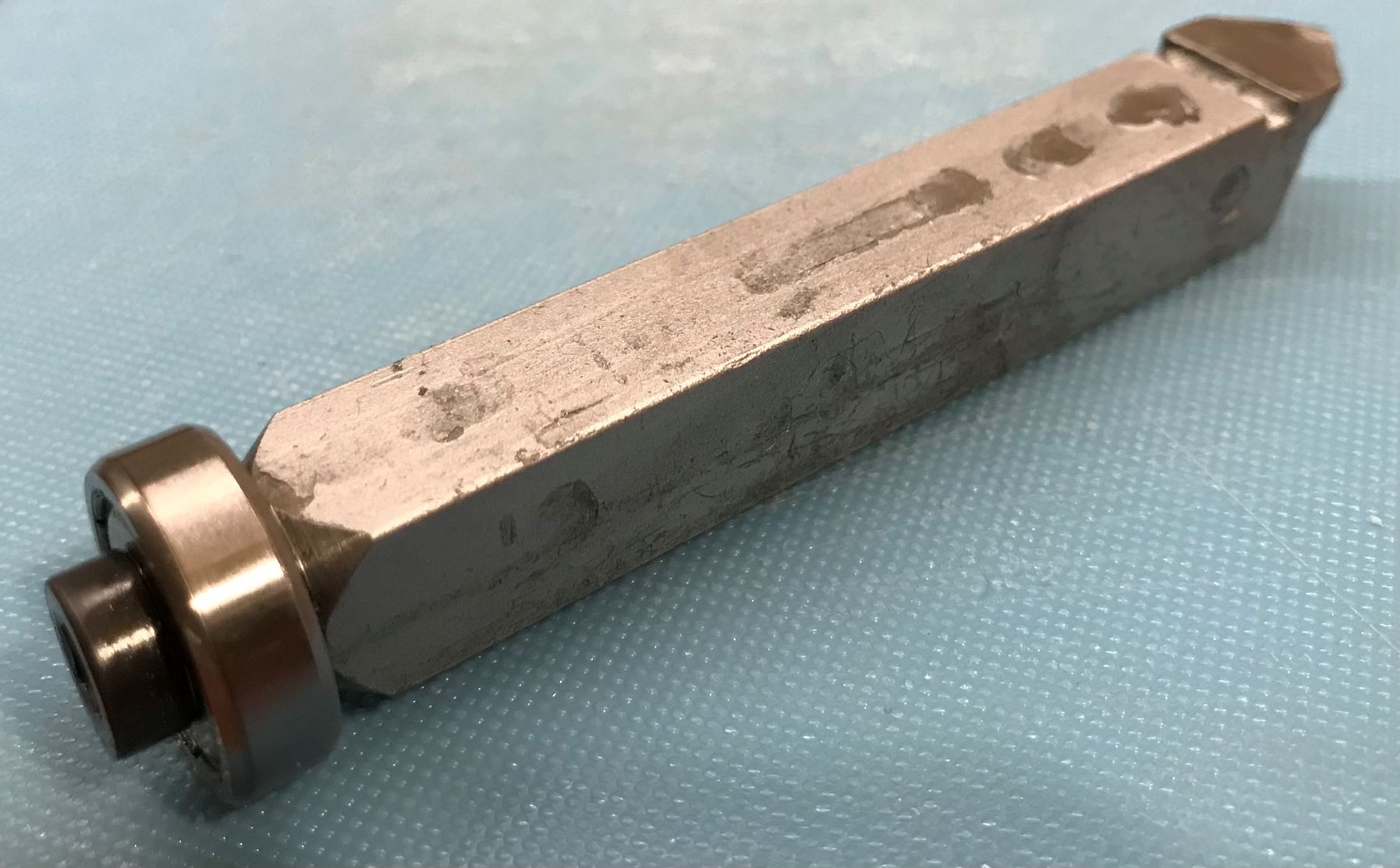

    Today, for a really nice finish on coarse turned hot rolled, I first use a shear tool (a ground 8 mm masonry drill bit slanted 20 degs in a square holder), and then finish off by "cold rolling"/ burnishing the last 1/1000 of a mm, with a cheapo ball bearing mounted like so:
    Mini lathe toolpost grinder - video-cold-rolling-some-hot-rolled.jpg Mini lathe toolpost grinder - video-ball-bearing-burnisher-truer.jpg
    Über-fine feed & 1 krpm, infeed 2-3 thou for MY setup. Rust seems to not set as easily on it either (as it does on merely turned).
    Originally "pimped" this odd-looking brazed carbide tool for truing pieces in the 3-jaw.
