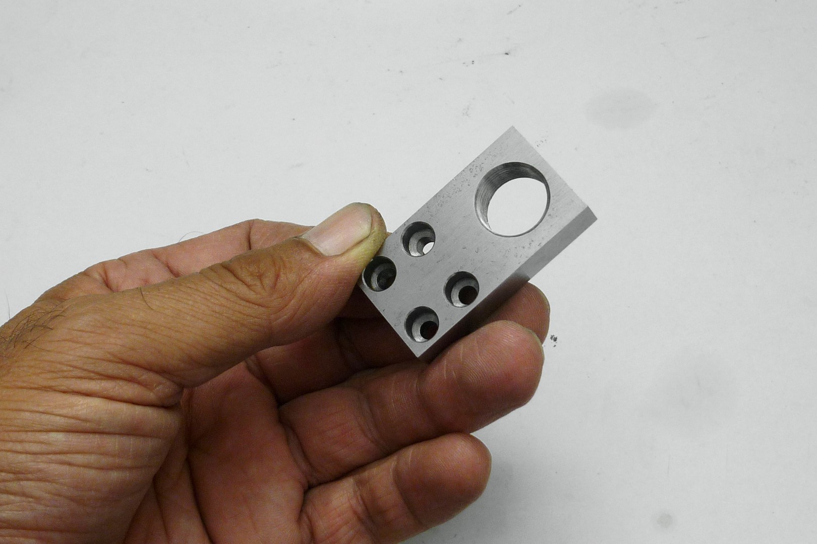

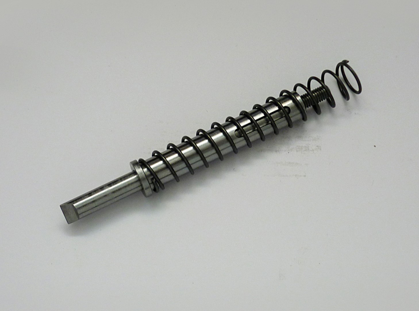

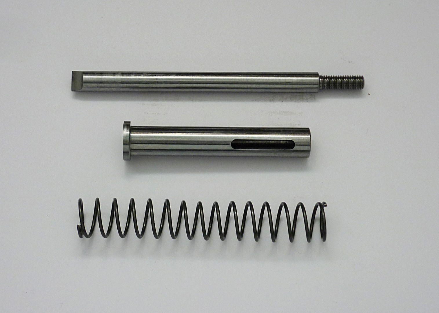

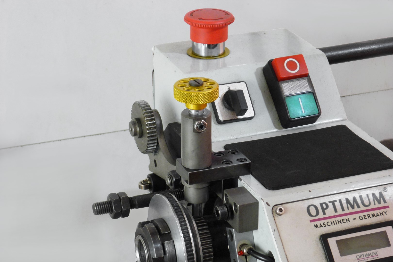

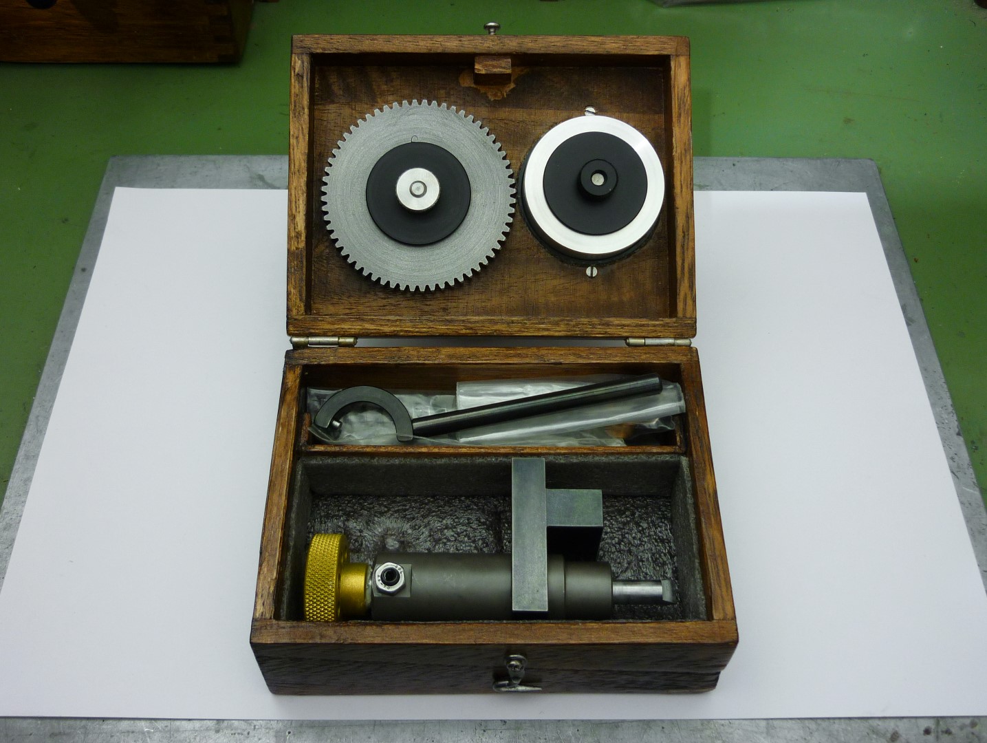

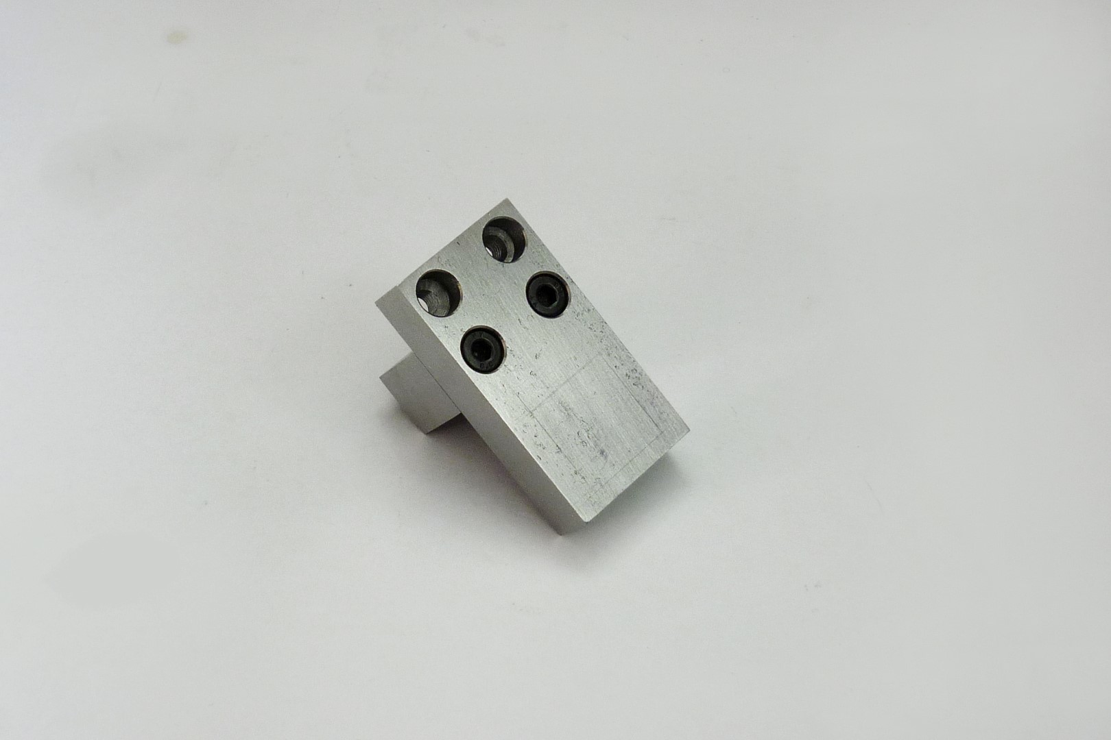

    Hello all,

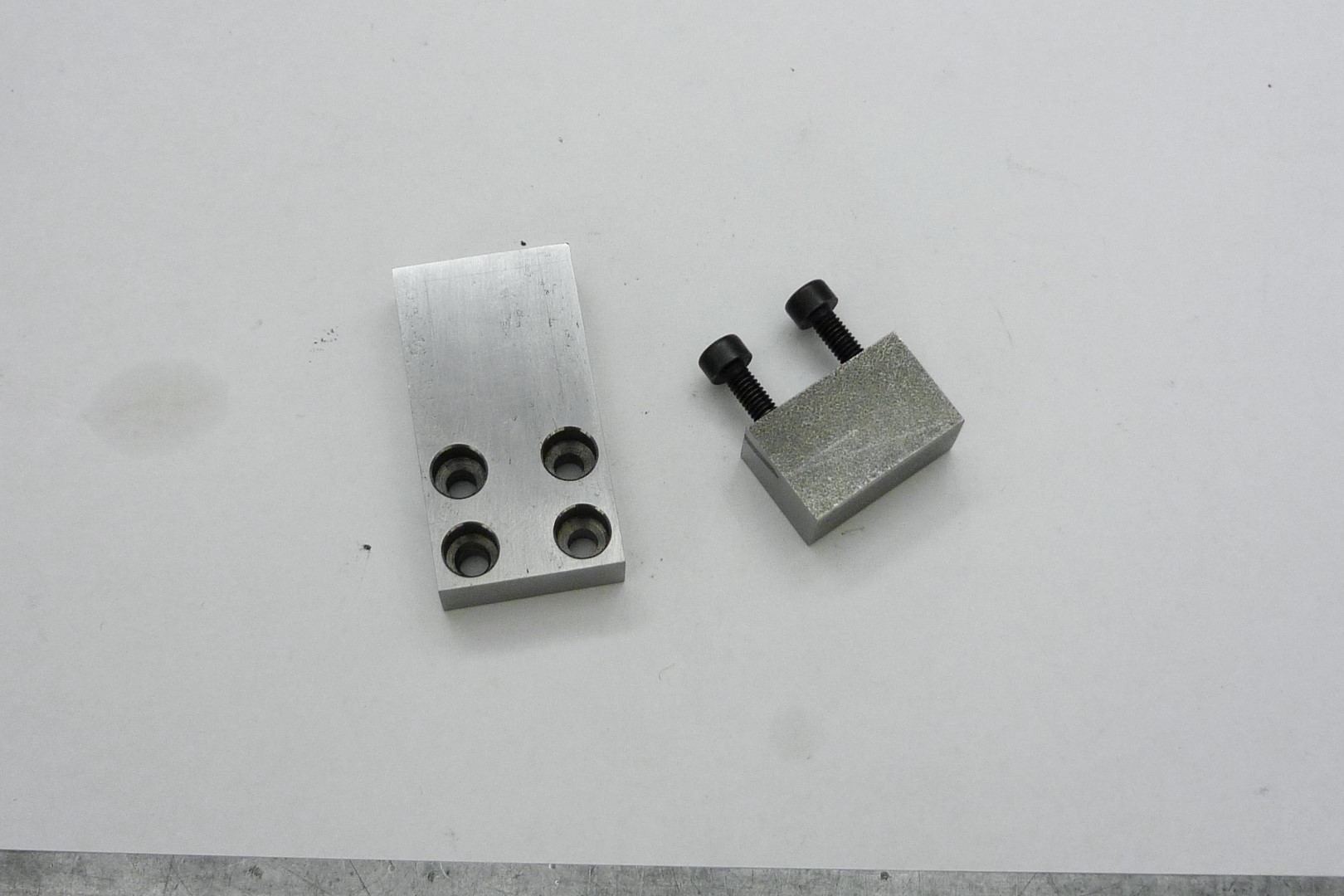

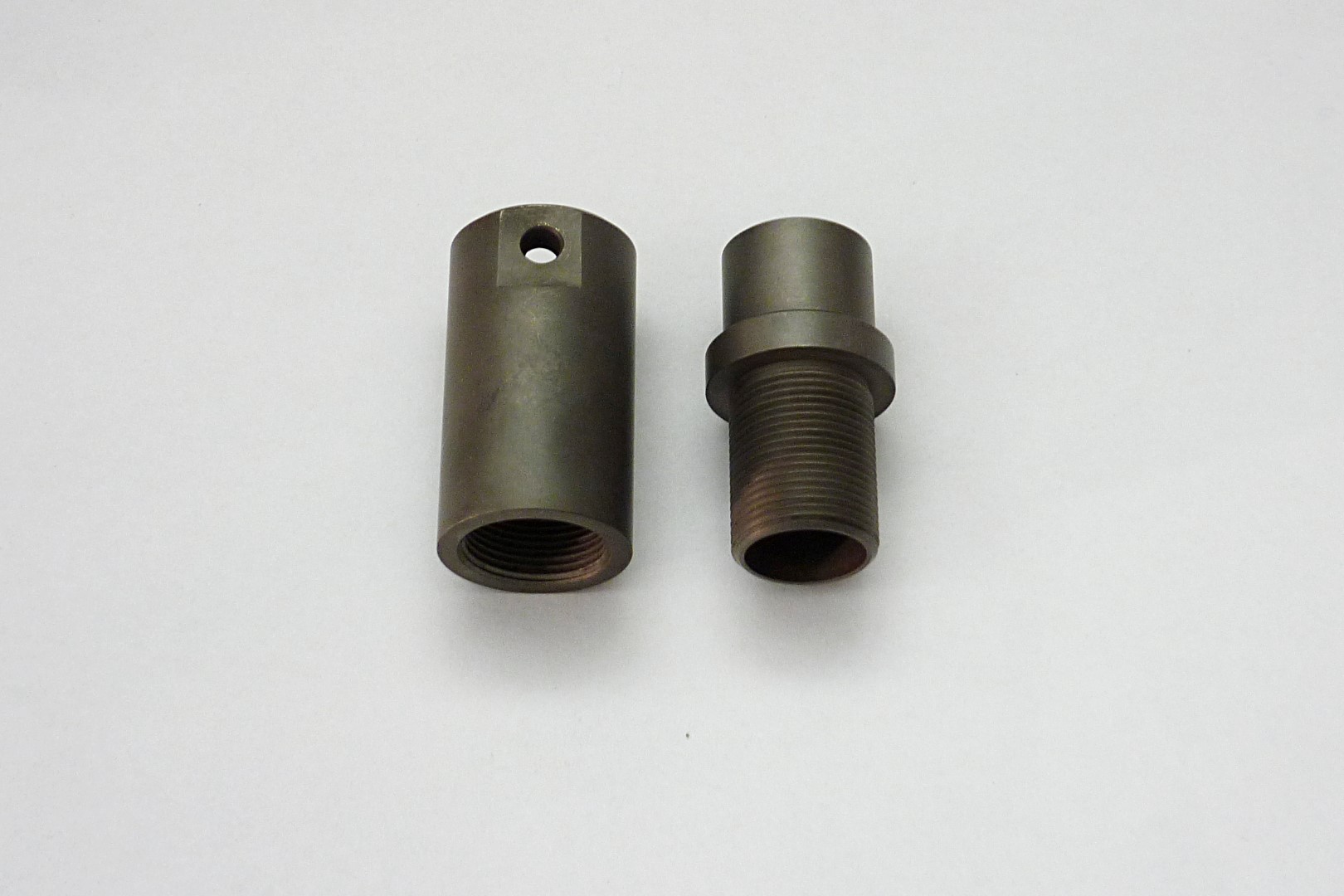

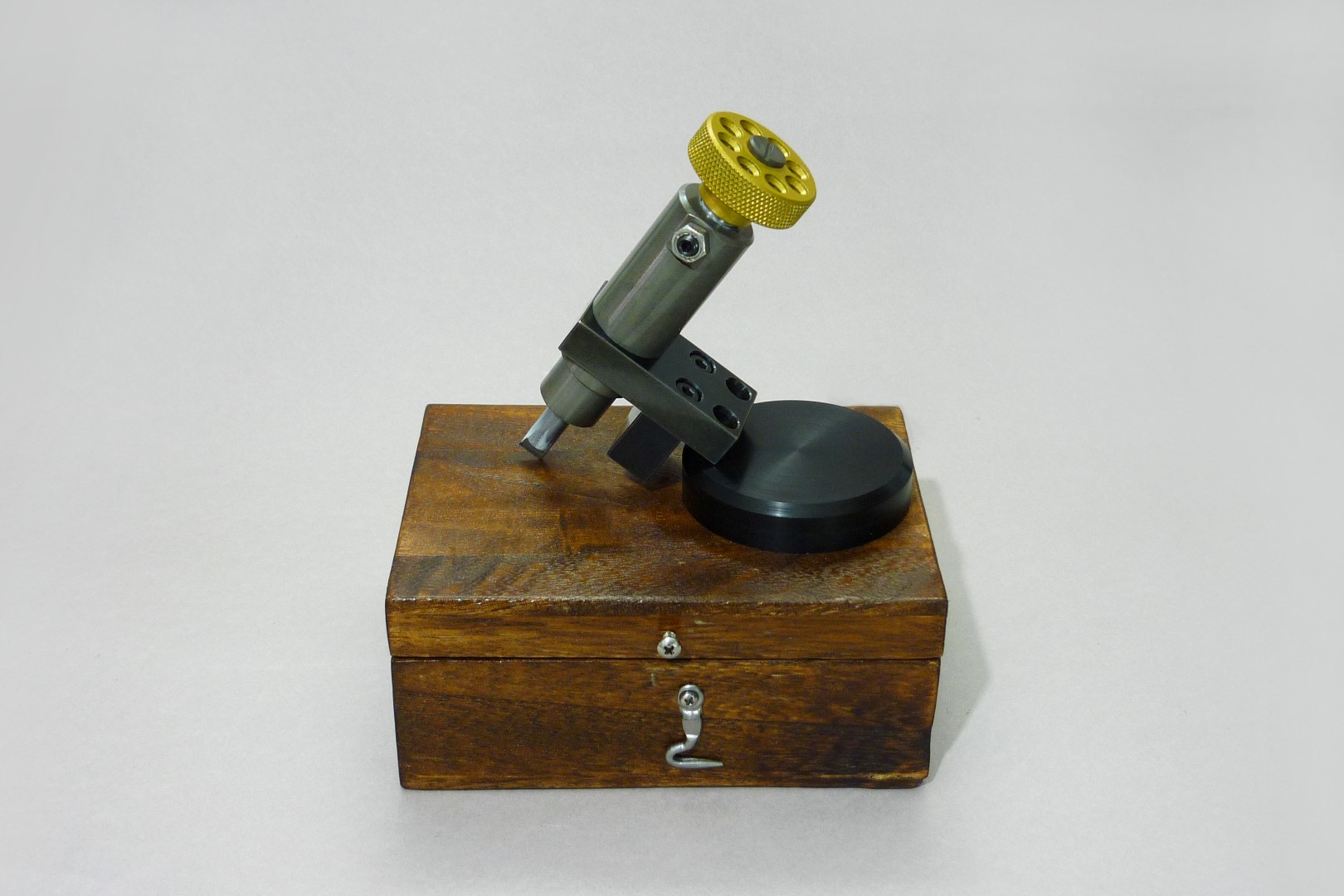

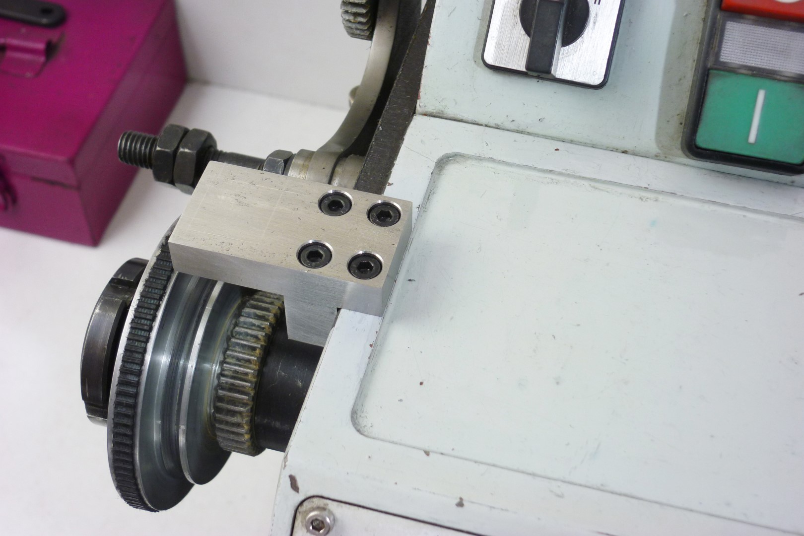

    I would like to share with you one more of my favorite projects, the spindle indexer; it was on the project’s wanted list for quite some time now, I managed to finish it a few months ago and I’ve be using it in every given chance.
    The tool is simple in design; it consists of an L shape base, a cylinder and a spring loaded moving plunger.
    Mini lathe spindle indexer-p1130235-large-.jpg Mini lathe spindle indexer-p1130236-large-.jpg Mini lathe spindle indexer-p1130239-large-.jpg Mini lathe spindle indexer-p1130261-large-.jpg Mini lathe spindle indexer-p1130332-large-.jpg Mini lathe spindle indexer-p1130334-large-.jpg Mini lathe spindle indexer-p1130335-large-.jpg Mini lathe spindle indexer-p1130365-large-.jpg Mini lathe spindle indexer-p1130513-large-.jpg Mini lathe spindle indexer-p1130514-large-.jpg Mini lathe spindle indexer-p1130515-large-.jpg
    In the video you will find more information about the design and how the indexer works.
    Cheers
    Dimitris

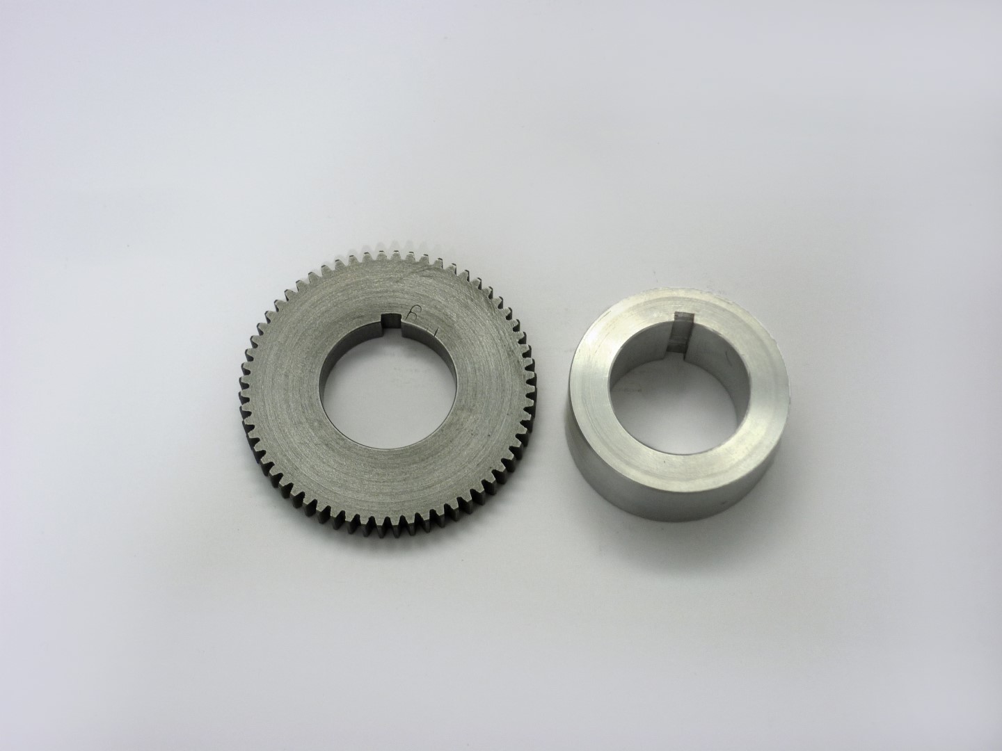

    Thanks JR, glad that you like it! Although the 40T drive gear has some wear from usage, the plunger fits really nice and gives repeated accuracy.
    I think that it will be a nice addition for your mini lathe; I'm sure with your skills and machines that you will make an improved version of this indexer.

    Very nice workmanship! The hard part with these indexing solutions is getting the pin in the right location. This makes me wonder about the feasibility of marking common divisions on the pulley replacement collar. I’ve ran into these sorts of issues at work with a 24 count indexer, it is very easy to be off by one making a mess of things. I’d be interested to know how others solve this problem!

    Yes it’s a bit difficult setting the pin into the right location, it’s very narrow the space between the drive gear and the pulley and it’s easy to make mistakes; so, I double check every time to be absolutely sure about the location. I think that the best I can do, is to use a steel stamp to mark on the pulley 40 and 60 divisions. The keyway on the spindle provides standard location for both the gear and pulley, so based on this I can mark the divisions on the pulley; this way it will be difficult to make mistake because the diameter on each gear is different as well as that each series of numbers will be painted with different color.
