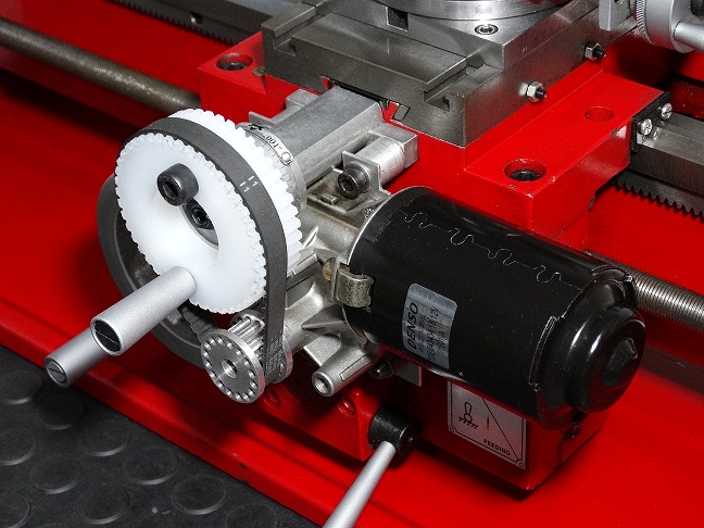

    Finally I completed the assembly step of my power feed. I carried out this project without making any changes in the physical structure of the machine (hole, thread, weld, cut, etc.). I was able to install the automatic control using only scrap material. I will soon show you the mechanism in operation. If you are interested, be sure to follow my updates!

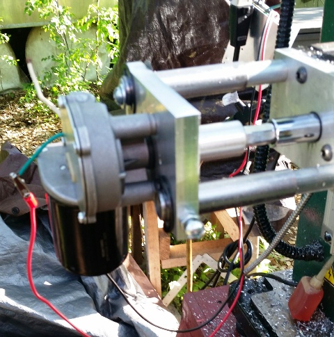

    I used a Dodge Ram wiper motor for the power feed on my milling machine and a year later it's still doing what I need it to do. In the motor there are 3 brushes, a common, a low speed and a high speed brush which produce 2 speeds but I found that if you isolate the common from the case (which connects back to the battery negative) then you can apply power across the low and high speed brushes and get a third fastest speed. I used a 3 gang, 6 position rotary switch to control it and I have 3 table speeds in each direction. I included a power switch for off and limit switches at each end of the table's travel to automatically stop the drive at each end and with an adjustable spindle speed I can adjust it for a good cut at any particular table feed.
    Here it is before I wired it up. There's a stub shaft on the end of my lead screw connected to a deep socket and a hex stub connected to the motor and the motor assembly slides in or out on pins to engage or disengage the feed. I included a brass shear pin in case of motor stalls but I suspect that the plastic gear inside the motor protects the shear pin so I always keep my thumb on the off switch.
    Wiper motors deliver a surprising amount of torque and are handy and affordable for a variety of projects.

    Thanks for the comment Crusty! My version is unlike any you've seen... If you are interested, wait for my updates!

    Quote Originally Posted by machining 4 all View Post
    is there a way to disengage the motor when you want to manually move the wheel?
    I saw one a few years ago that used an electromagnetic clutch that was only engaged with 12vdc.

    Thank you for your interest Nitrous! Yes, it is possible, but in this project this is done mechanically, when it is necessary to perform a quick return. I did not use any electrical device in this project (except the wiper motor, of course).

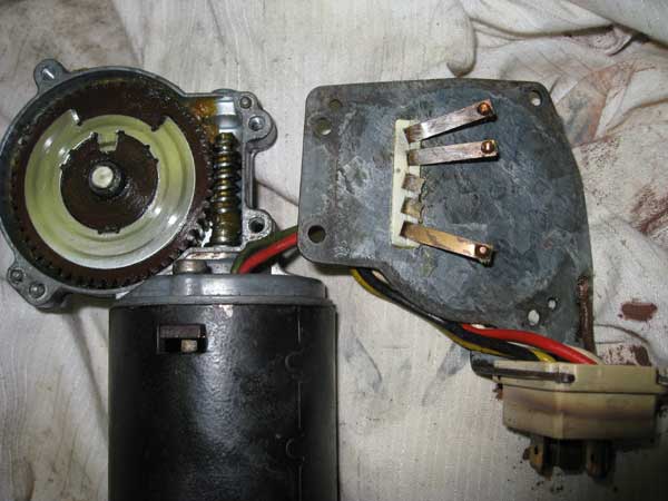

    Wiper motor, what an interesting idea. It is DC so it is reversible. Looks like a geared motor so slow speeds are possible. A quick check showed some are available for under $25. Sounds like a great choice for projects.
    One question, does the average wiper motor have a back and forth mechanism built in or is that normally separate from the motor itself?

    Thank you for your interest Paul Alciatore! In general, a motor wiper has a mechanical part (crown and screw with worm thread) and an electronic part (controller board). Depending on the model, it can work separately, without making the movement back and forth (which is performed by a disc and by contactors). If you have access, in the junk you may be able to find it for a friendlier price or even for free!
