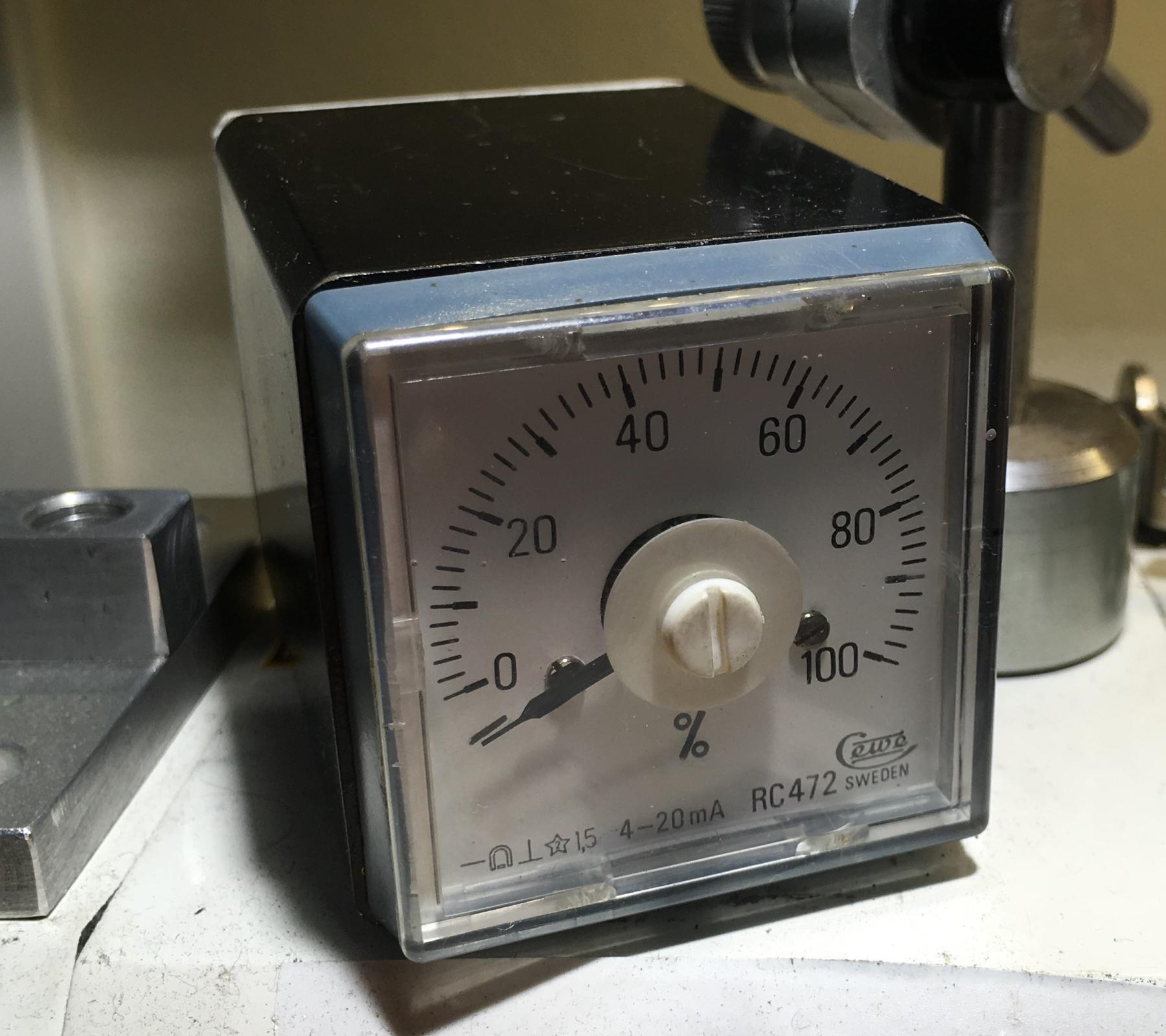

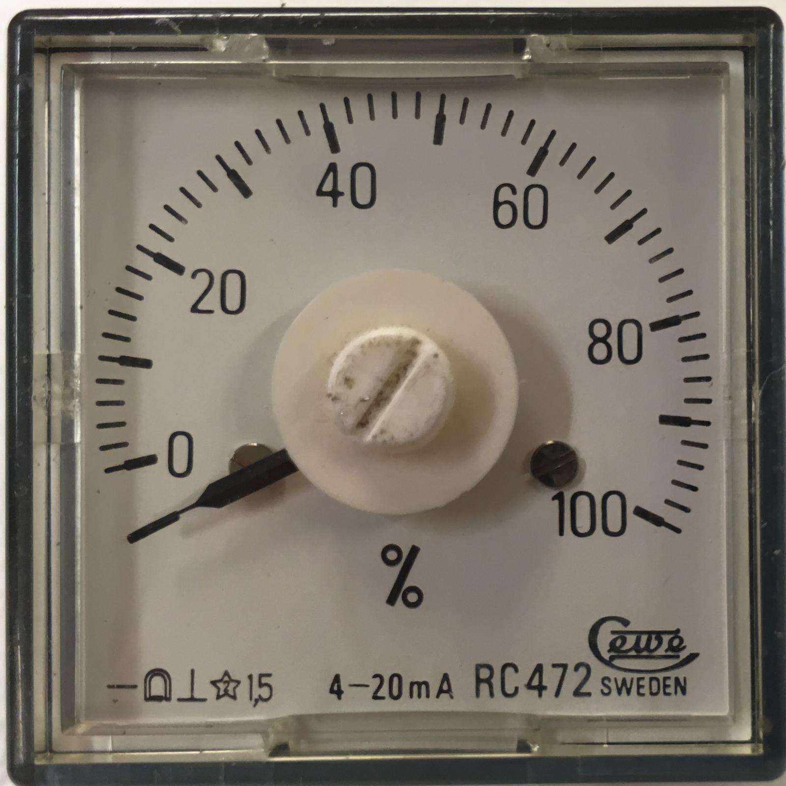

    At the same time I had some luck in finding two of these in the electronics recycling dumpster at work:
    As you see: a 1,5% 4-20 mA industry standard panel ammeter from the seventies with a 49 x 49 mm front.
    Great brand, still around and used in power plants over here and a 5% one could even be had today for some 125 bucks.
    Sheer luck got me two for free, with better tolerances than store-bought ones.
    Thinking it would be great to also be able to have a "quick visual" (apart from just hearing) of the motor's loading when turning.
    A few of my smart-a$$ed hi-tech IT colleagues yakked about it being "old-school analogue", which for me is absolutely crucial:
    When hogging in, I want a fast and direct, instinctive feel of a scale pointer reading -
    NOT having to read some number AND do some math in my head BEFORE EVENTUALLY deciding to ease off or shut down
    . Enuff ranting.

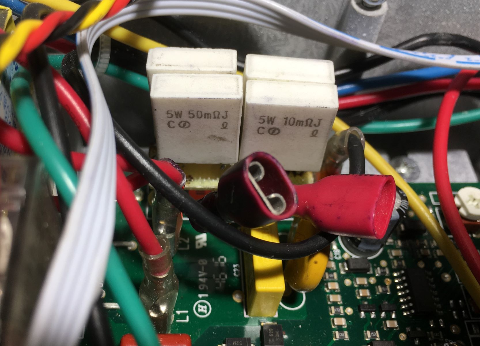

    Board manual* instead states (for a ¾ hp/ 550W motor) a resistor of 0.035 and a 150% CL trimmer level,
    where 100% is the nominal 3.3 Amps @ 180 V armature voltage.
    Not having such a resistor – I checked my electronics stash and found a coupla used 50 & 10 milli-ohm 5W ones:
    Mini Lathe KBIC controller tweak & Ammeter addition-hp-resistors-lead-outs.jpg
    When soldered in series-parallel (on the board, instead of the original 0.1 one) they got me the right resistance of 0.030 ohms.
    The open connectors will be explained below
    Providence then shone its light upon your humble narrator,
    so that the voltage drop over this resistor combo was 100 mV @ 3.0 Amps out, but that also reached
    the 80% point on my (free) ammeter.
    Then: setting the CL trimmer for 120% (instead of the 150 as per instructions) became the FSD point on the meter.
    So the ammeter was just be connected in parallel with these two resistors, and it’ll be up and running!
    Simple, cheap (literally!) and fast!
    So this is what it looks like today, sitting on top of the headstock:
    Meter put in a piece of 50 x 50 mm hot rolled box tubing, sprayed black with two magnets glued at the bottom,
    and fitted with a plastic rear end with a cutout for the cable.

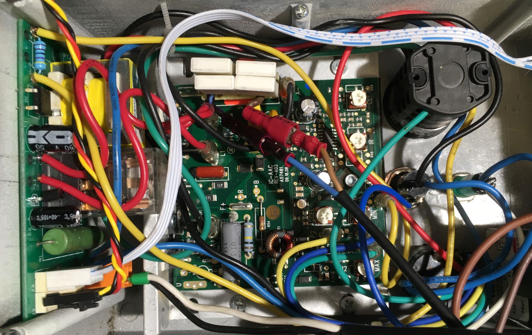

    The internals of the control box: HP resistors top centre, then Ammeter cable (max 400VAC) via extra connectors:
    Caution: -Though this cable doesn't conduct high current, it is at live voltage, and should thus be properly insulated and installed
    (tip: nicely fitted under the cable shield running up to the Chuck guard breaker).
    Mission completed: Now the motor can deliver, AND I can instantly see how much it works. All this for free!
