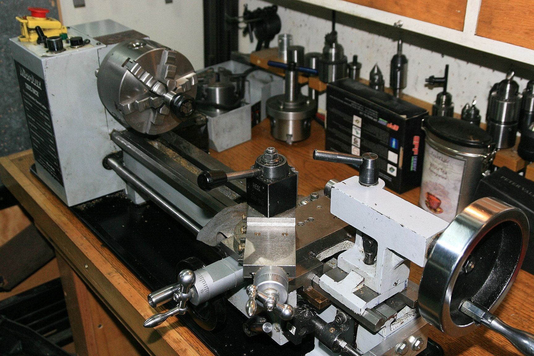

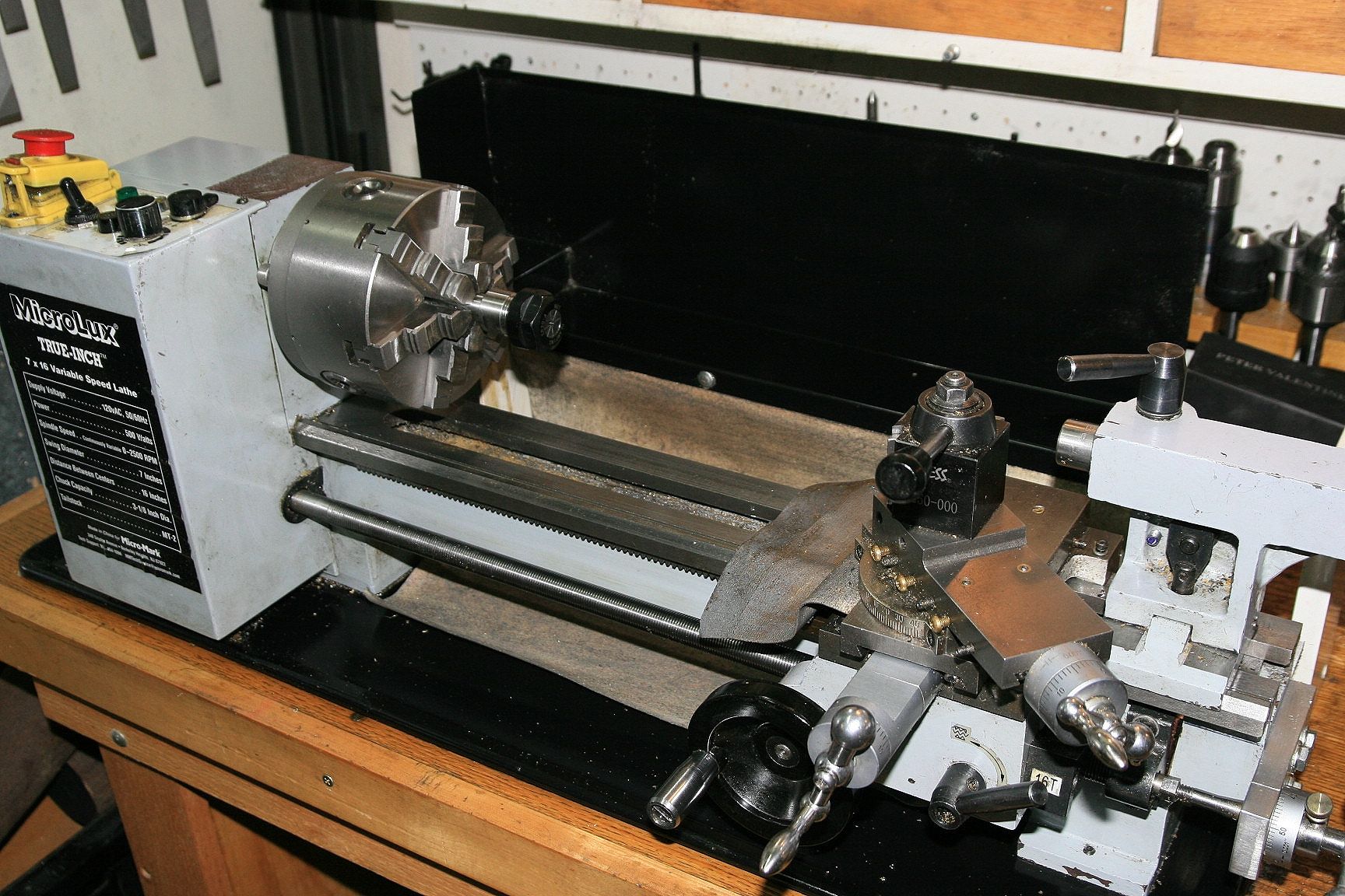

    The rear chip guard gets in the way when installing my taper turning attachment and the
    digital caliper carriage travel tool. Both need access to the rear of the lathe.

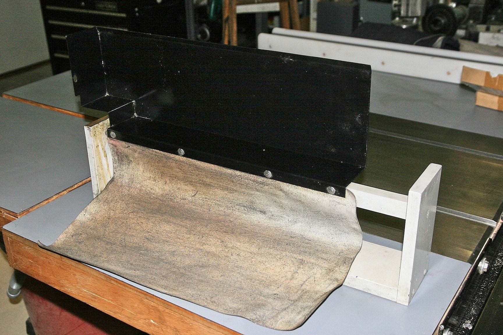

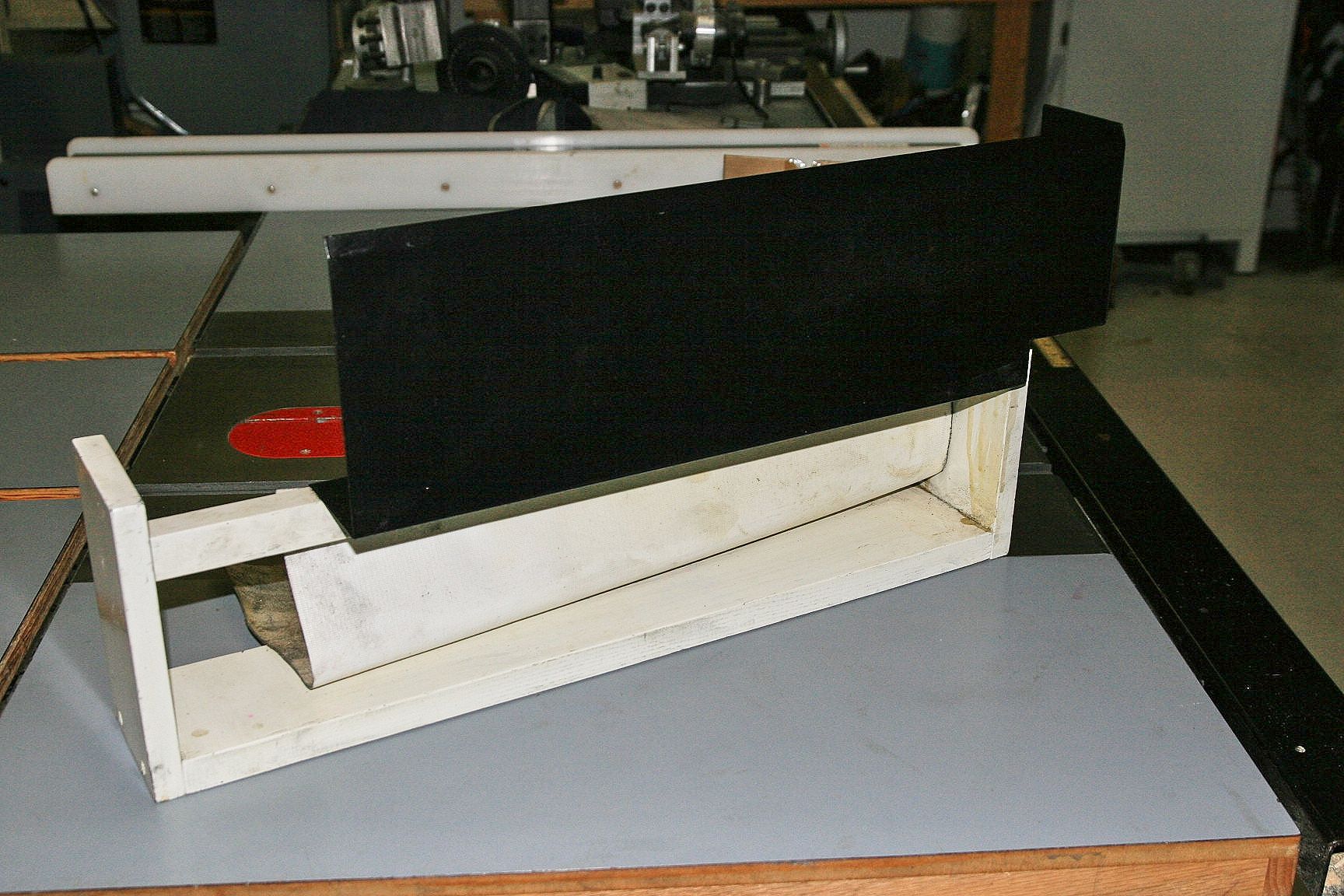

    Made up a simple stand and mounted the original chip back guard to it. Added some
    plastic material to guide the chips to the main chip pan under the lathe.
    This makes cleaning up the chips easier and provides access to the rear of the lathe.
    Cheers, JR
