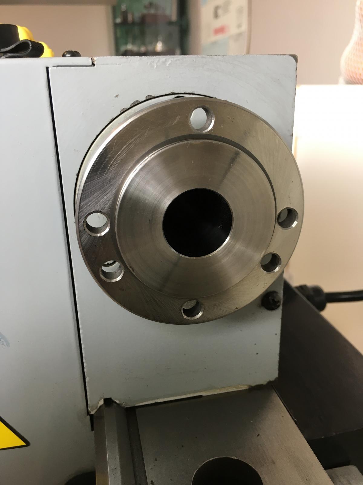

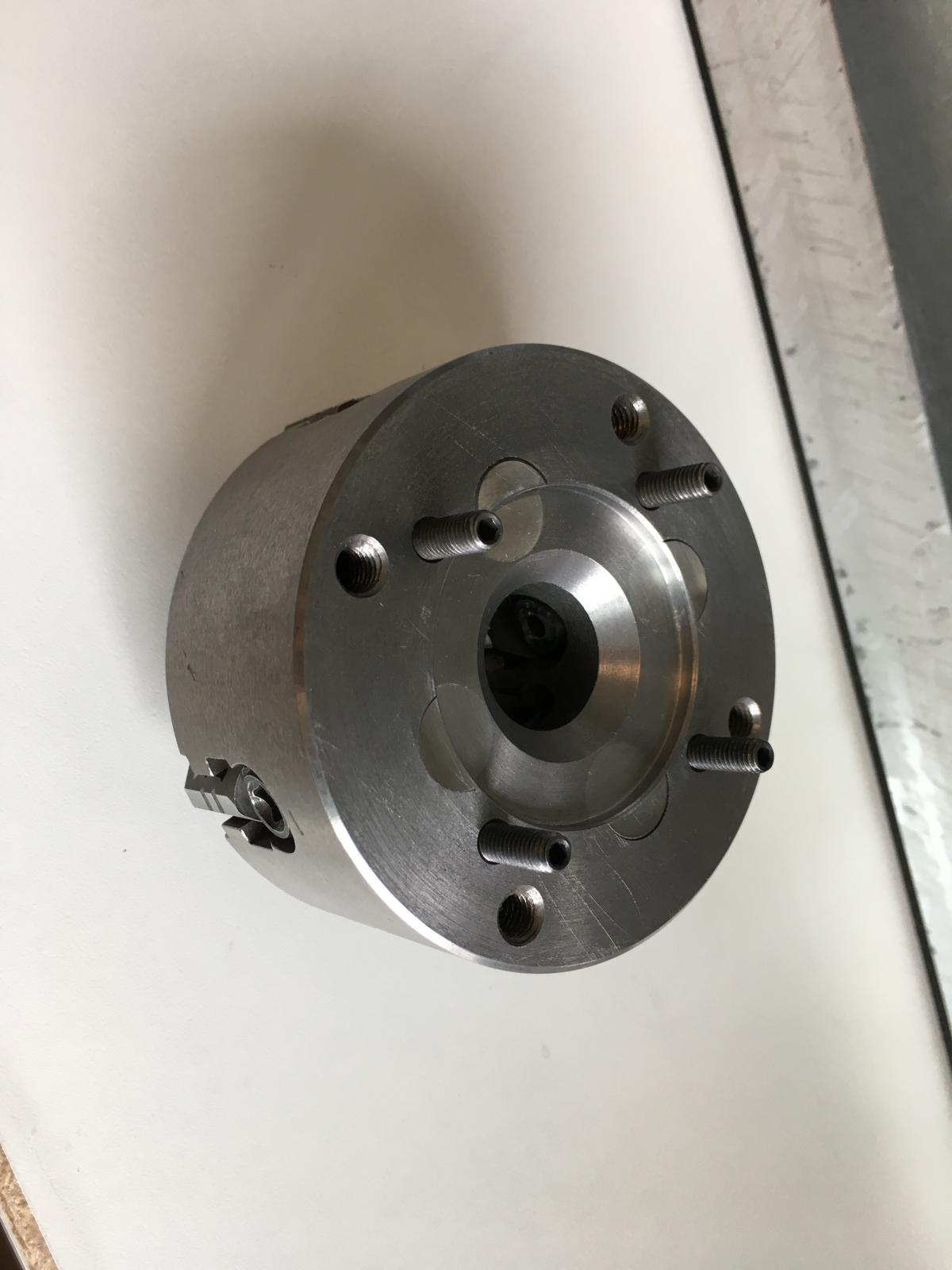

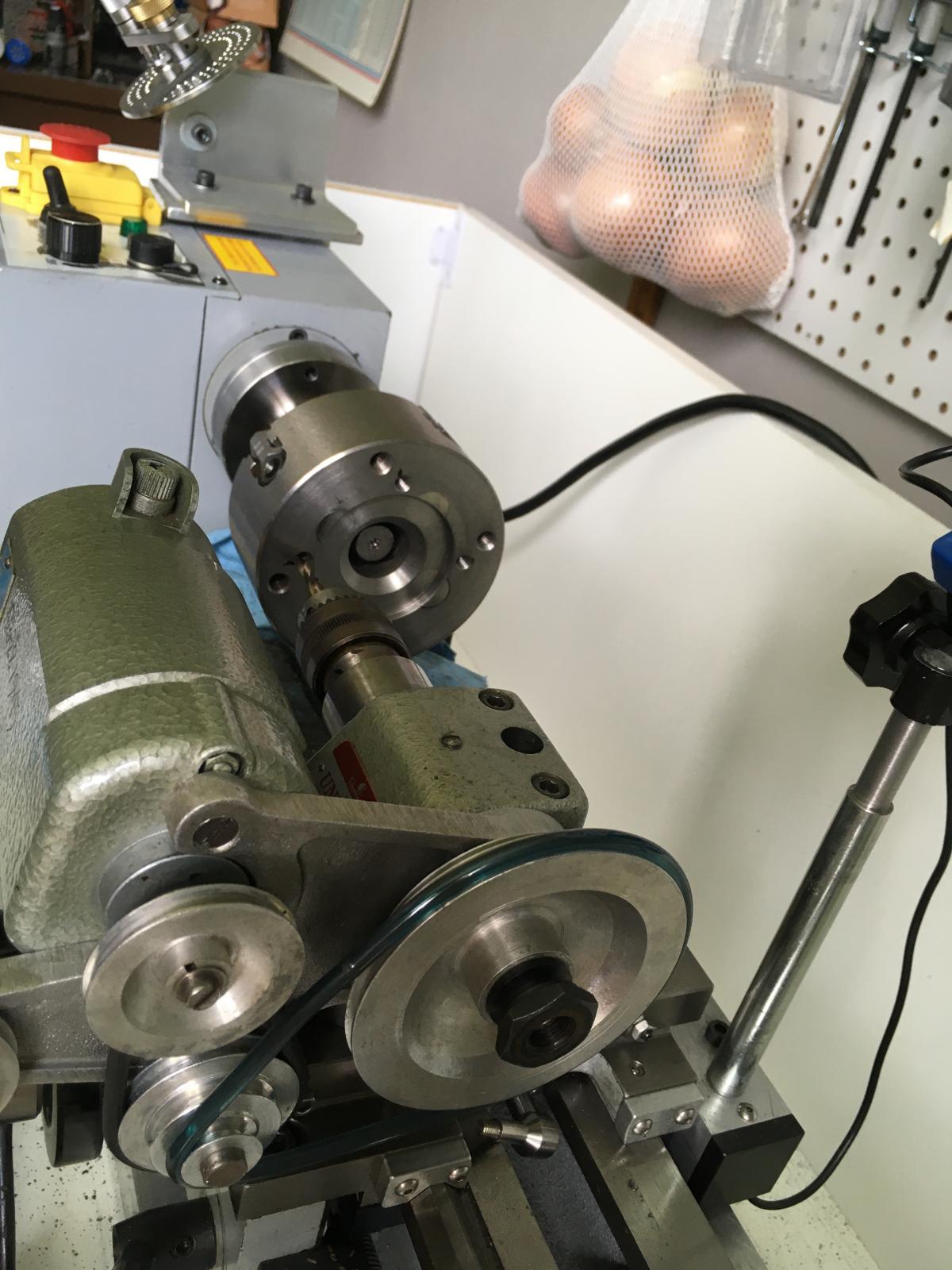

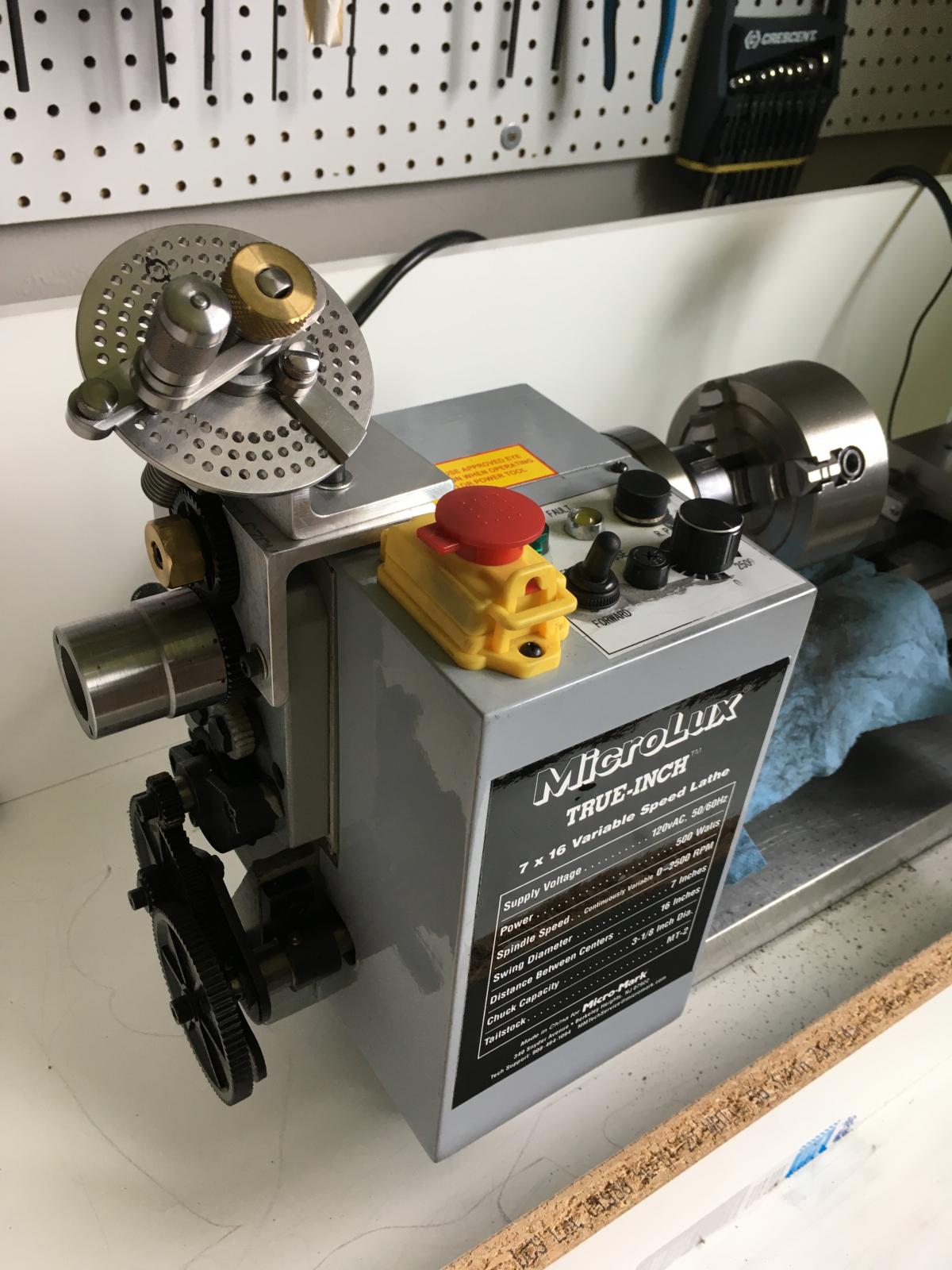

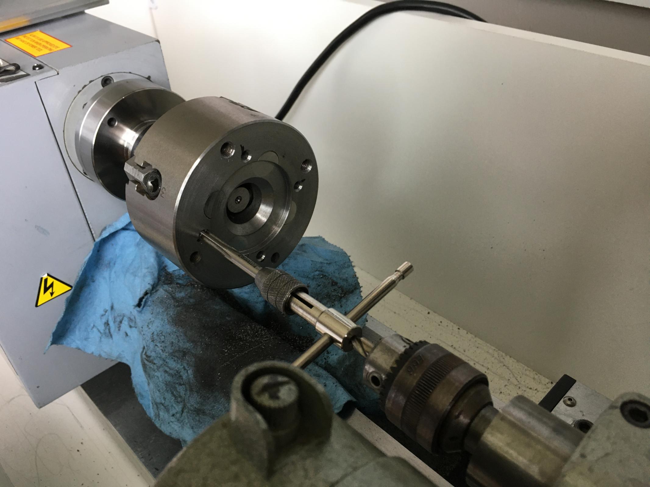

ID:	39102Mini Lathe 4” 4Jaw Modification-3a09b5d3-66f0-4ef7-89fd-819b40d648e6.jpgMini Lathe 4” 4Jaw Modification-e67c6d68-f718-430a-b370-7f6df18f9383.jpgMini Lathe 4” 4Jaw Modification-0c6c0fdb-3b2a-4bb8-9543-4e7e57a4b7ca.jpgI modified my 4” 4 jaw chuck for my mini lathe. I was able to eliminate the adapter plate and machine out the back end of the chuck to allow direct mounting of the chuck. I added four new M6 mounting studs to fit the the spindle flange 4 hole mounting pattern. The overall chuck stack up thickness was reduced from 2-3/4” to 1-7/8”. The job went very well and I encountered no difficulty. The weight was reduced from 8.5 pounds to 6 pounds.[IMG]google drive[/IMG]Attachment 39093Mini Lathe 4” 4Jaw Modification-8de015c7-64e7-4e44-8eca-1c1688f06ee2.jpgClick image for larger version.

    Nice work, getting rid of rotating mass and a good thing to be able to use all the bed length you can.
    A pic (or link to another HMT post?) of your cross slide (Unimat?) tailstock arrangement
    as glimpsed in lower right corner of your last pic would be much appreciated.
    Keep up the good work and ATB

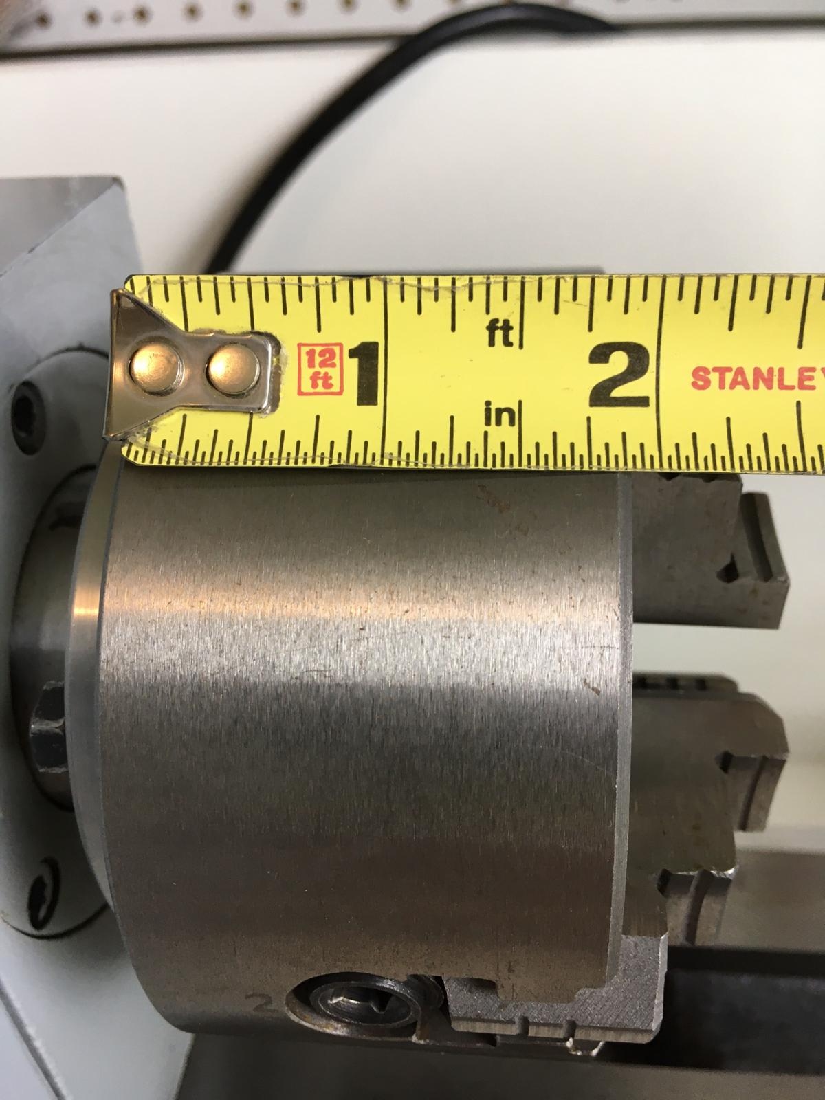

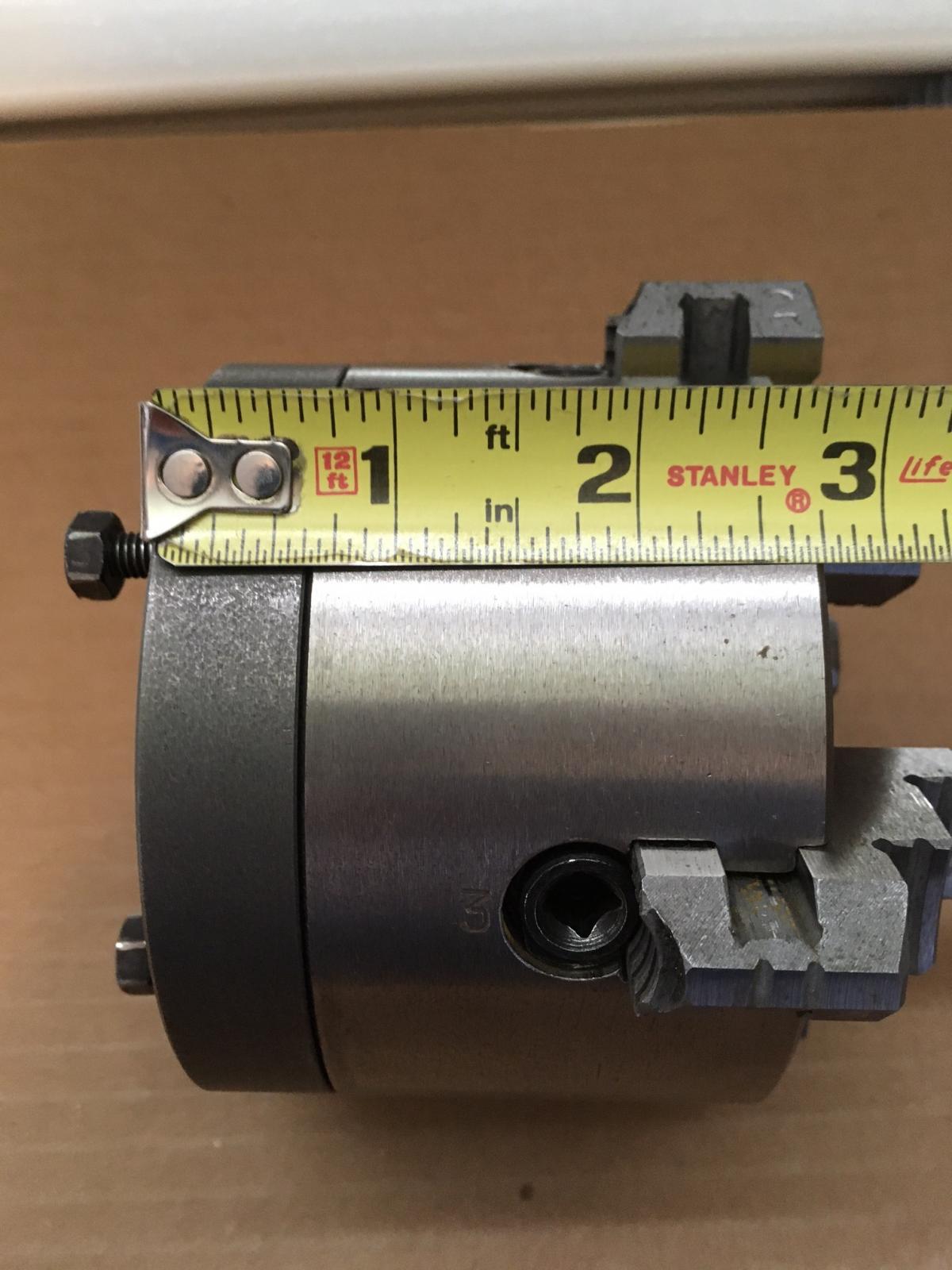

    Thanks for the help with resizing photos.

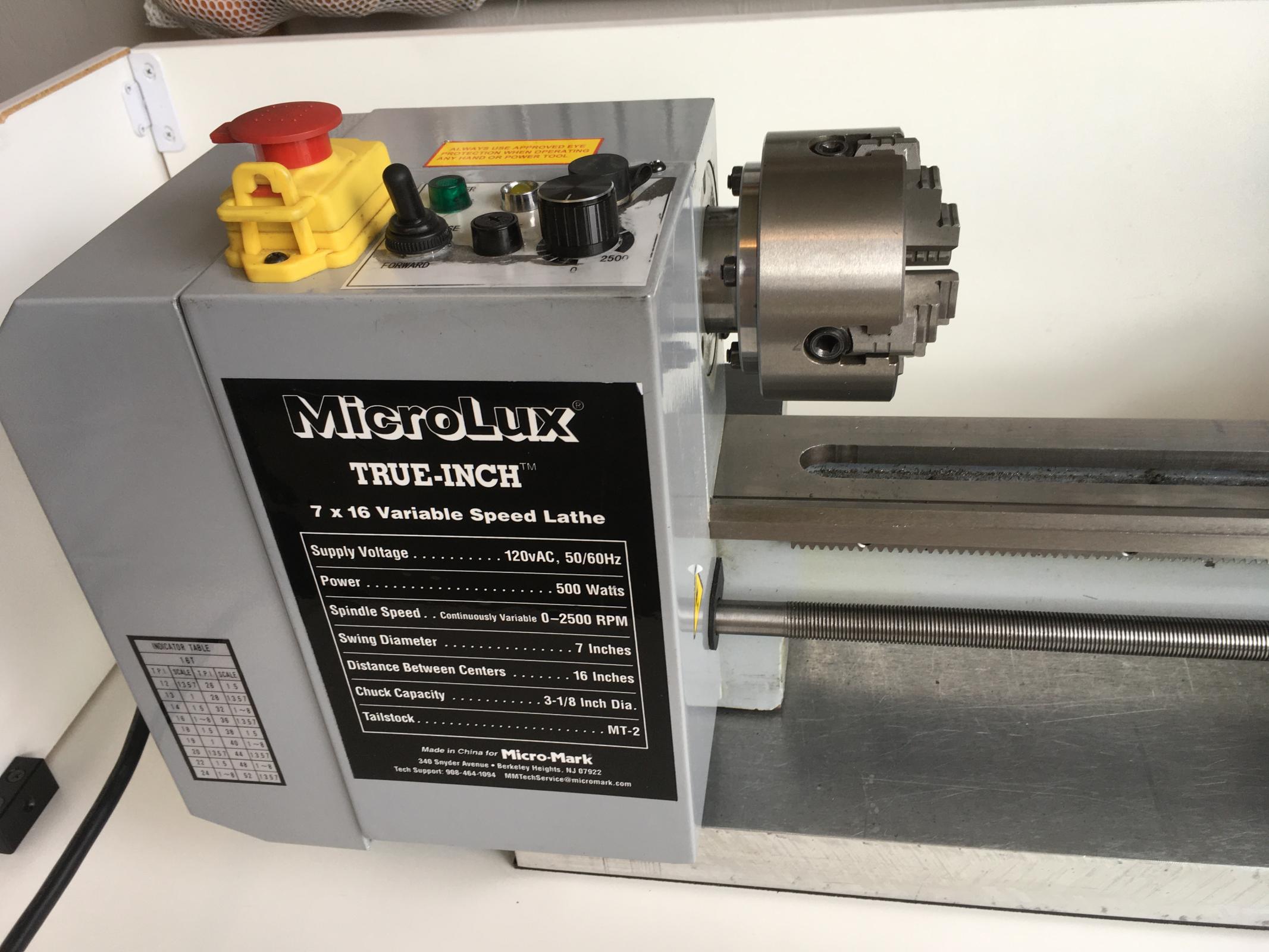

    I have attached 2 new photos. I hope this shows the before and after dimensions.
    Mini Lathe 4” 4Jaw Modification-chuck234.jpgMini Lathe 4” 4Jaw Modification-chuck1875.jpg
