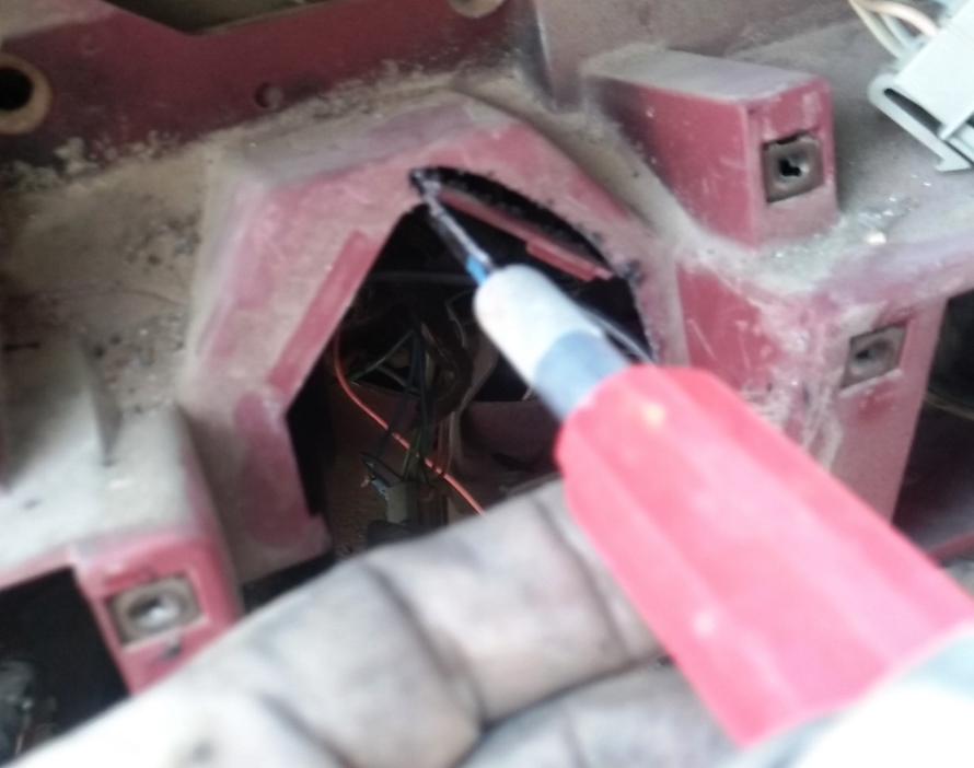

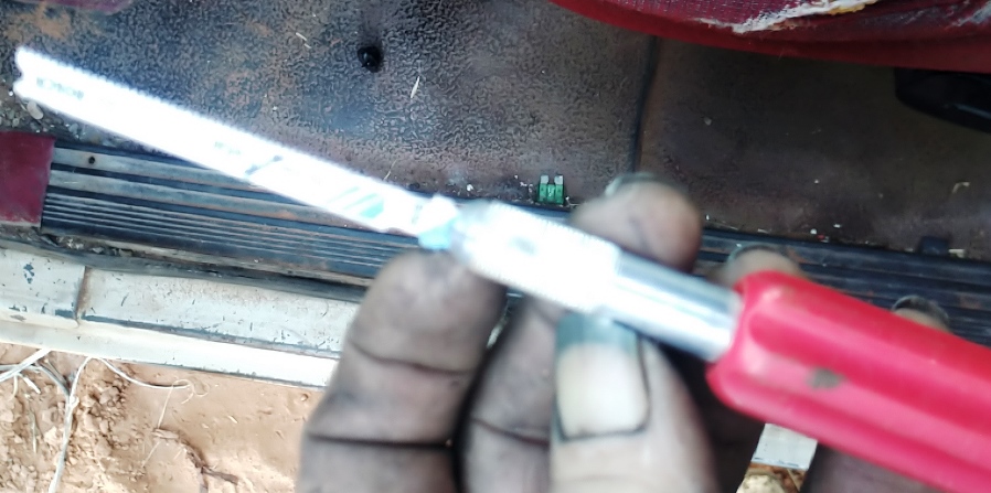

    Exacto knives in my shop are some of the handiest little tools but there are times when a knife blade is not what I need, and a saber saw or saws-all or even just a hacksaw blade in a mini handle will not do the job even a 1 1/2" circular saw blade in a die grinder is not convenient
    So what I did was to spread the collet of an exacto knife handle open enough to accept a saber saw blade
